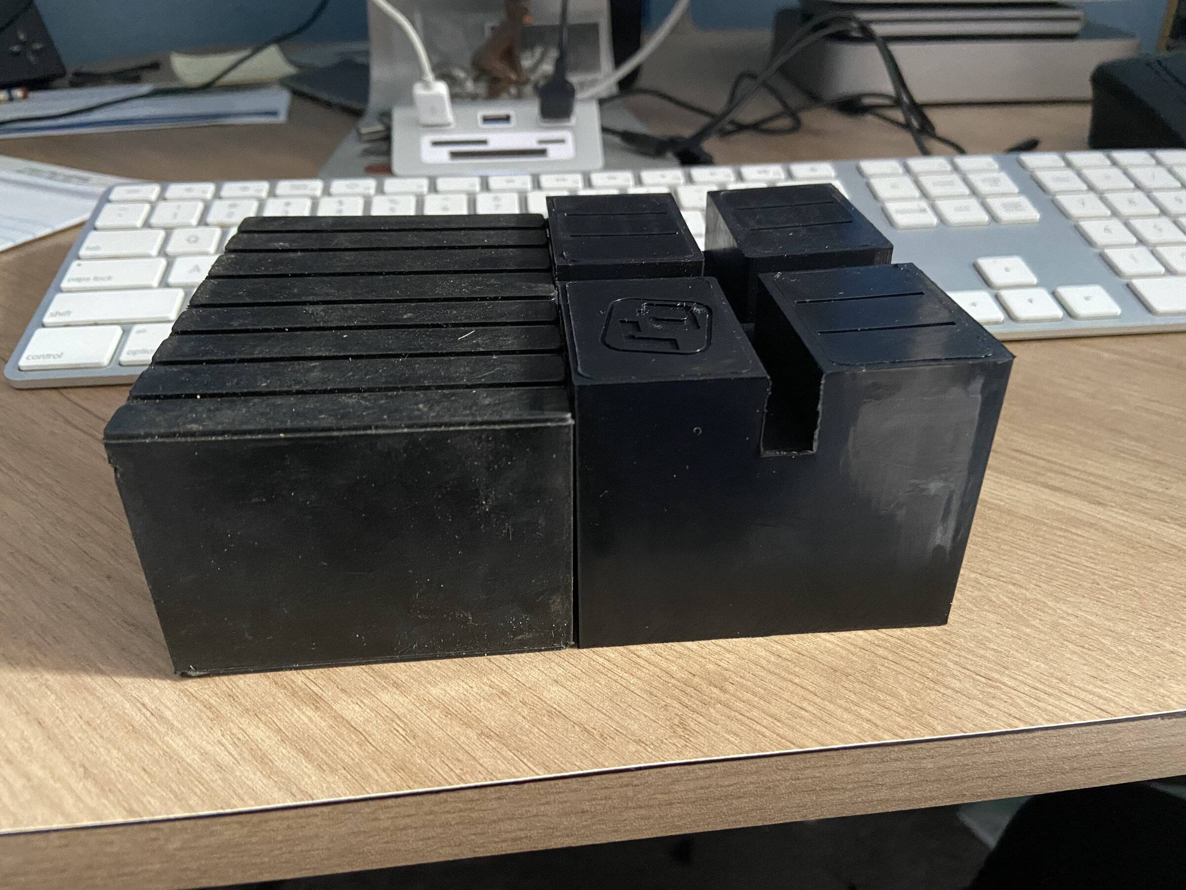

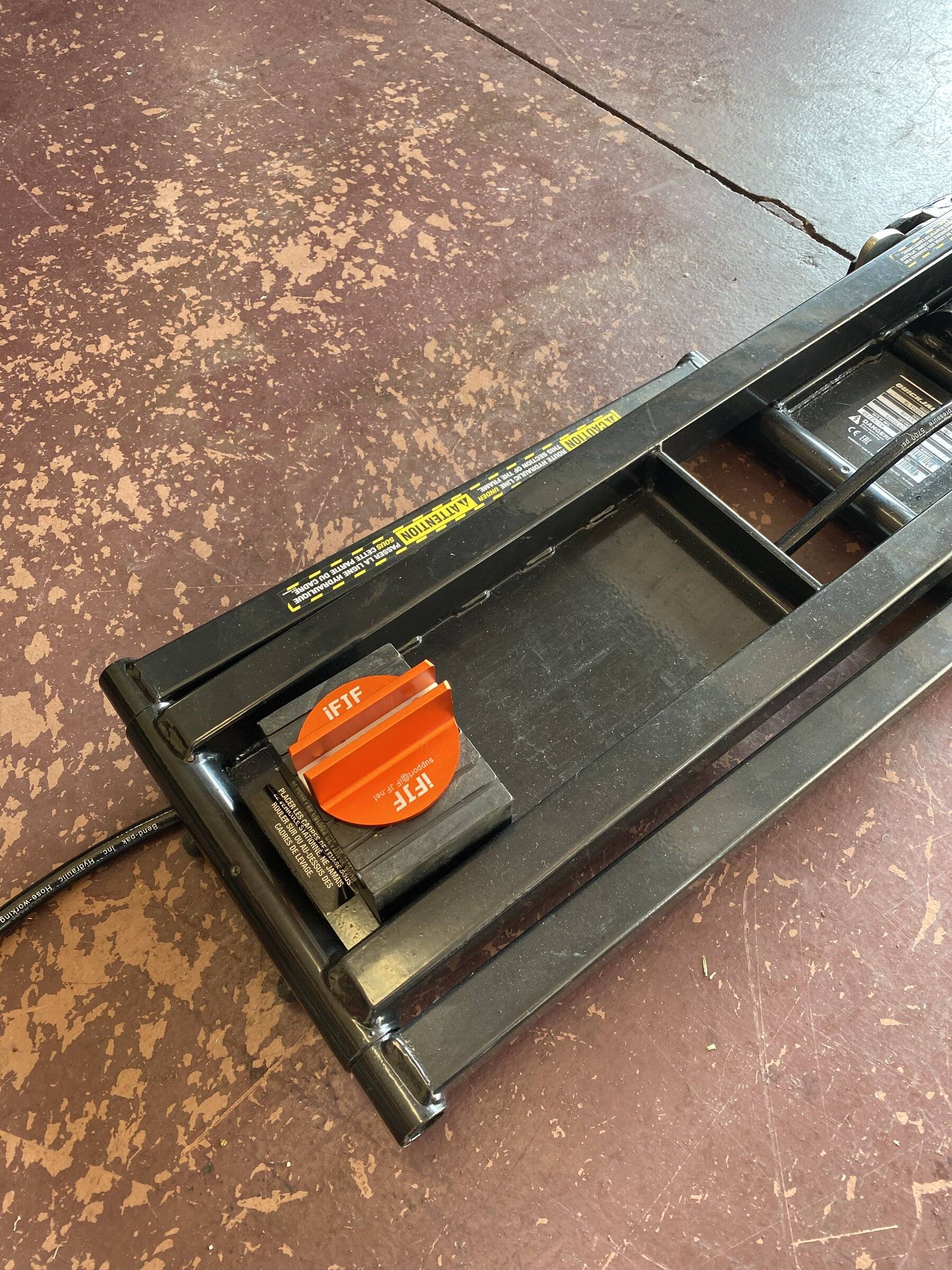

The cut blocks appear to be the same size as the blocks that ship. I have a 7xxxEXT and while you have to put them on the jack "pockets" before pushing the ramp under the vehicle, they fit fine.
I’ll have to check. Last time I thought they didn’t fit but maybe I didn’t have my jacks all the way collapsed I’m not sure. I’ll double check.

They are the same size, lift wise. It is taller because of the pinch weld relief.

Ah I see where you’re at. The pinch-weld relief cutouts reduce your overall block height.
I have Steeda jacking rails and the 3” blocks do not fit in between the rails and jack puck pockets, I have to use the 2.5” blocks.

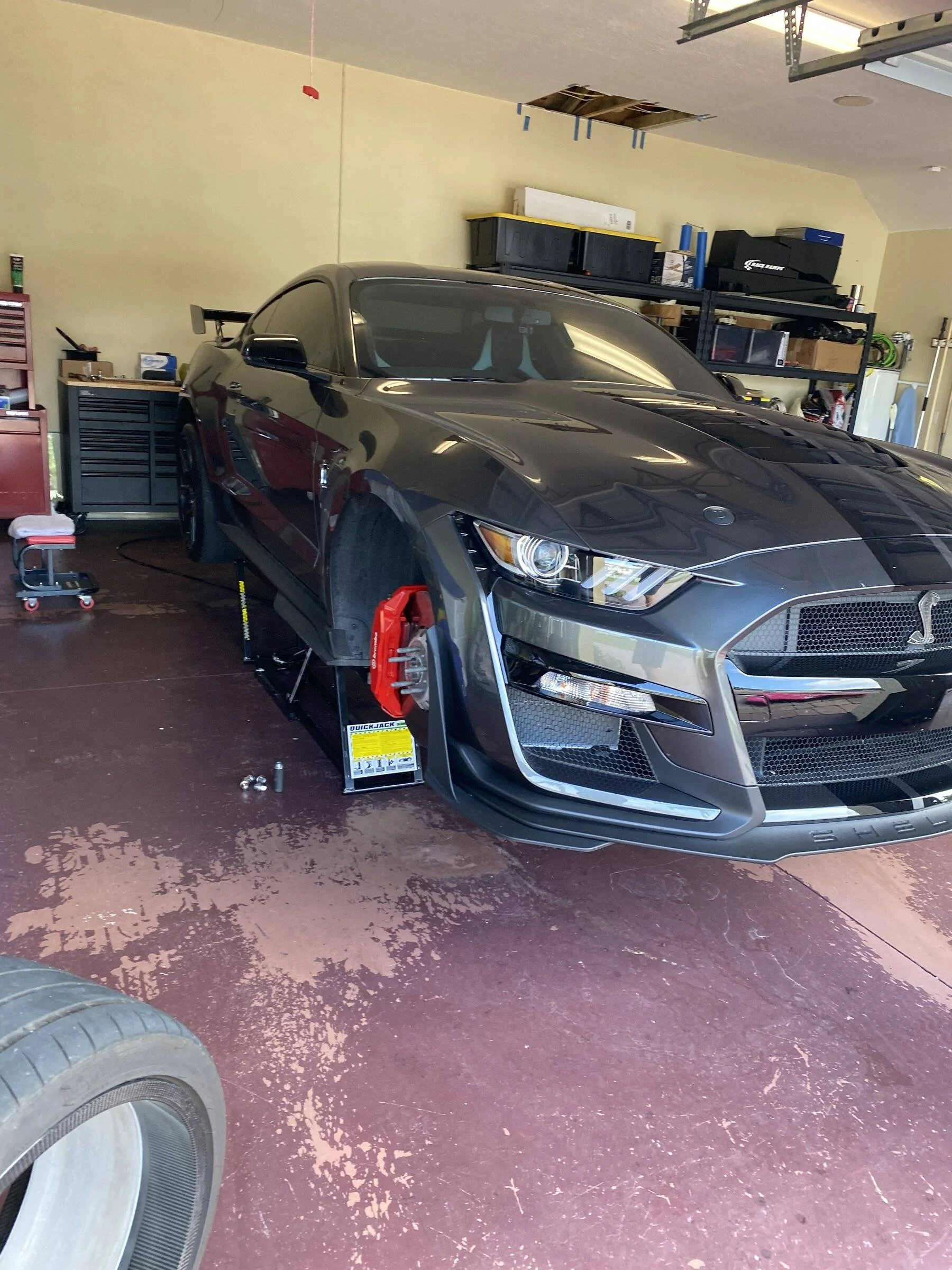

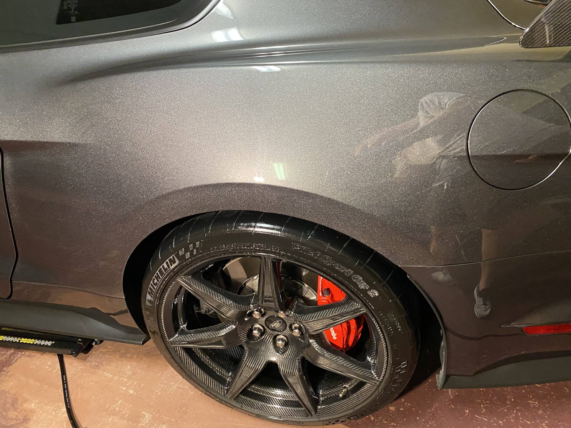

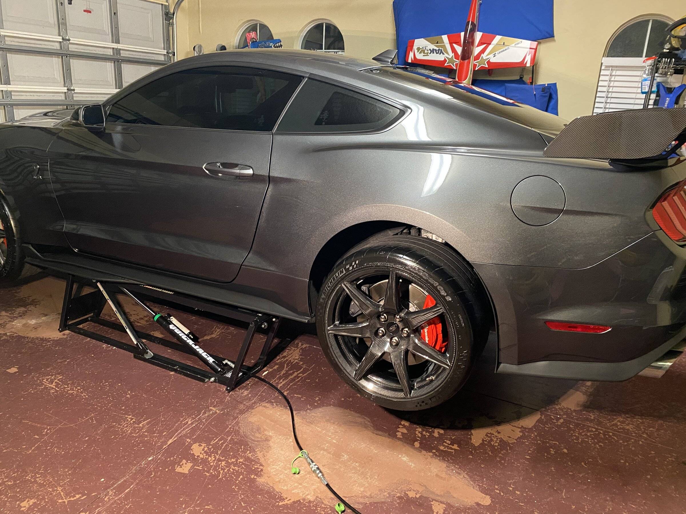

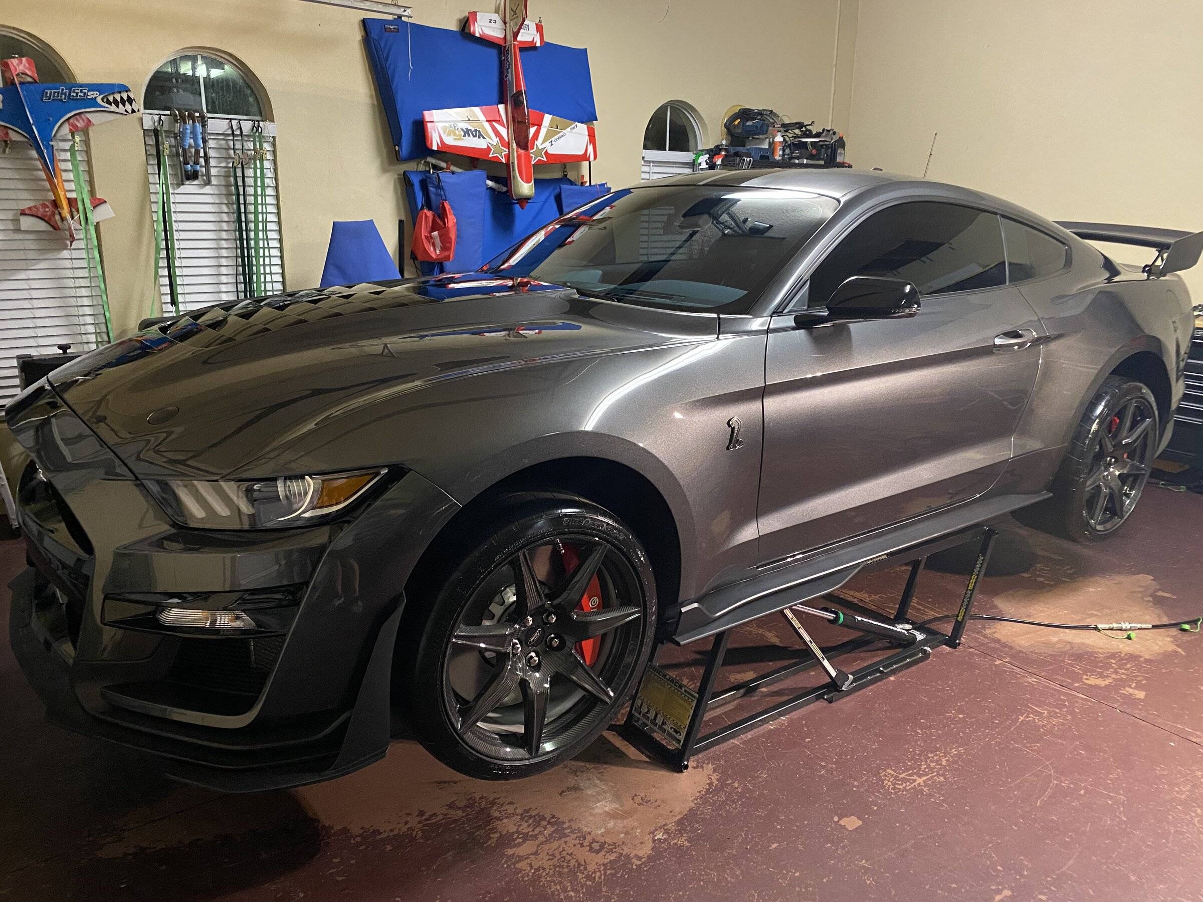

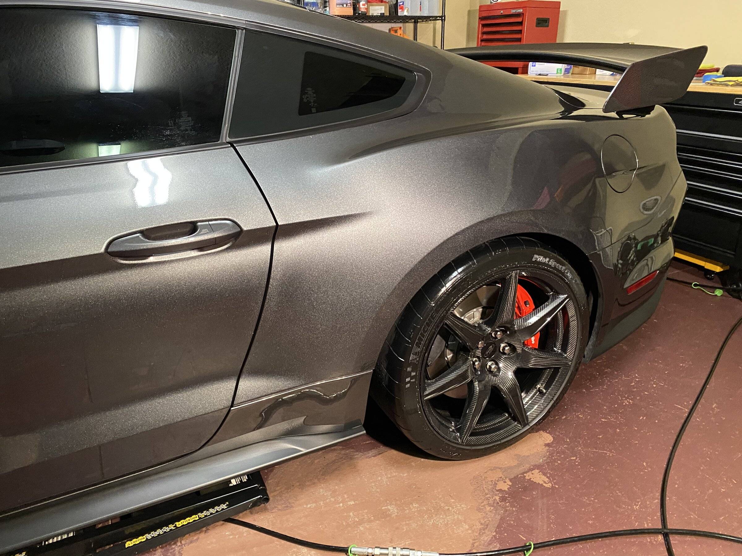

How are you centering the quick jack ? In the middle or bias forward ?
The spacing between my quick jack and the rubber block pockets are exactly end to end on the rails. So there is not any balance problems. I think I have a little longer size quick jack than what is in your pictures?
I have the 5000 SLX

I have the 7000 xl and Steeda jacking rails. I just place my blocks at each end of the rails.
Looks identical to what I see in your guys pics. I was worried the lift points were to
far forward, but I guess its good.

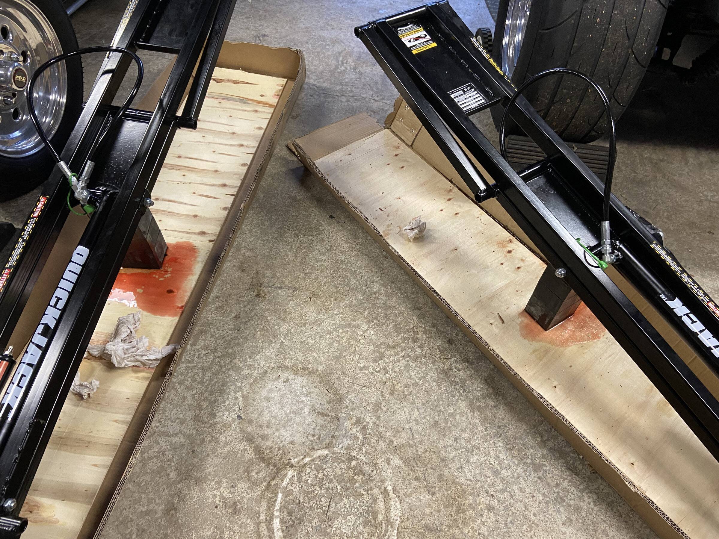

They are really handy to have, my reason for buying was did not like the thought of jacking from the sides. Have no problem with front, rear and using jack stands.
In case you get one, here is a tip for the beading, with less mess.
Leave the jacks in the box, assemble, hook up hyd line and pump. Have at it, shipping box makes a great catch try.
Much better then rags, another little one. Lowering and removing the quick disconnects.
Hold down button in for 10 additional seconds. That will bleed the line pressure. Making the quick disconnect easy to disconnect, it will fight you if not.
The newer version just out, made it worthwhile for me to sell the one purchased 5/21/21. The one above, your timing could not be better>>>>:thumbsup:
