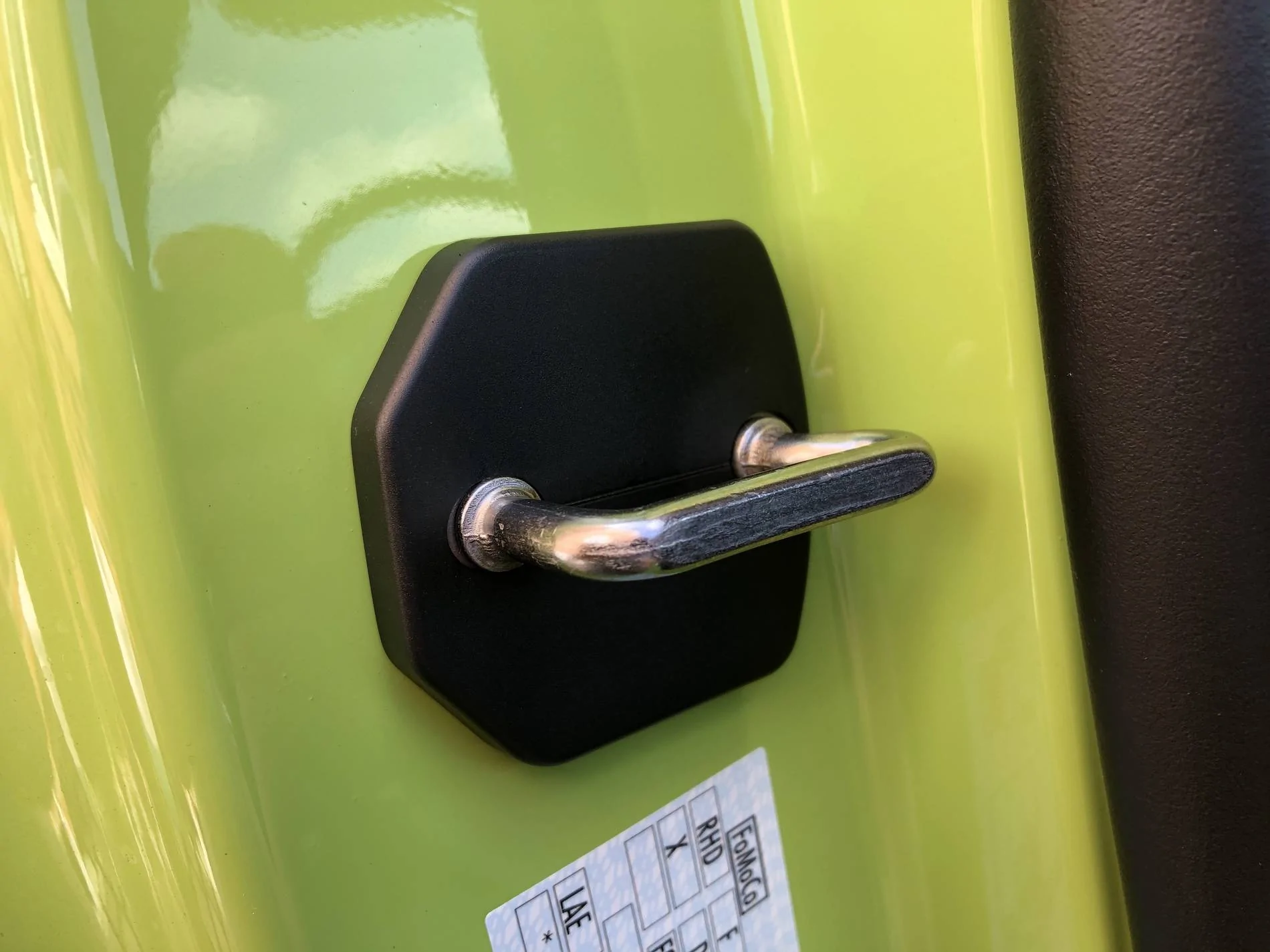

More cheap tat from eBay, the brackets were painted in super troll prior to putting them on :
Plenty cavity wax in these doors ...

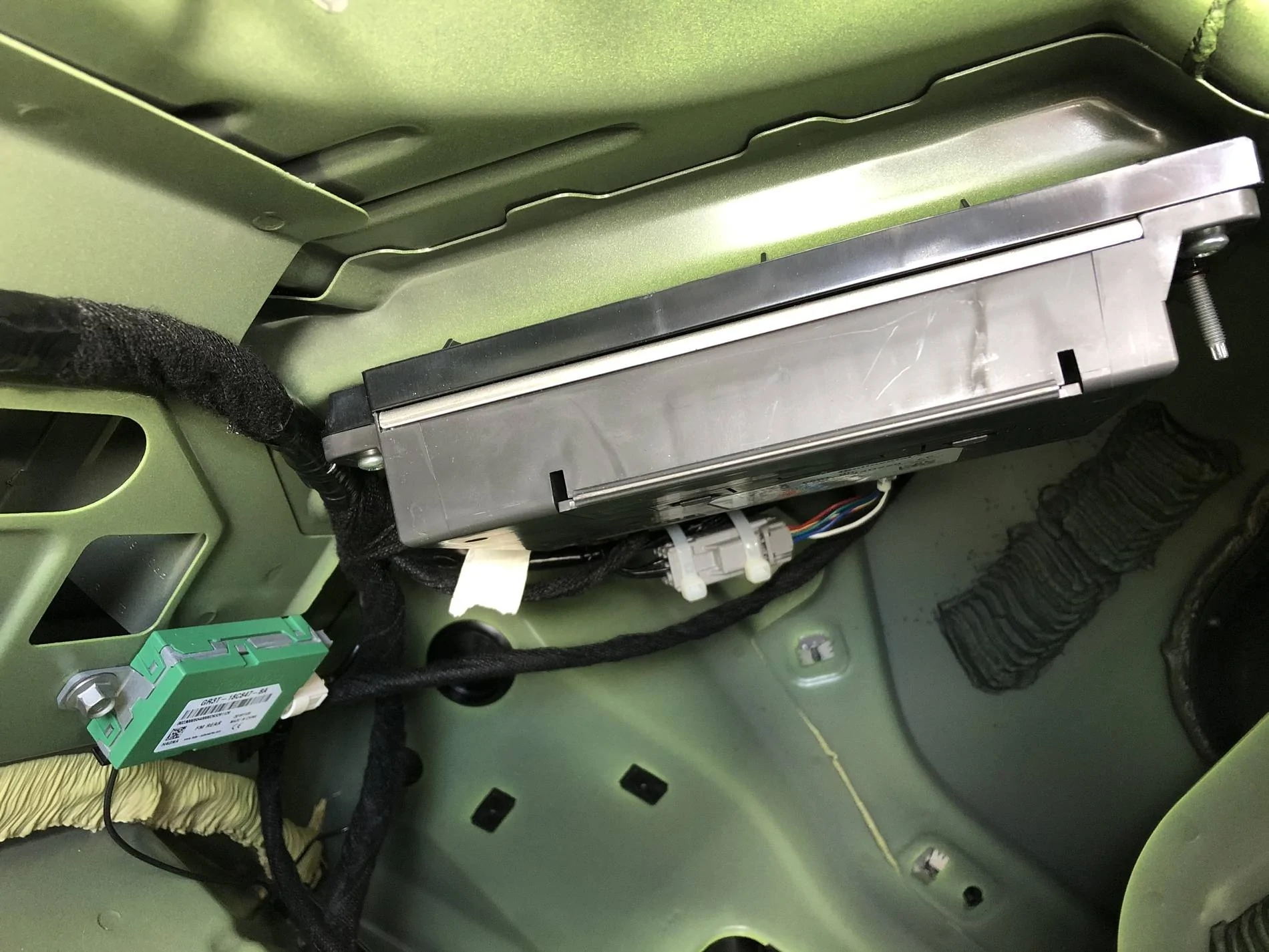

I found where they put the modem on the 2020’s :
That was whilst putting in the sequencers from exotic pony mods, you can see where I’ve secured the extra wiring plug so I don’t strain the wires. The other side was secured to the sub box mount.

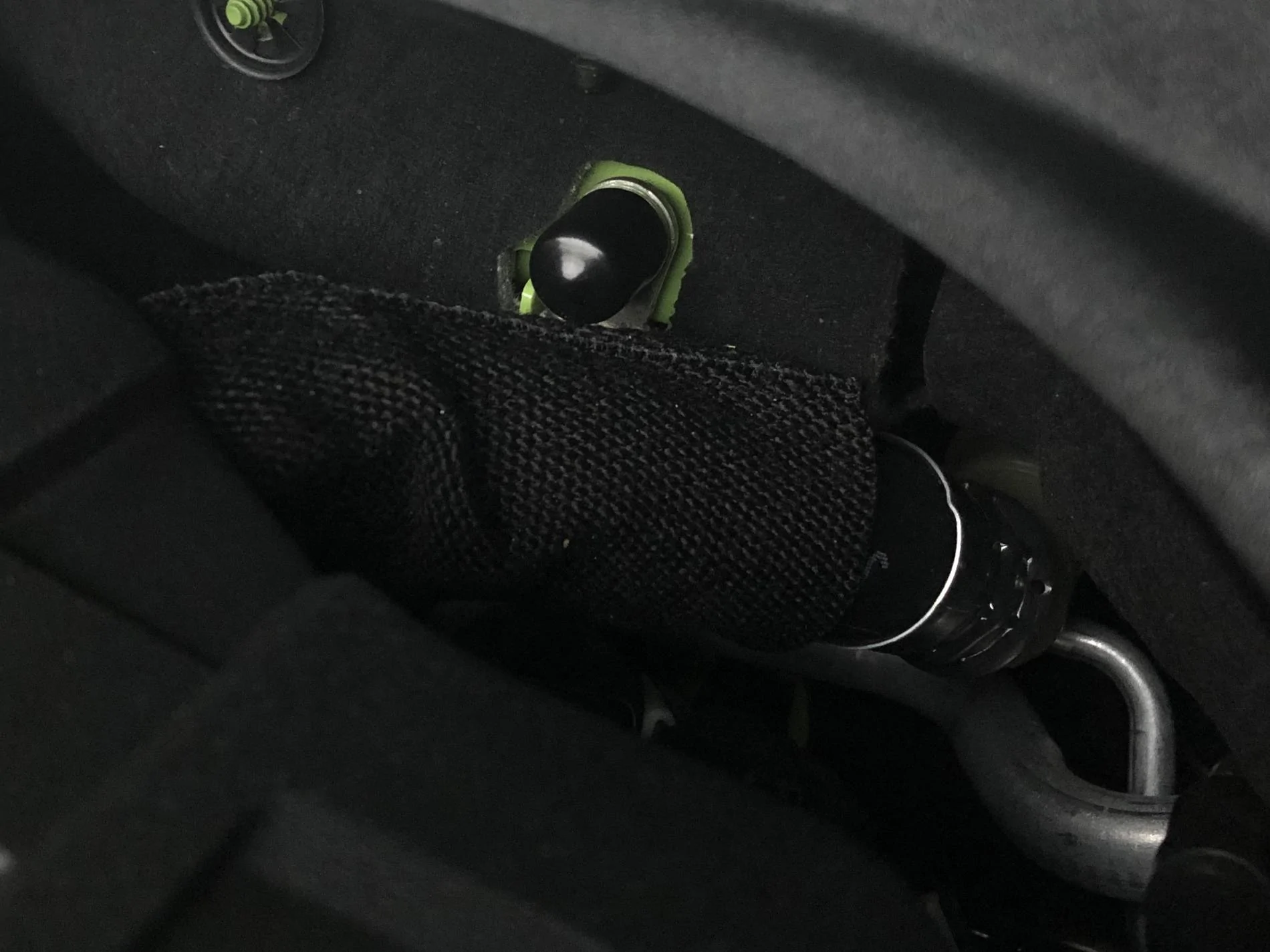

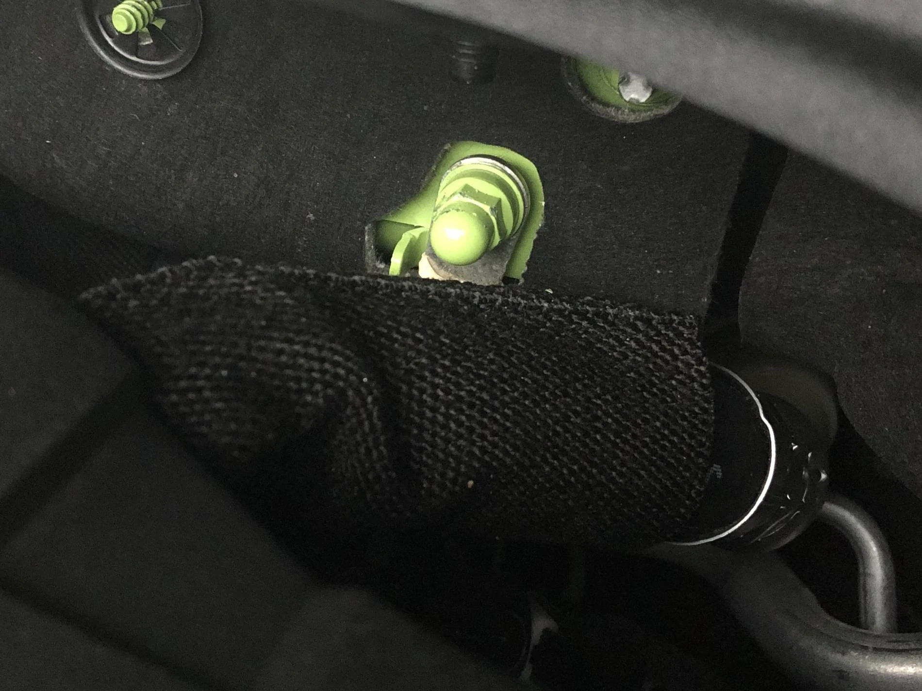

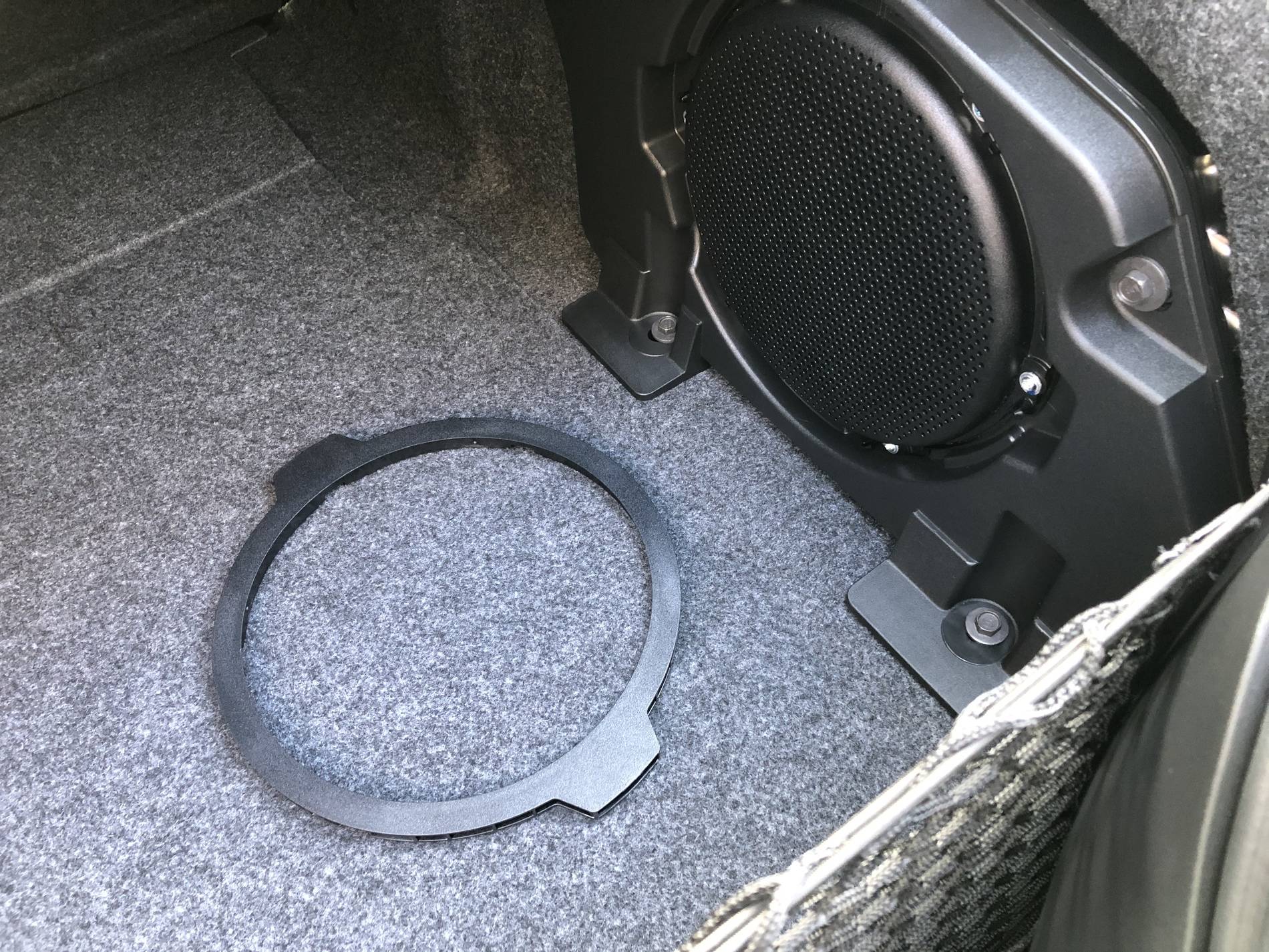

Managed to get the trim ring off the sub box without breaking it (it’s supposedly very easy to crack it and it’s not available separately). I will buy some fibre fill now as it’s recommended for the standard mustang sub :

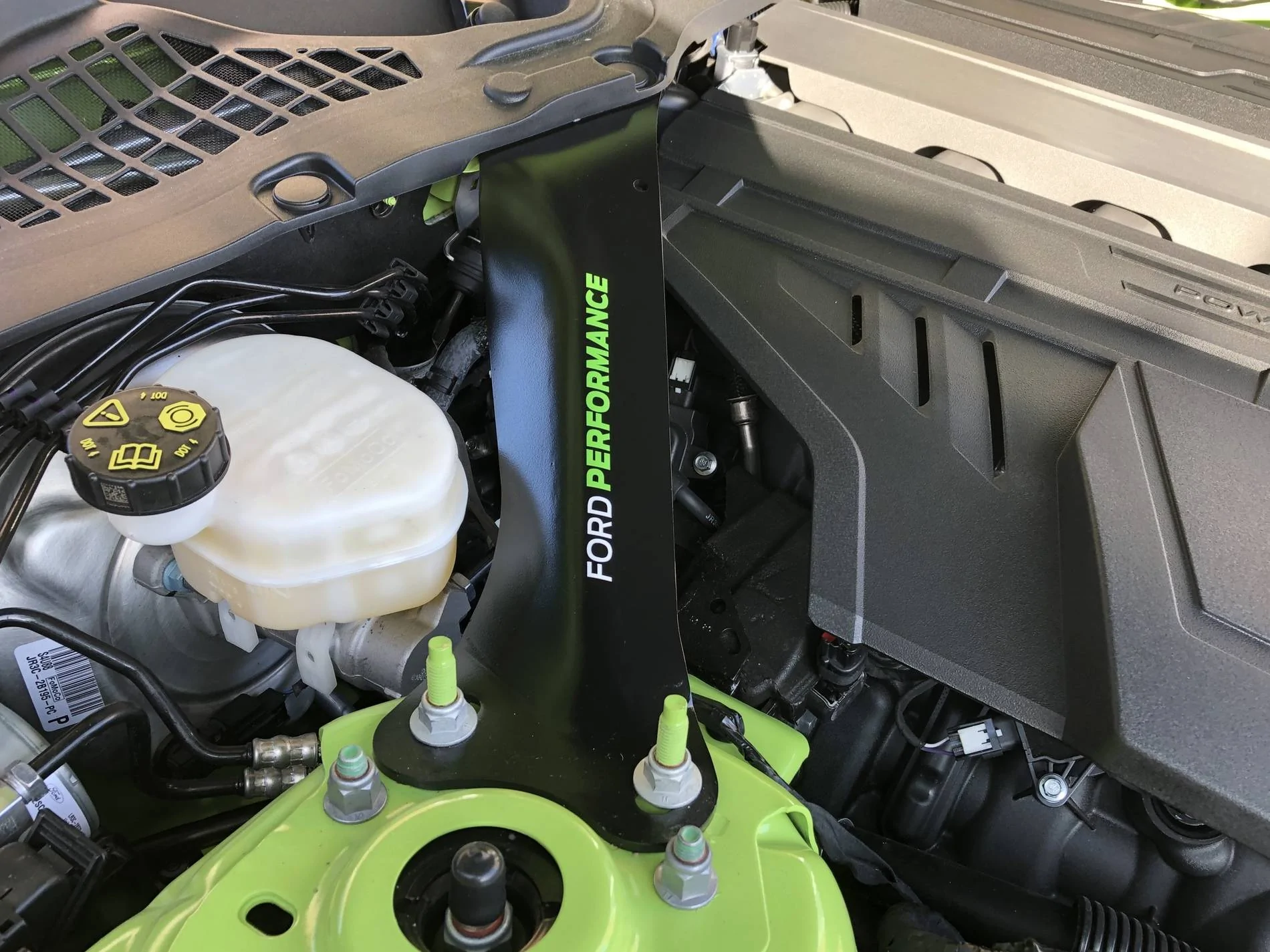

This area was looking a bit bare :
Bracket installed easily and torqued you correctly :
That’s better :

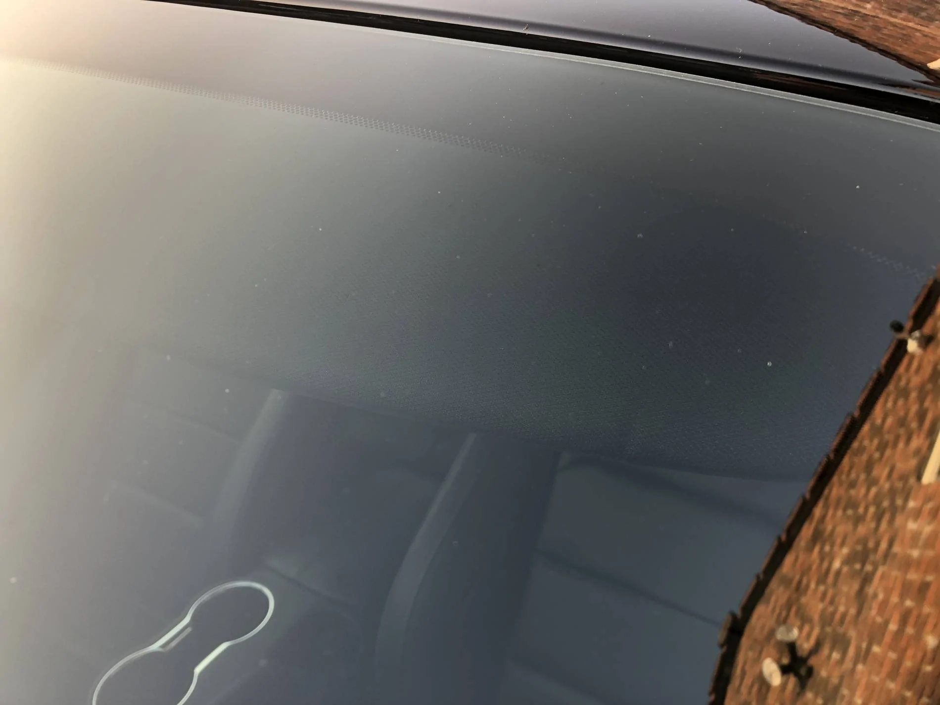

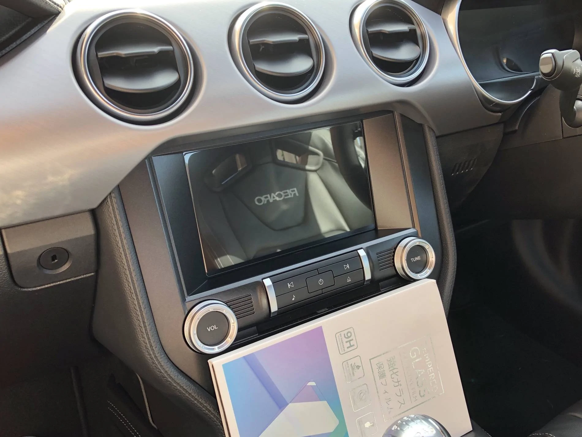

Things are going well, managed to get the screen saver on dead square and without a single bubble / flaw :

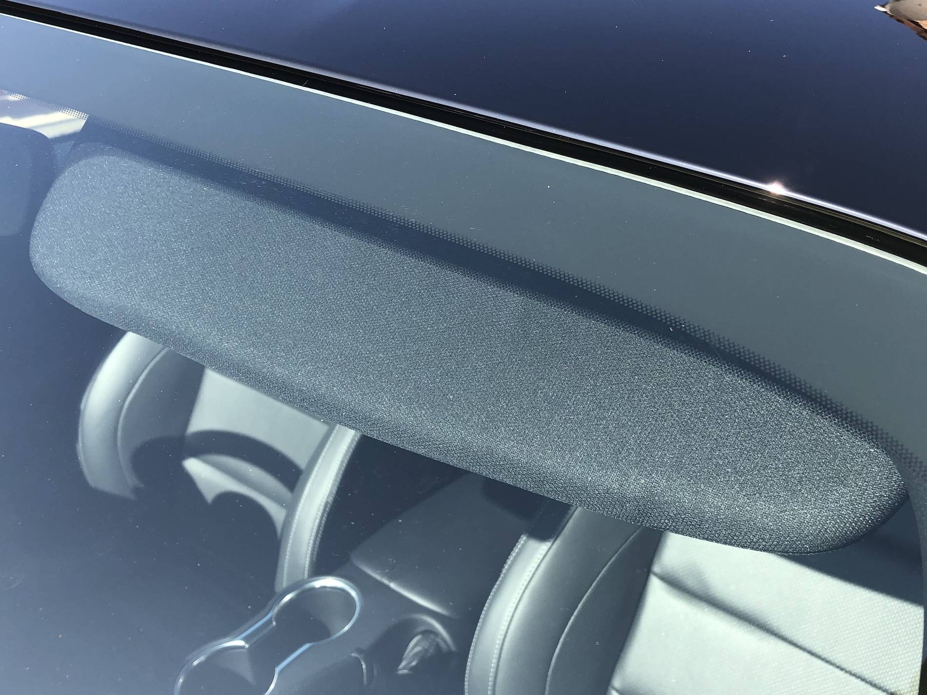

Update on the visor decal removal - I left it soaked in goo gone and went back to it a couple of times over the day with an old toothbrush and a micro fibre, it seems to be slowly fading / dissolving the shadow. Although it’s not in direct sunlight anymore it’s getting much harder to spot and I really had to work to get the camera to capture it in the second picture :

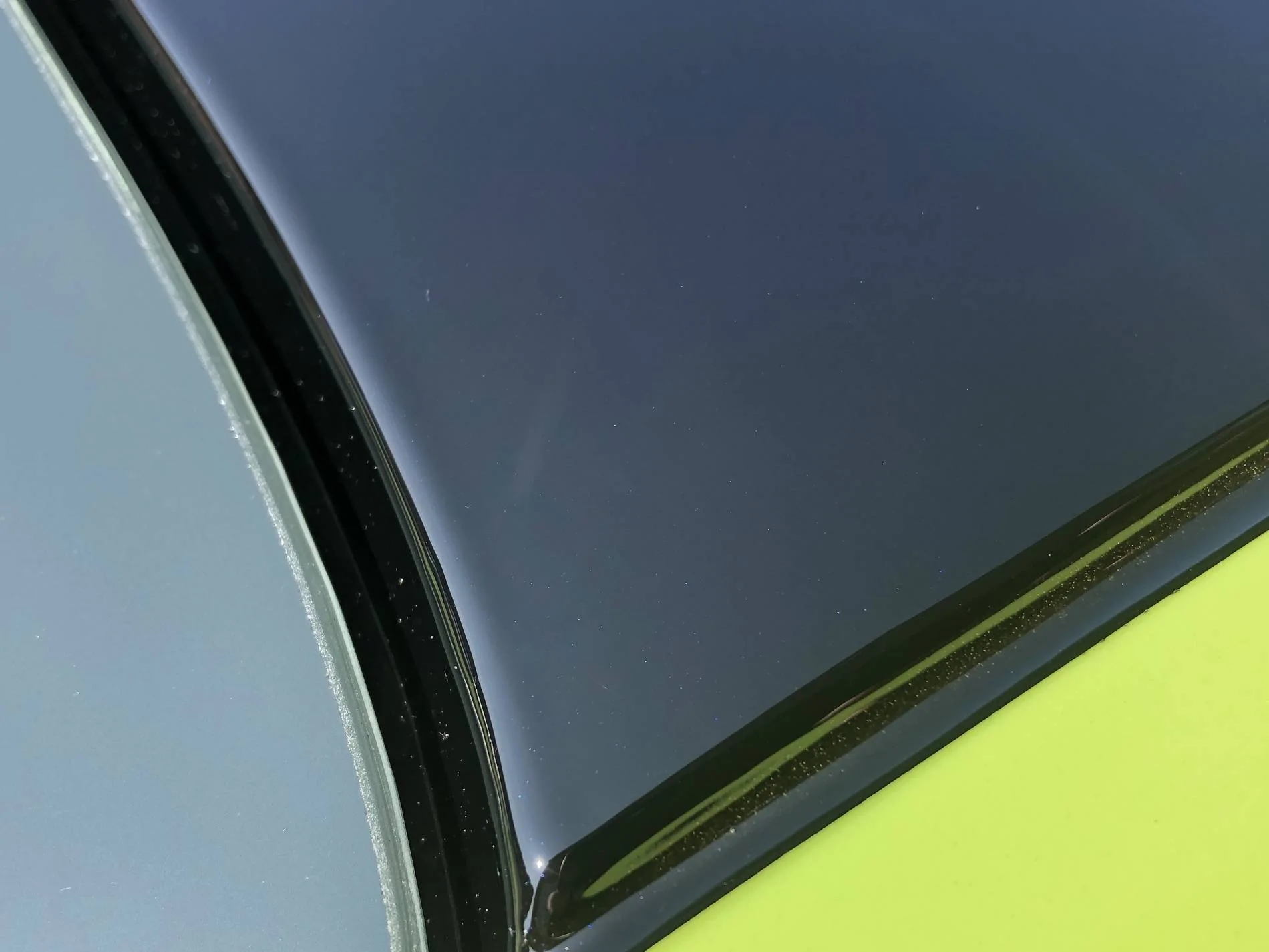

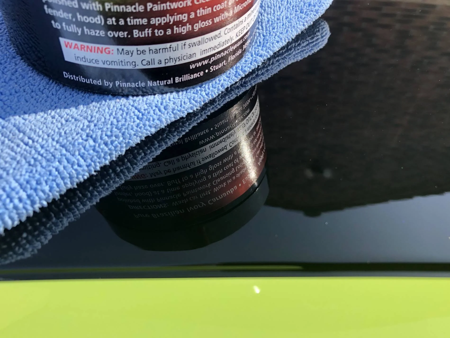

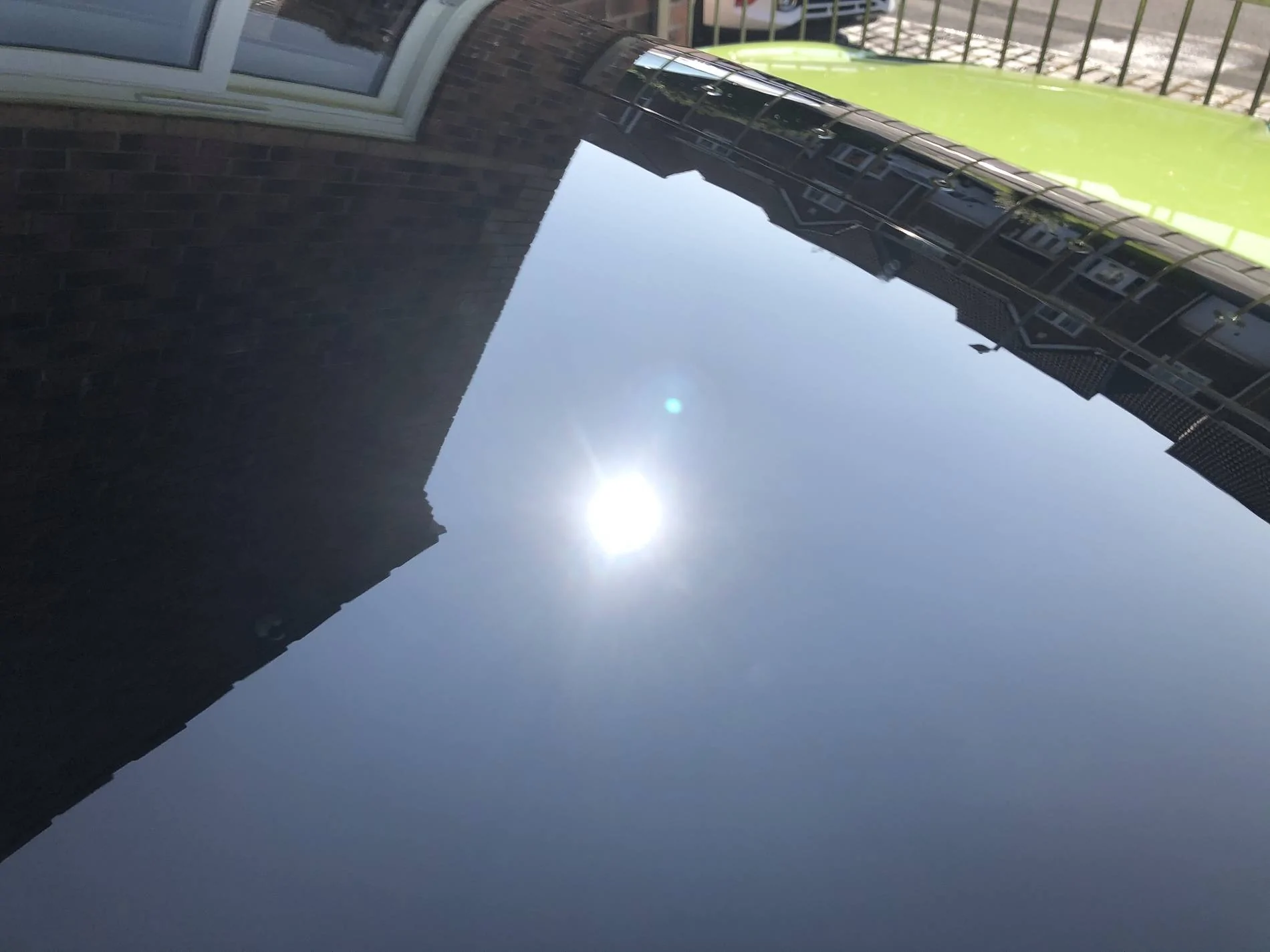

Here’s the flaw I found in the roof, directly above the reflection of the sun :
But to put that into reality ...
Whilst the suns out, here’s how the visor ended up :

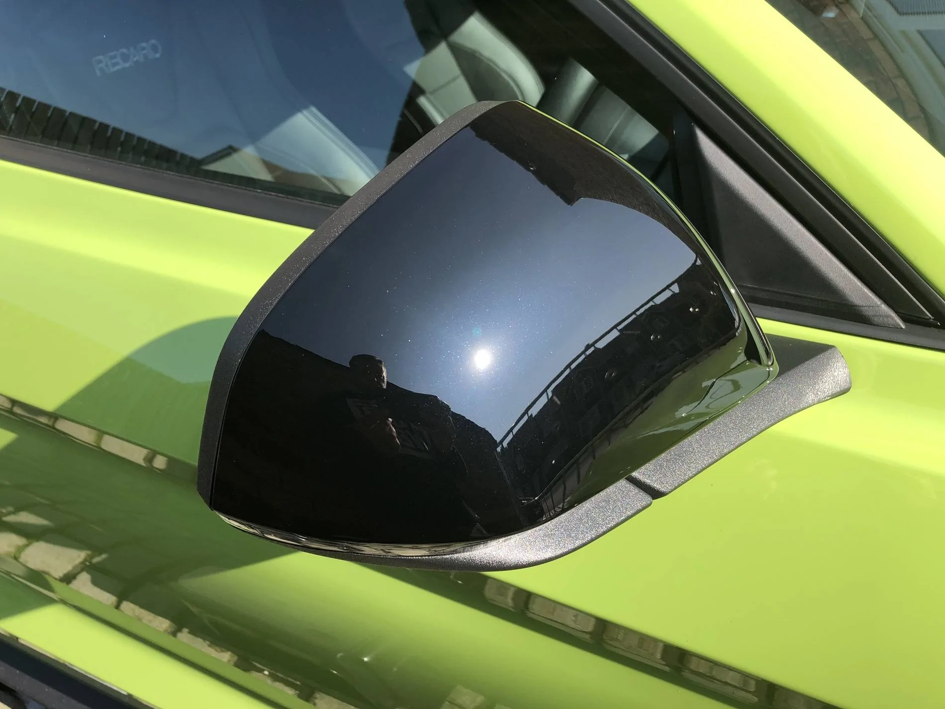

I knew the mirrors would look OK with the same wax as I had already put the time in to wet sand and hand polish them up :

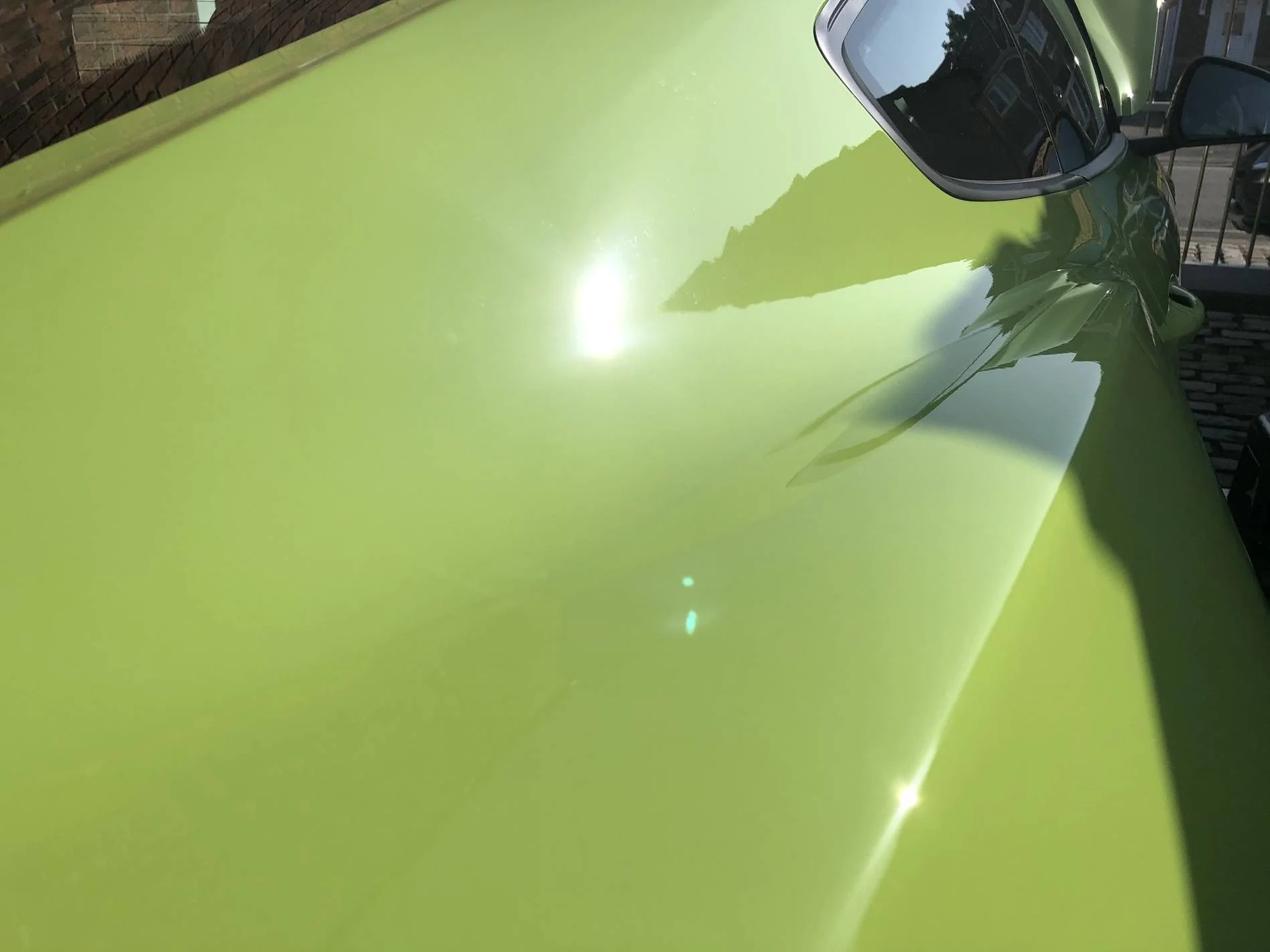

Here’s what the lime looks like (zero prep), much harder to photo but it’s in equally good condition :
Now it’s all been checked out I know I don’t need to get the DA out to get this looking good - I’m happy about that A) because of the time and B) more paint left on the car for future paint correction if it required.

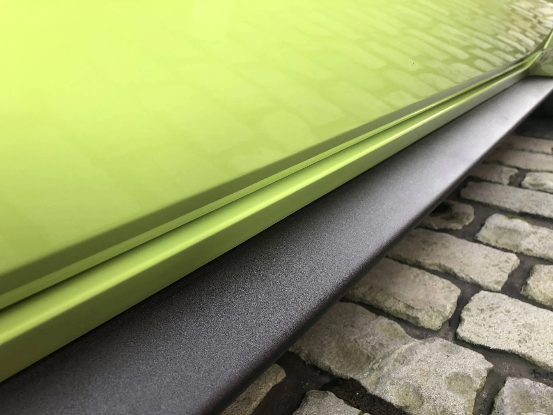

Spent some time removing the underseal overspray, it was worse near the back of the car, on the lower edges and particularly on the return lips :

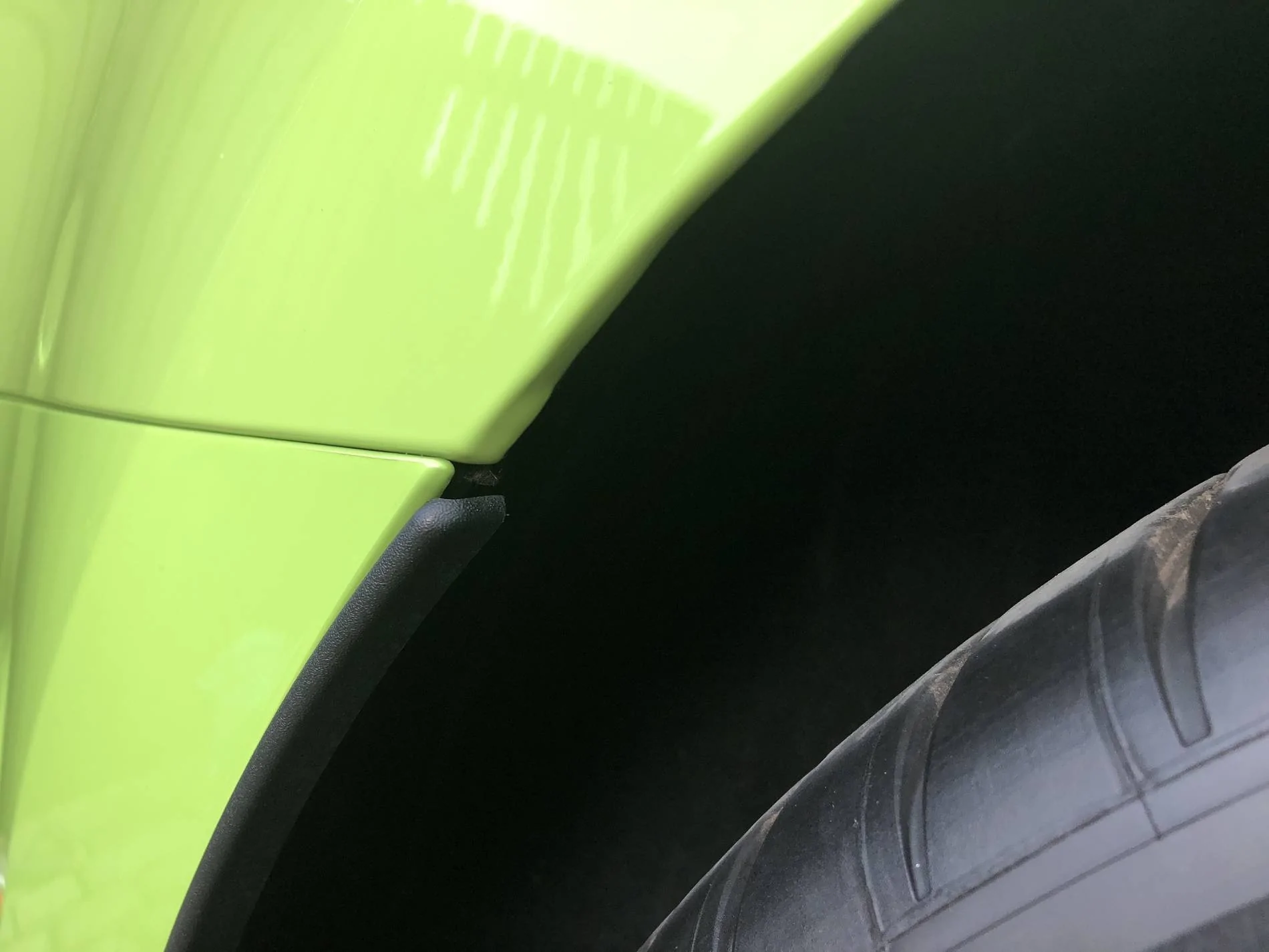

This lip had a flaw, but it sanded out with only a slight trace (about 15mm up from the tape) :
Bottoms prepped, 303 on the sills after removing the dried cavity wax :

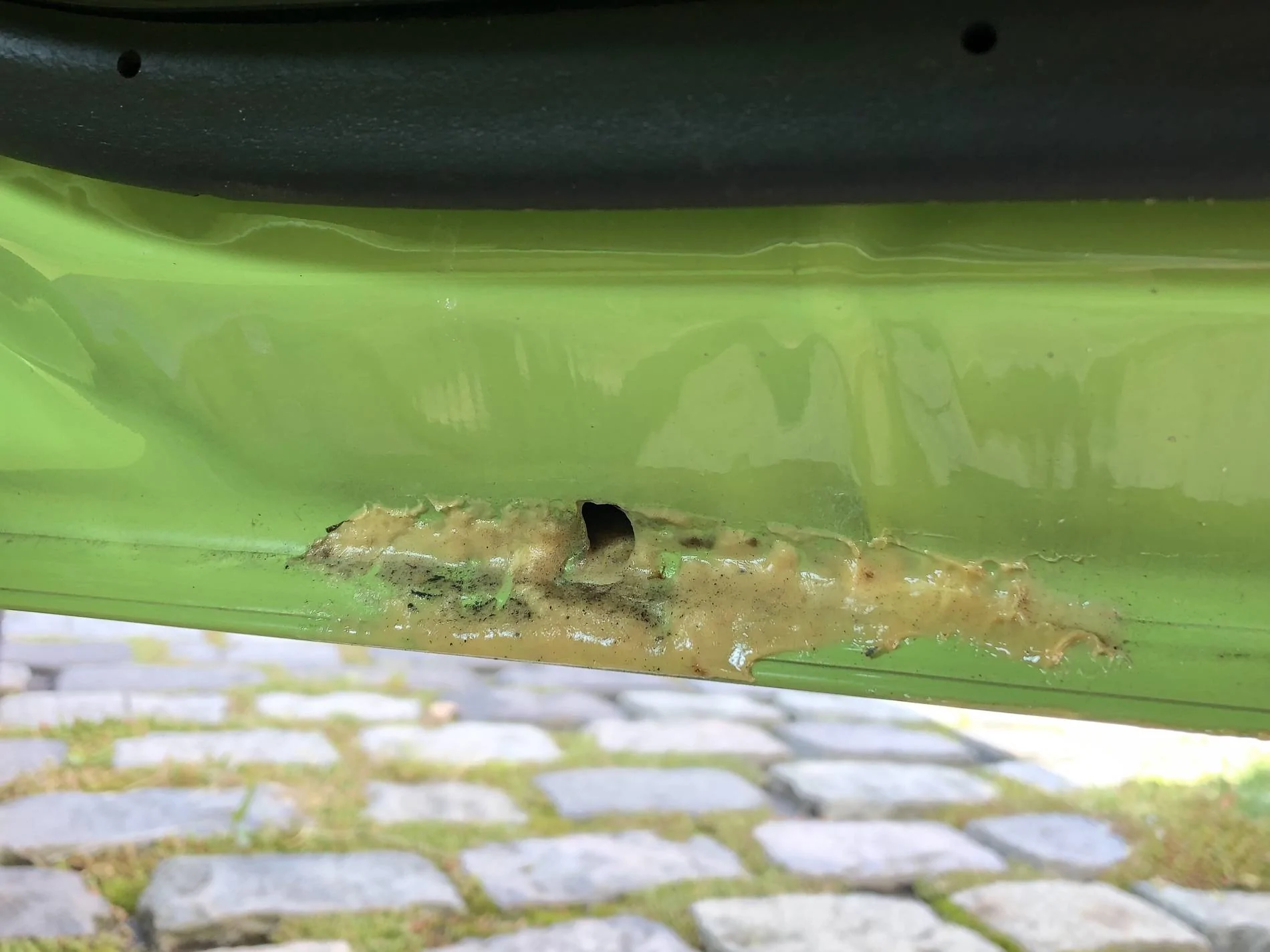

As this is a build thread and not an Instagram thread, here’s a bad bit I found under the left door :
But in reality it’s hidden, even when kneeling down :
I don’t want to tackle fixing this as I suspect it’s one of those jobs that could go wrong, I’m simply going to seal it up with a bit of touch up.

I’m enjoying this thread a lot.
Does the wool in the sub make any noticeable difference ? If so do you have any details on what to use and how much etc

@Alfa Male
I had picked up the fibre wading trick from reading on here, it seems to be a favourable option for the mustang sub box.
It’s cheap to do, £9 for a 12 oz bag from amazon and you need about 8 oz for the mustang box. I’m sure using the stuffing from an old pillow would also do.
It was only something that was an idea rather than part of my plan, but once the box was out to do the sequencers, the challenge of the B&O trim ring removal got the better of me … (I think the shaker trim ring is much easier to remove). Once the trim ring came off amazon prime came to the rescue for the fibre (I used brand ‘Poly-fil’).
I’m probably not the best reference for how much it helps / changes the sound, remember that the car is new for me and I’m still messing around with stereo setting etc. No one has ever said anything bad about the mod though so I guessed I had nothing to lose :like:

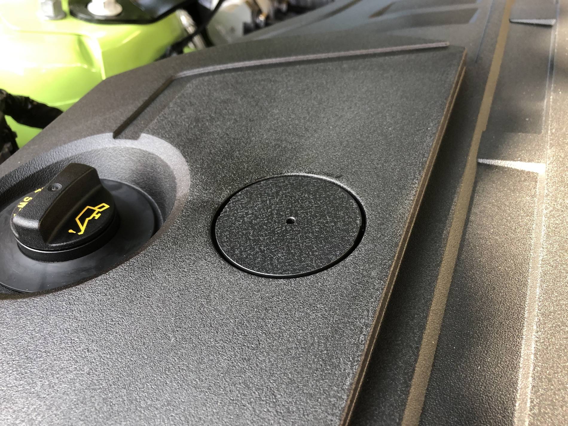

Not much to report, the little cap turned up to hide the rather scabby nut on the bulkhead :
I spotted that on the initial pdi and it bugged me, looks like it’s been adjusted or had something added after initial assembly ? Anyhow, looks better now and matches the ford supplied caps on the top of the struts :

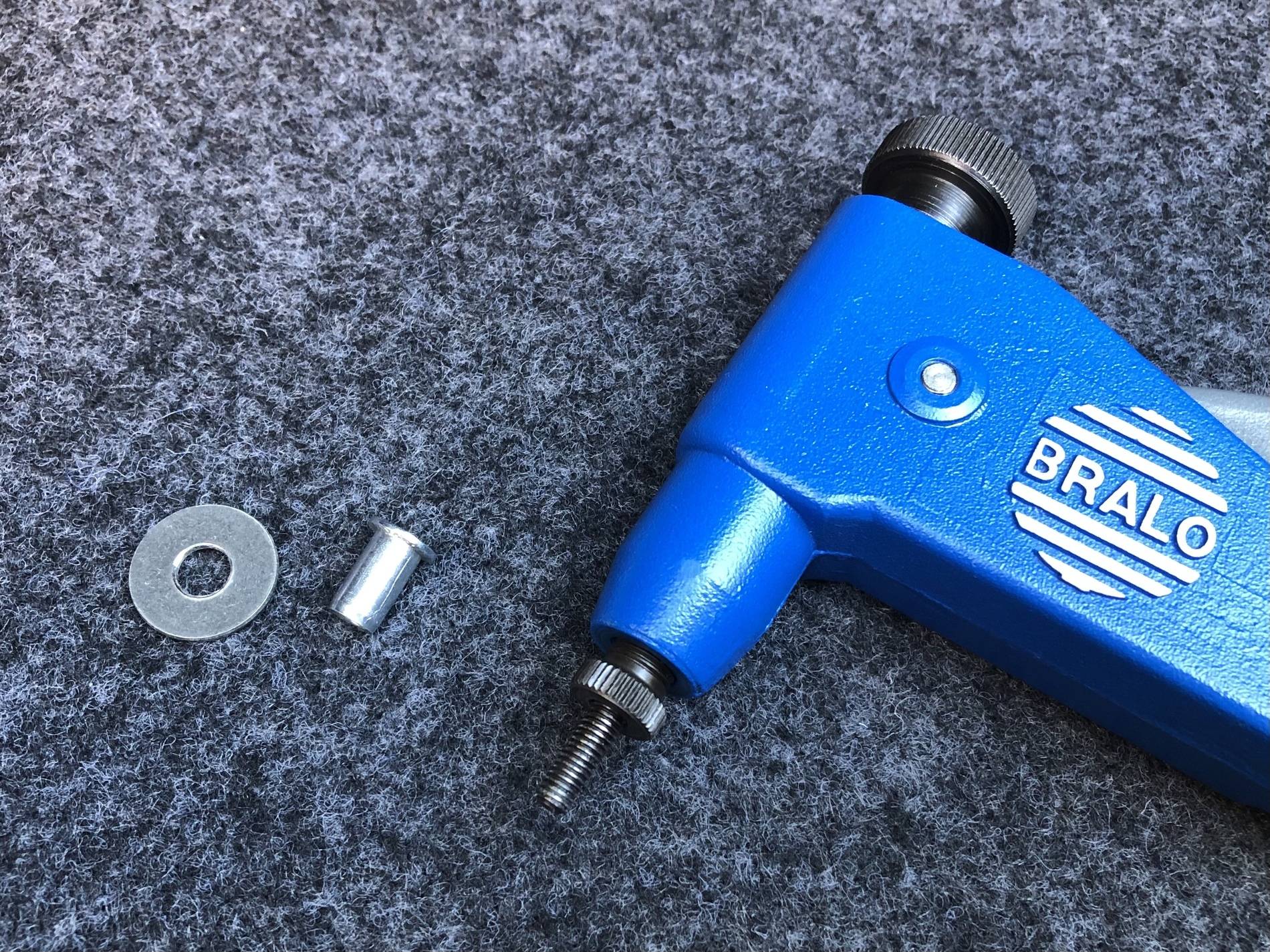

Done the legwork for easy fitting of a boot pull.

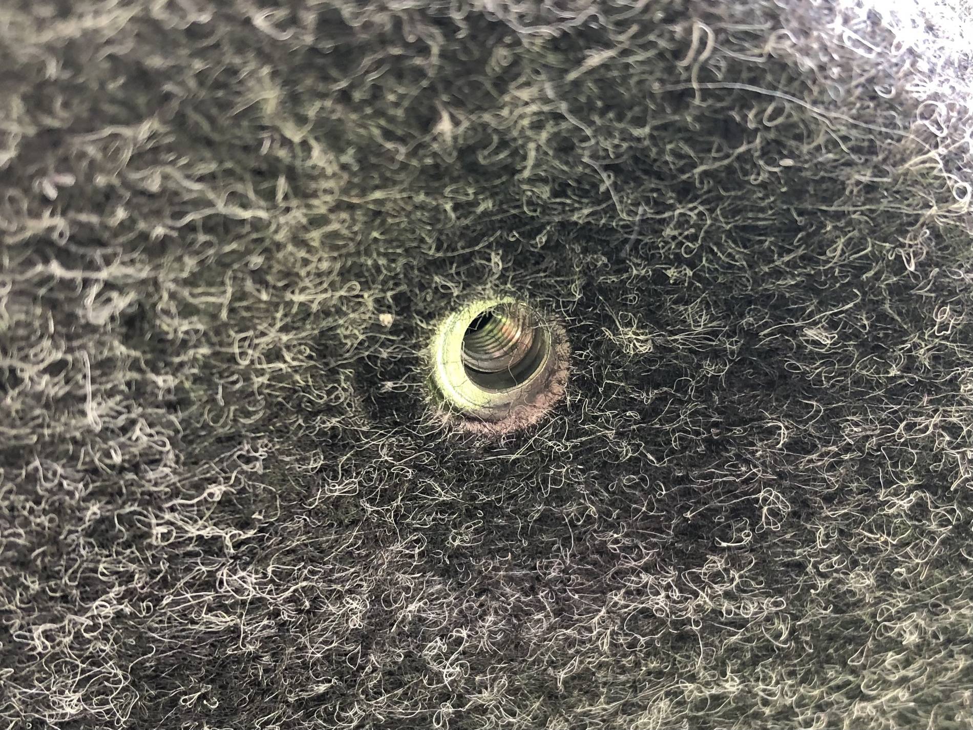

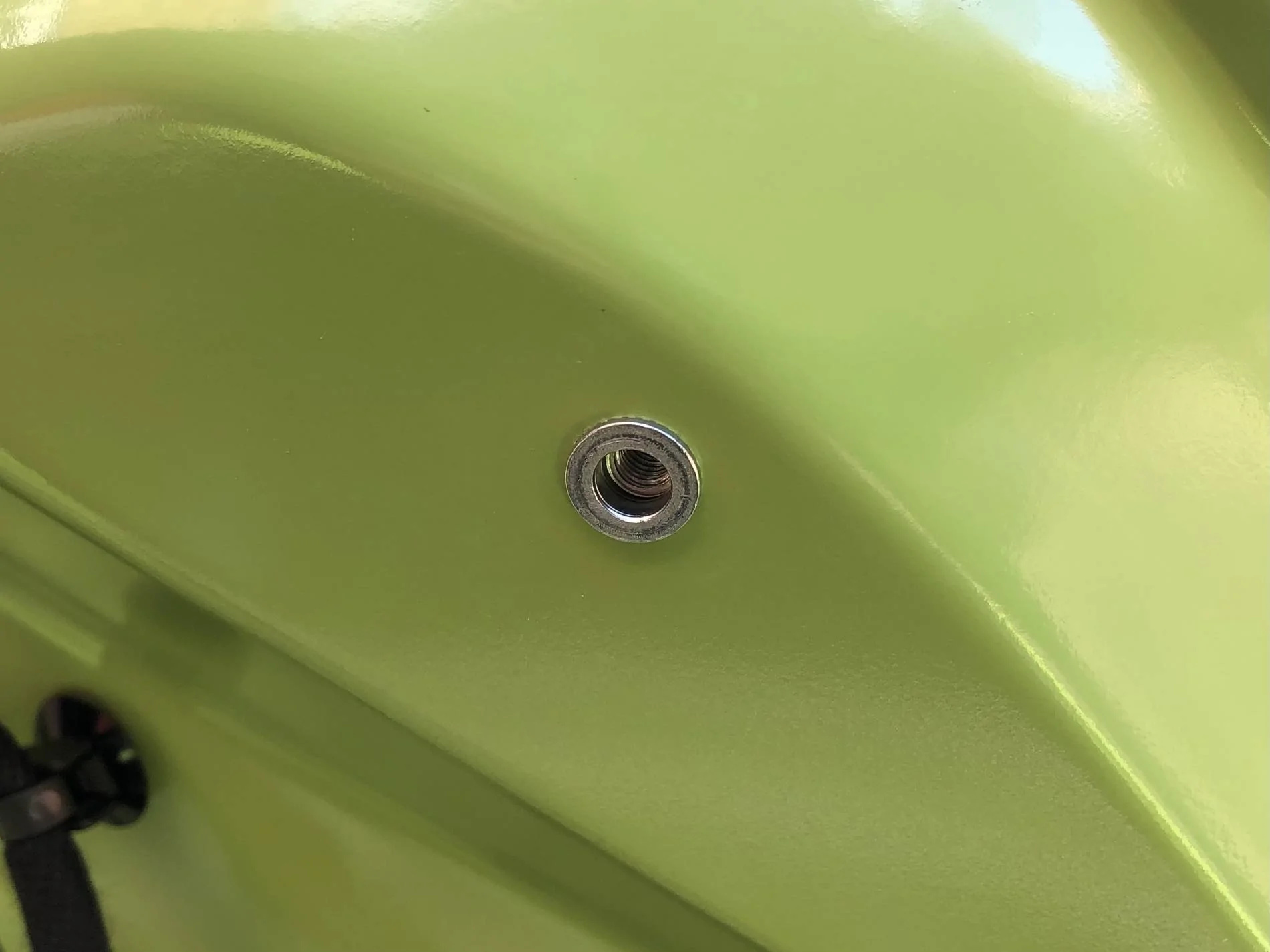

Boot trim off, rivnut (threaded insert) and a stainless washer for the back. The strings so I can get them to mate without loosing the washer inside the boot :
For anyone that doesn’t know what a rivnut setting tool looks like :
Fitted with a bit of red loctite under the head of the rivnut :
Replaces the push pins :
For anyone that’s interested, an M5 rivnut fits the factory push pin holes perfectly. The washer was an M6 repair washer drilled out to 8mm to provide a snug fit on the rivnut :like:

Did you just peel the stickers off the visors or did you do something special to get them off? Definitely doing this on mine.
