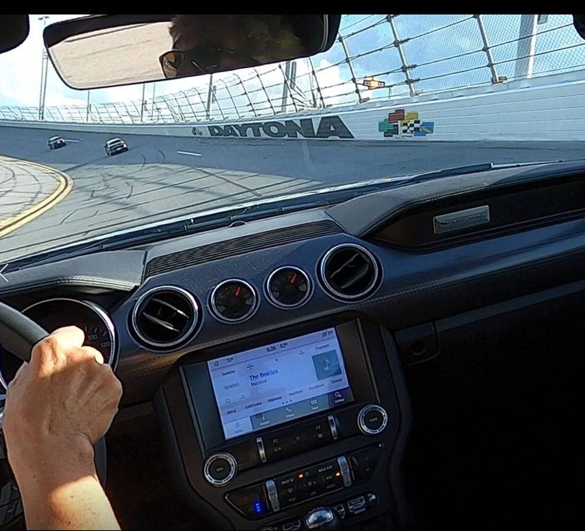

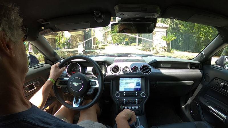

Finally got a day to test my GoPro setup. As Norm noted, the exposure setting makes the outside too bright so I will use the spot meter set for the windshield area. The wide view is too wide, linear or narrow would be better. The mount is good, no shaking or vibration at all and the viewpoint is right where I wanted it

I like that view. It's a little wide, like you say, but it's not bad. If that's in 1080 mode, try it in 720. This doesn't change pixel density, just the total number of pixels. It does this by shrinking the size of the window.
I always like having the driver's hands in view. Without, it's really tough to determine anything about the handling of the car.

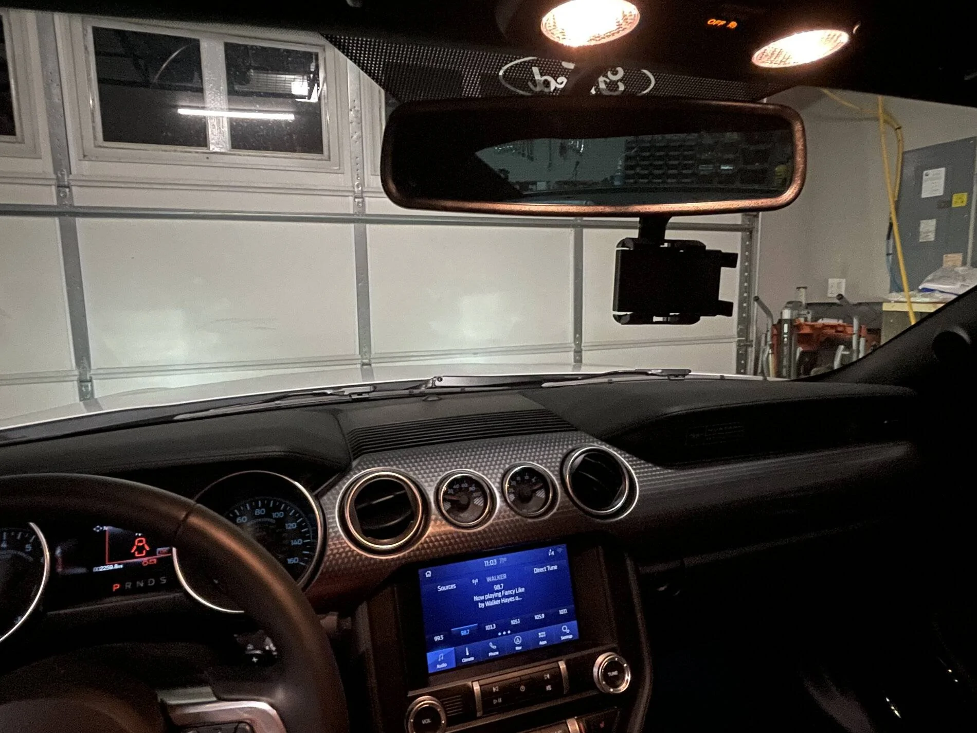

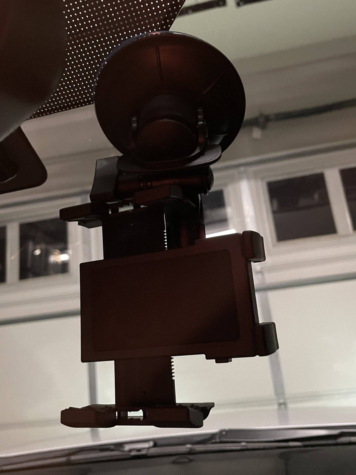

I researched this for a while! I don’t think one of our local tracks allows cameras outside the vehicle, so I resorted to 2 inside. The first one, just a secure, very simple and functional cell phone front window mount, in which I could run a Track-App, while recording video. Since I don’t use my cell phone while on track, this worked perfect while also logging track data and serving as a recording device.

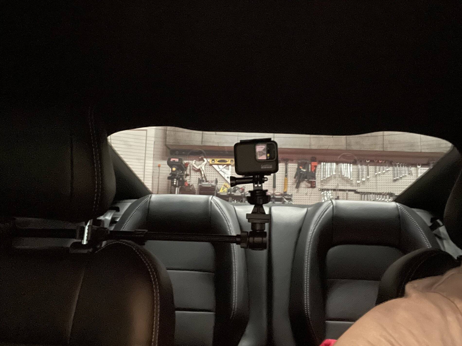

The 2nd video recording device is a GoPro Hero8 Silver ($200?) in a mount I got on Amazon that’s mounted to the passenger headrest, and adjustable. A video of each is below. They both worked very well. Unfortunately, I went through a few different mount options that didn’t work and wasted some time figuring that out.
Here’s the headrest GoPro Amazon mount in action
https://www.amazon.com/gp/aw/d/B00C7A9IOK/ref=ppx_yo_mob_b_track_package_o1_img?ie=UTF8&psc=1
And the front windshield mount (suction cup, no permanent sticky decal) for a cell phone in action
https://www.amazon.com/gp/aw/d/B00CO3HCUM/ref=yo_ii_img?ie=UTF8&psc=1

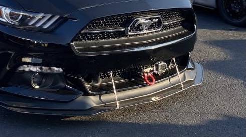

Do you have a picture of how you have that mounted? thats a great view and id love to find a way to set up my go pro that way.
I will share this evening.. Mounted to the Center ZL1 Addons tow hook.
Bridgie
May 25, 2015
587
963
Raleigh, North Carolina
2015 GT fastback. PP, 50th trim, Black

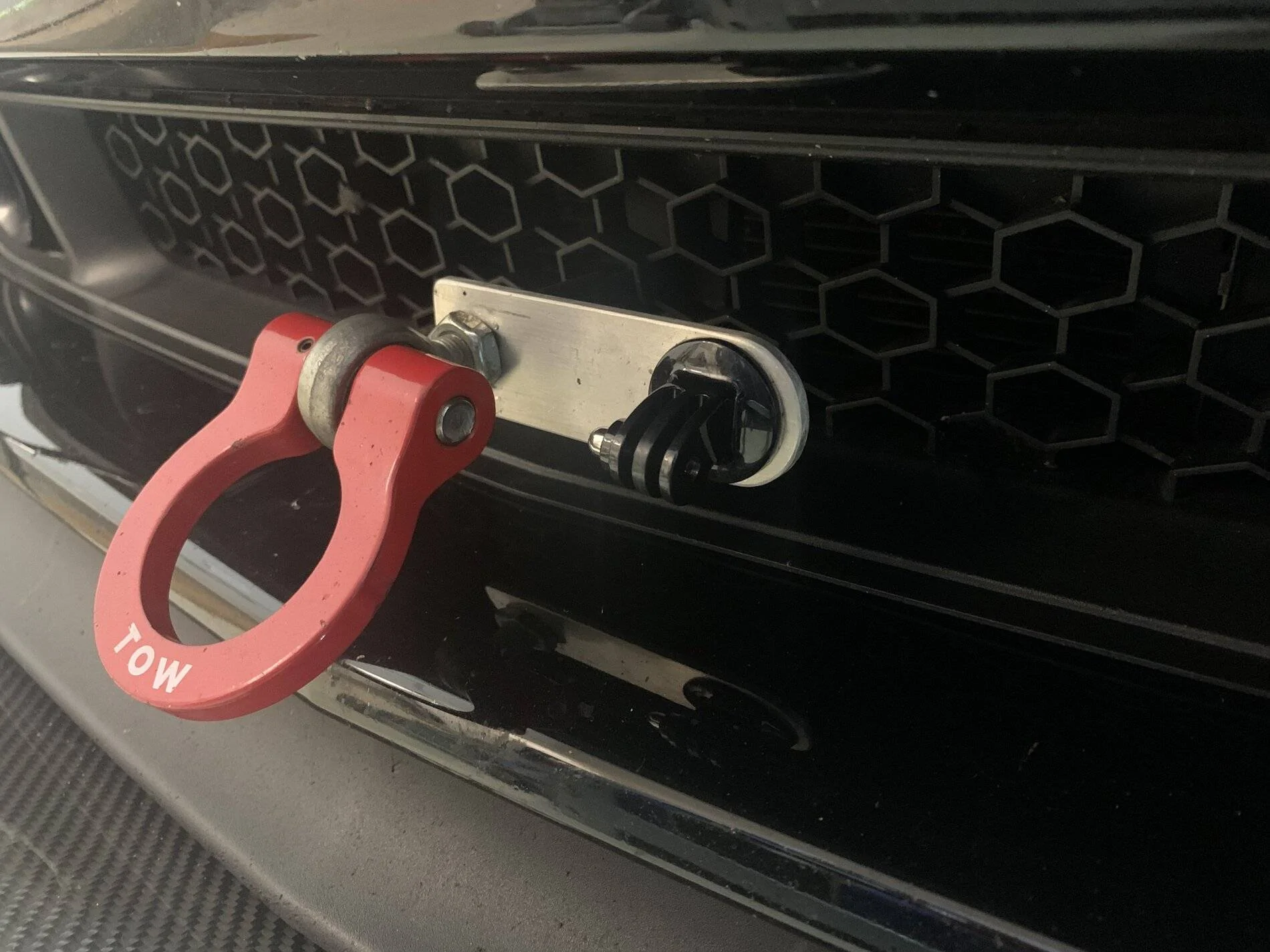

Fabricated a piece of Aluminum plate, mounted to Tow Hook, secured by the lock nut. A couple of Amazon GoPro accessories.
Result is a nice rigid camera mount.

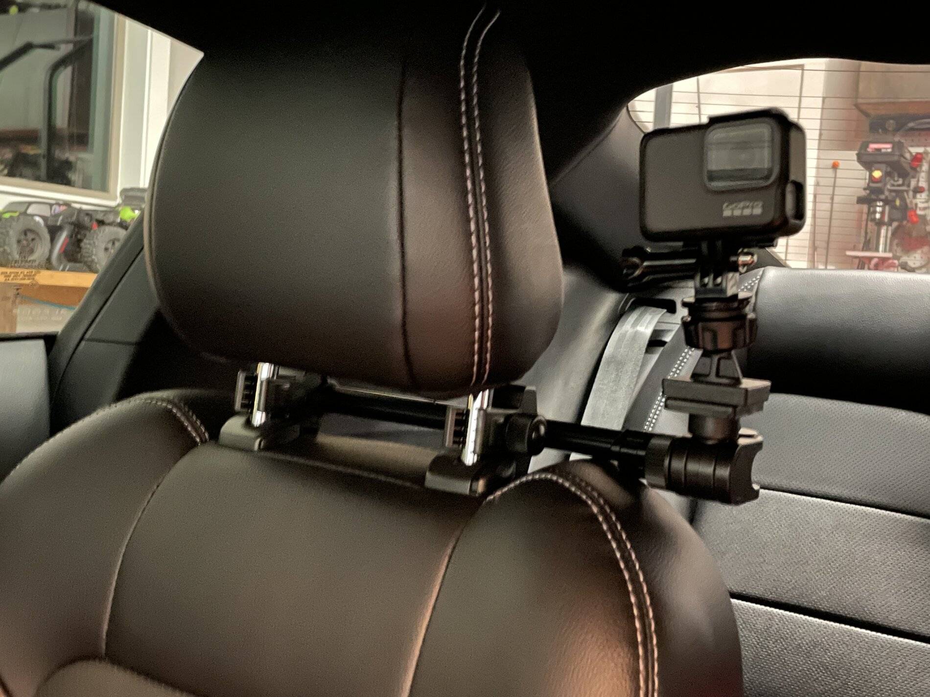

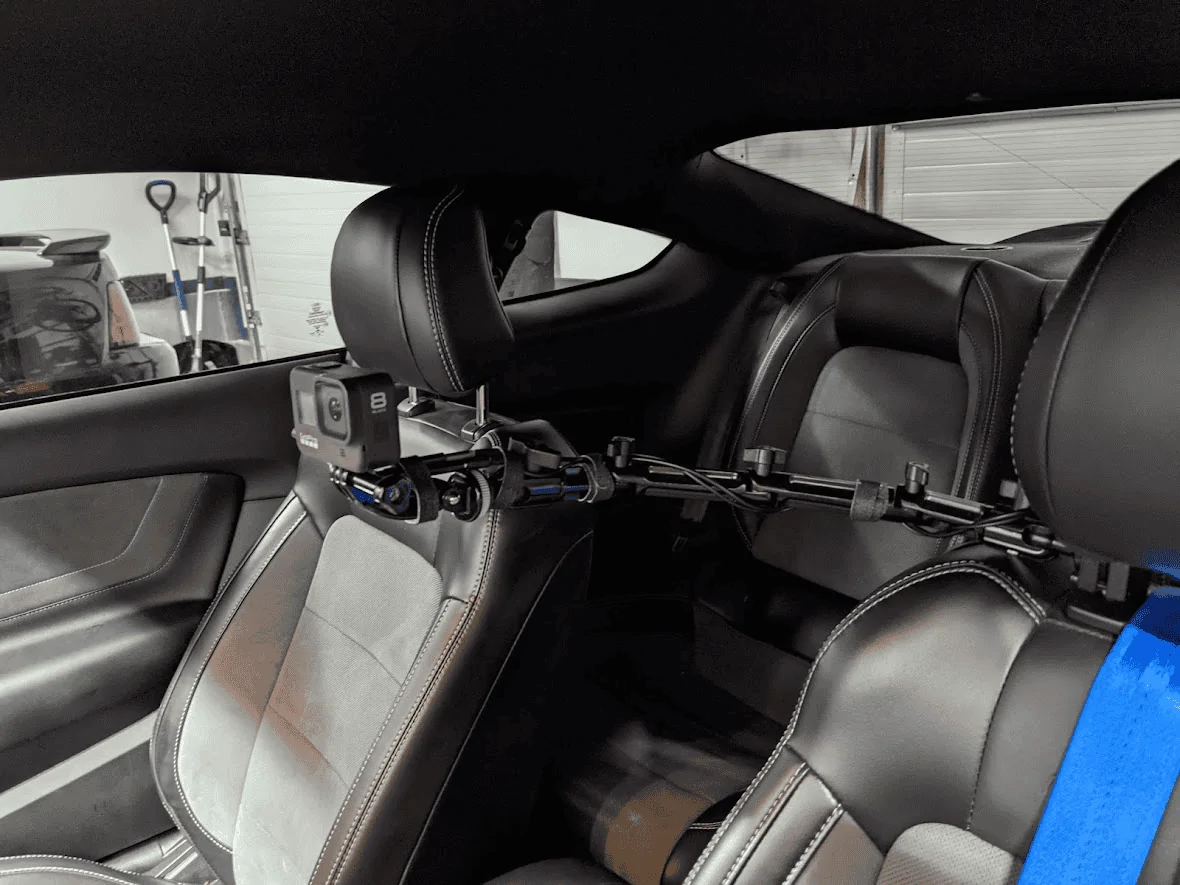

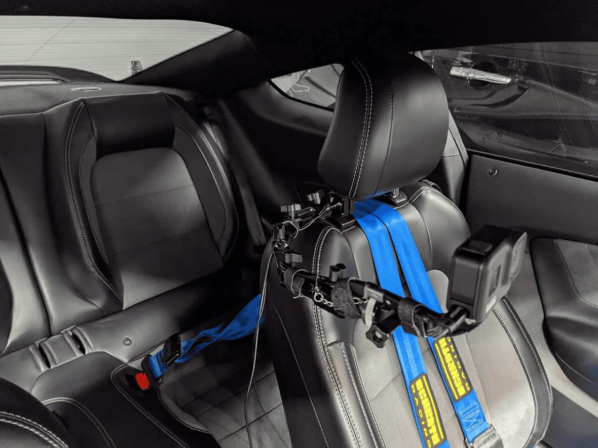

I've been chasing an in-car setup that allows me to see my hands and also get a decent shot of the course. It's a lot easier if you have a convertible or no windshield but for the Mustang this is what I've come up with.
I try to get the camera lens at about the same plane as my eyes, so it's forward of the head rest quite a bit. It's a bit wobbly being cantilevered that far out but the Hero8 does a decent job of smoothing some of that out. I've hit it with the helmet once or twice by accident when messing around before or after a run but never during a run.
The arm is made by Tackform and I got it from Amazon. It only takes a couple of minutes to setup or remove. I leave the base clamped to the headrest post and pull one of the pivot thumbscrew/bolts to remove it. I did get one additional link from Tackform directly to get the extra length and then one of the brackets in the previous message to give a little extra length and adjustment at the end.
https://www.amazon.com/gp/product/B00XIB6SK4/ref=ppx_yo_dt_b_search_asin_title?ie=UTF8&psc=1
