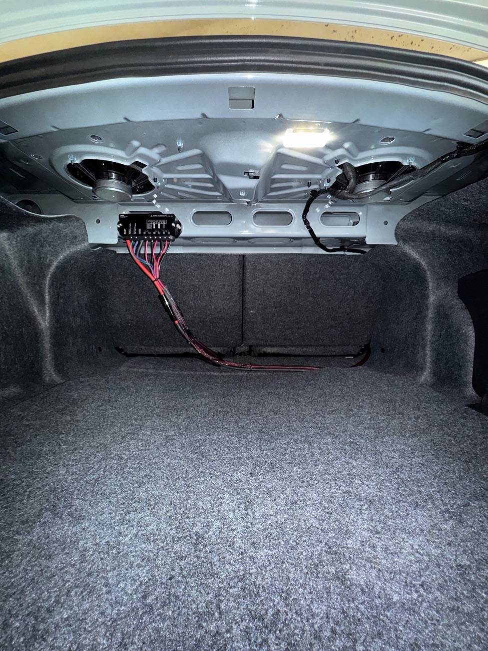

Hey all,
just wanted to see what y'all have done to hide this or any thoughts/opinions on the best ways to do so. It’s just such an eye sore lol, I know it’s “hidden” in the trunk, but still.

Hey all,

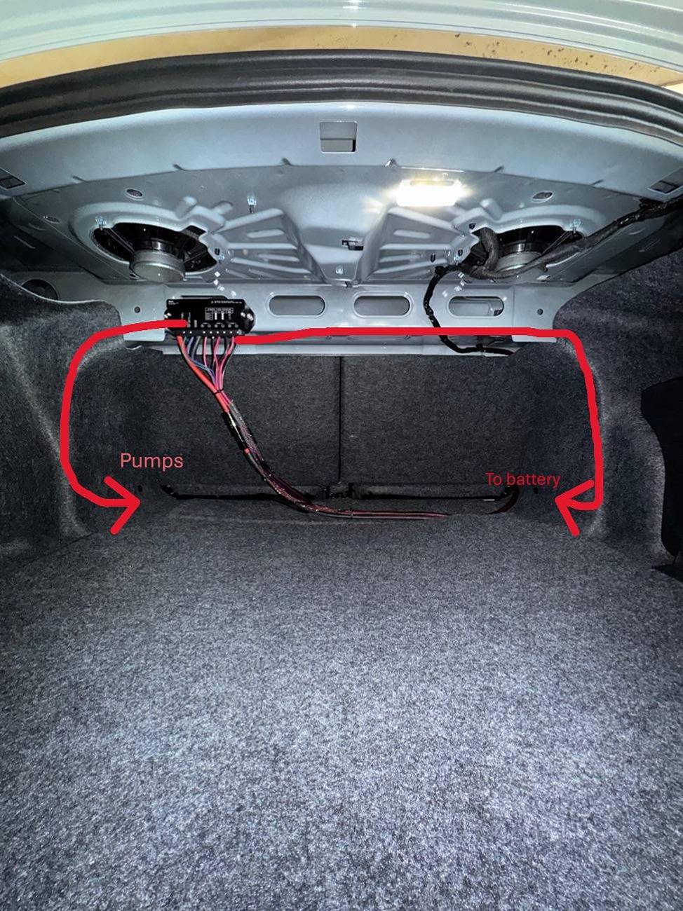

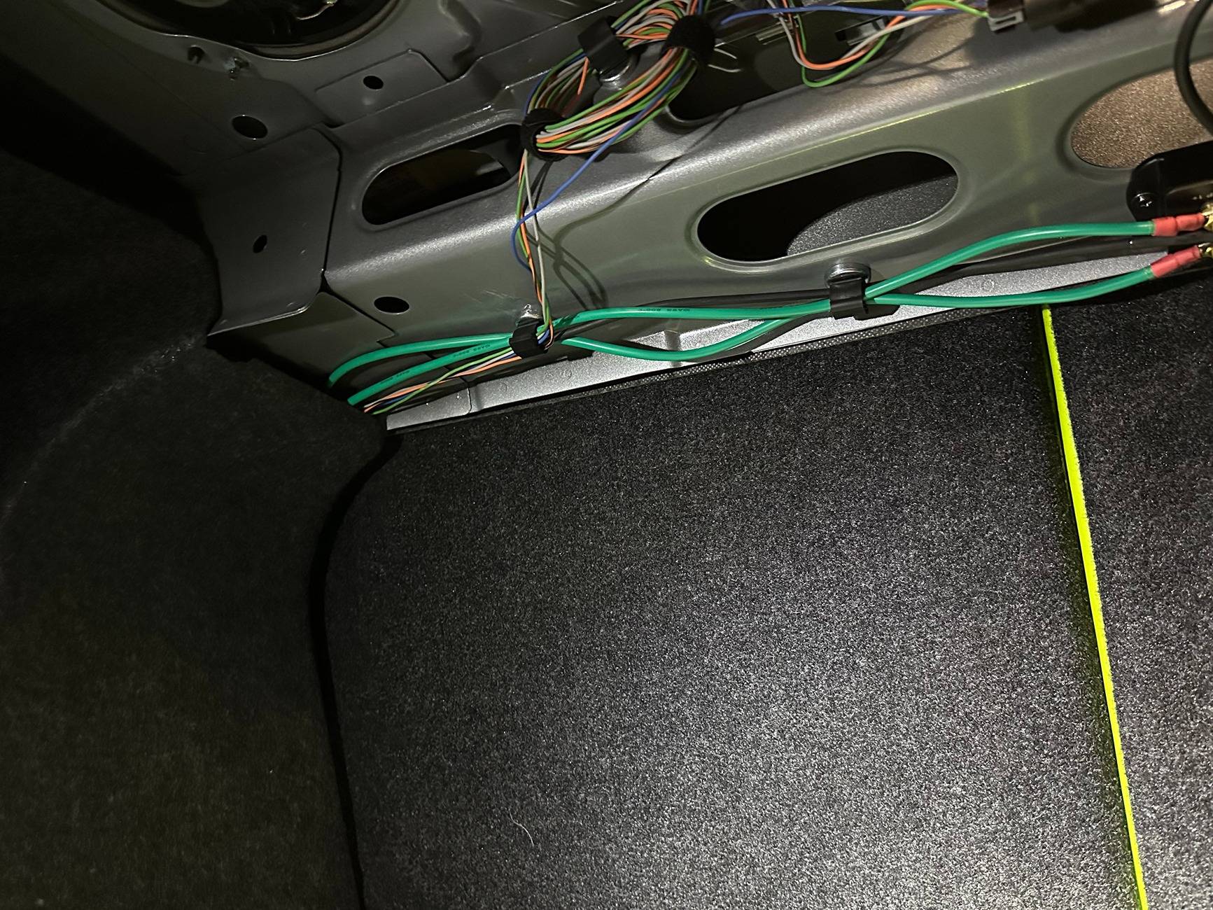

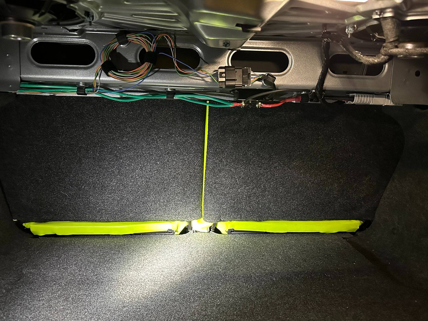

I ran mine like this. Take the liners out of the trunk, and run the wires behind them. I'll get a picture when I get home for you. This way you can still use your trunk space, and install a spare tire (which you can't if you put the controller in the spare well)
I then used these super strong magnet wire clips to hold everything. They swivel and keep everything well organized and safe
MagDaddy - 1/2" Magnetic Cable Clamp - 26lb Rating - B - WireCare.com

Thank you very much for taking the time to write this! I will follow the way yours is set.

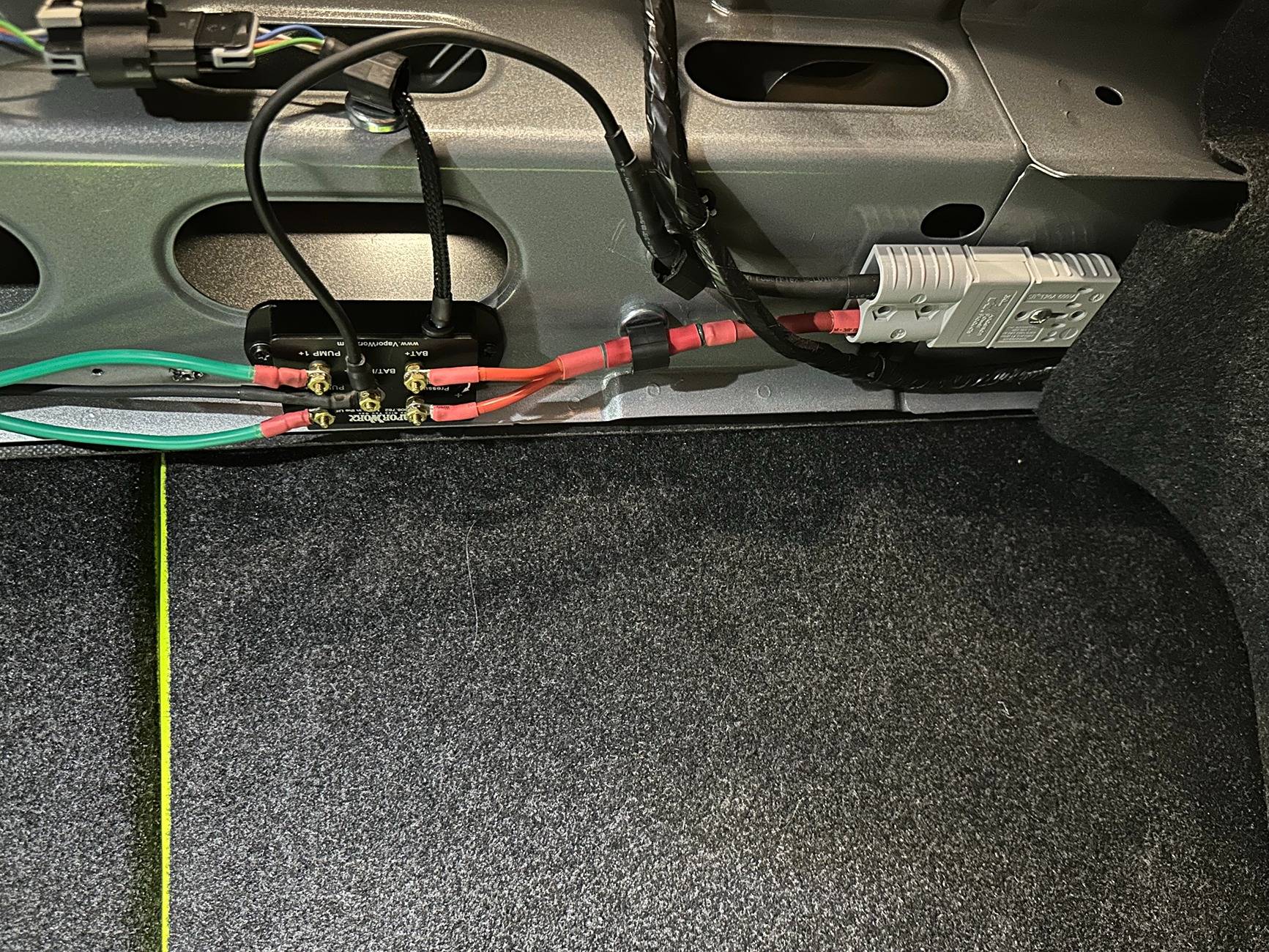

I did mine like this. (Obviously I have a different controller, but same idea) Now I just need to figure out a cover, probably something wrapped in carpet that has hinges, so it swings down for easy access, but protects the controller and wiring from getting bumped. I never really have anything in the trunk, but as you can see this controller has exposed power and ground terminals
