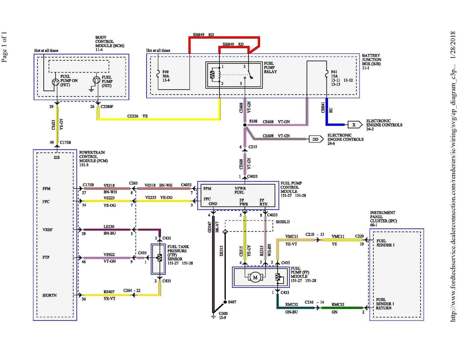

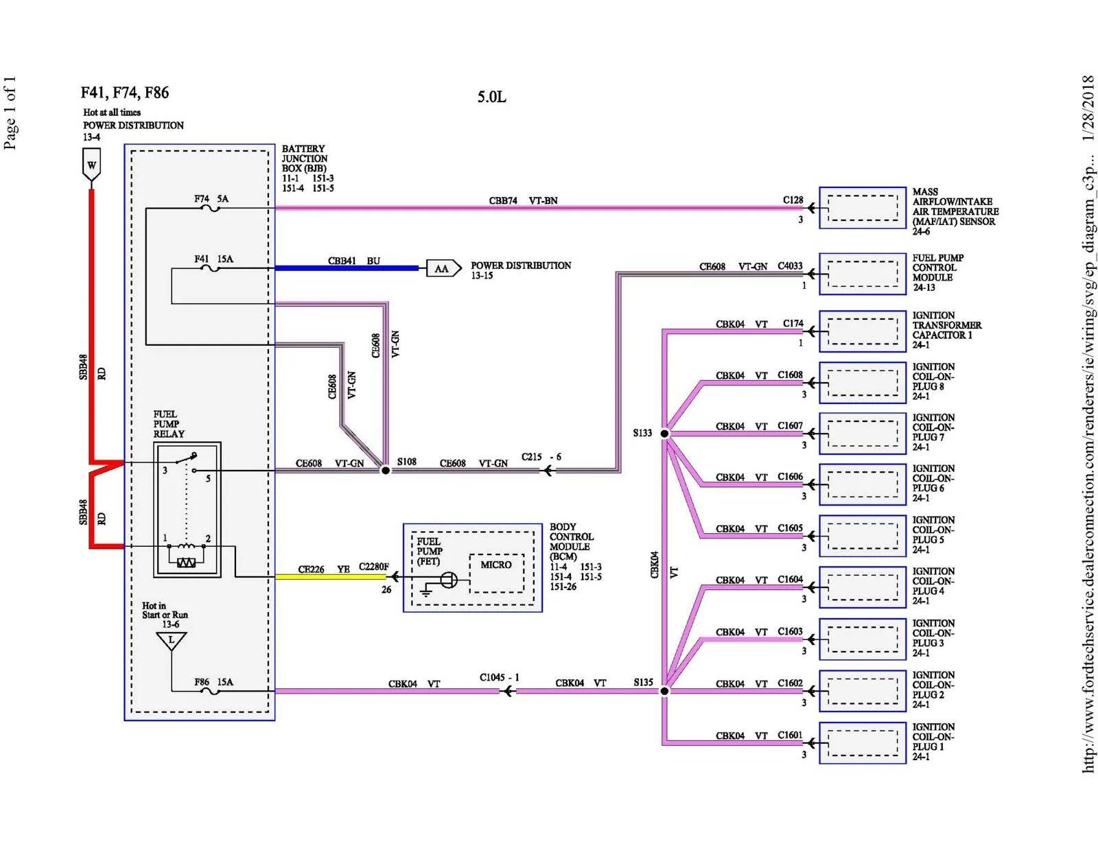

Resurrecting this thread. Check these out.
So it seems like I can use either the violet-green wire that comes into the FPDM and tap that as my ignition on, and it will either be off or 12V with the ignition on (including accessories).
Or, I can use the Yellow Grey wire which should give power under the same logic as the factory pumps (initial prime for a few seconds but don't run accessory on, full on when the pumps are running).
Is there any advantage or drawback to running either of those?

Lethal Performance Tech Tips: Your fuel pumps get TRIGGERED! - YouTube
So Lethal does a great in depth write up. My question is, if I trigger between the FPDM and the OEM pumps, is that current pulsed? Or is it a full send? I thought the whole point of the FPDM was that it wasn't always full send. Will that affect the relays or is it a non-issue?

No that signal is the pump enable signal: It is the same as when you walk up to the car and the pump turns on. I believe it is a yellow with grey tracer wire from the FPDM . The actual pump wire is thicker gauged wire. what pumps are you using? You can use the FPDM wire for one pump I believe as long as it doesn't exceed 25 amps.

This is just for trigger(s). I'll have 3 (or 5 really). 2 Primary pumps, two passive lift pumps and an electronic regulator. I just need a good clean trigger source for when the system should operate and would prefer to stick to OEM logic (prime and key on, etc). Was just curious if that's pulsed. If not, we're good to go.
I have new power feeds for supplying everything with juice.
