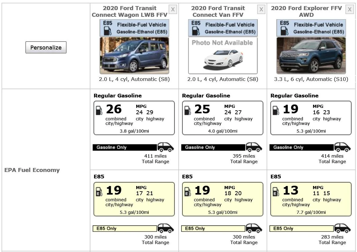

V and Earl: Thanks for the insight but I'm curious about E85 requiring 33 percent more fuel. Is the trade off more horsepower?
It requires more fuel because each molecule produces 30% less energy when burned. the trade off is that E85 is at least 105 octane but it t's detonation resistance seems much higher than 105 octane gasoline so it allows more timing advance for more power. I see 22deg advance on E85 vs 17deg on pump 93. It also provides a greater cooling effect when it vaporizes vs gasoline.
