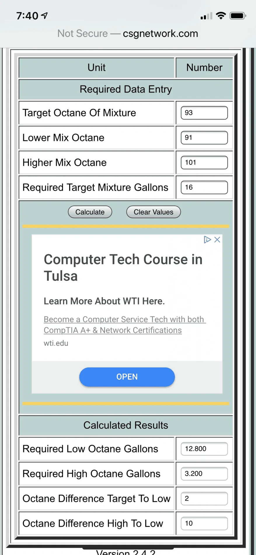

V: Thanks again, I should have realized there were octane calculators online. Looks like you get a two point bump for every 3 gallons of MS 109 added.

John: Thanks for that. I went to the site and did essentially the same calculation but I have 93 available. The results were nearly identical to yours and it clearly points out the fact that you need quite a bit of aftermarket fuel to achieve these final octane results. Not something I want to do with every tank of gas. Maybe V's suggestion to use water/methanol is a better solution, no pun intended. :-)
