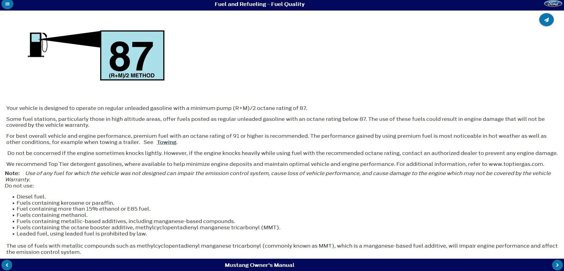

Please explain how it's "designed for 87". What, exactly, makes the Coyote engine "designed for 87"? Pistons? Rods? Intake? Engine mounts? ECM?
Ford Motor company designed it for 87, per their owner's manual. As it says, in the summer you will get a bit better performance moving up in octane to 91 or higher. If your car is a daily driver, 87 is fine. The level of detergent is no more between premium and regular. For example, Exxon gas in your area very likely could be from a non-Exxon refinery, it becomes Exxon (or Shell) when their unique detergent is added at the tanker rack. All gas is made to meet EPA detergent standards, but TopTier exceeds those standards and gets auto manufacturers' (like Ford here) recommendations. https://www.toptiergas.com/

Ford Motor company designed it for 87....
That's stating that 87 octane is the MINIUM octane that can be put in the tank. It goes on to say what can happen to the car and it's warranty if sub-87 octane fuel is used. It then goes on to say that if you want the best vehicle and engine performance out of the engine, you need to run 91 or higher octane.
It does not, in any way, shape or form, say it was designed for 87 octane. In fact it's basically saying that the engine was designed to run best on 91+ octane.
Reading comprehension is important.
Octane itself does not make horsepower. But when lower octane fuel is used, the computers will retard the timing to reduce detonation. Performance will be compromised as a result. Since the Coyote engine has such high compression, I would be more concerned with possible damage from knock and detonation. That is why the warranty thing becomes an issue.
