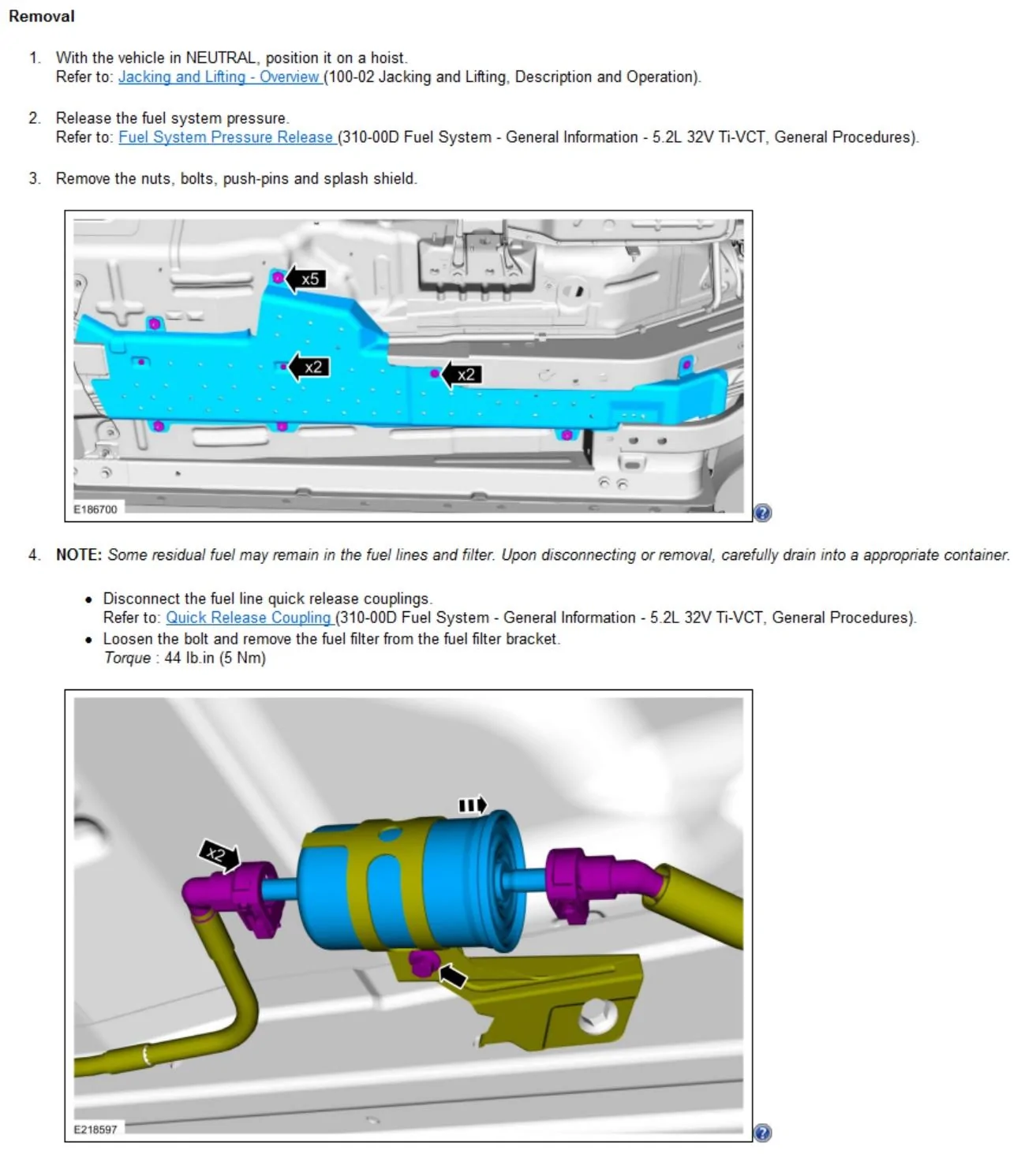

Have been searching but couldnt find one, how does one replace the fuel filter? I think manual states it needs to be changed every 30k miles, mine will get there in about 1.5-2 months. Thanks for the help.

Try this.
Installation is the reverse of removal. Don't forget to check for leaks.

Thank you so much. If you dont mind sharing, how do I get access to the system you downloaded that content from?
Also its referring to releasing fuel pressure. How is that done?
This looks like a very simple task and cant really go wrong?
Helm sells a CD manual with lots of good info on it. The images look like they are from that document.
Normally I'm used to seeing a Schrader valve (it will look like the valve on a tire) on the injector fuel rail in the engine compartment that can be used to release the fuel pressure. I'm not sure whether it is on the GT350, but the Helm manual probably has that information as well.

It seems like in the older generation mustangs they remove the fuse that controls the fuel pump and try to start the car 4-5 times to release pressure. Not sure if the same will work for gt350.

What is the part number for the fuel filter? I've looked everywhere and it doesn't seem to be listed.
Phenom5.0
5.2 ^^^
Jun 19, 2018
109
Robert
2016 GT350 Tech Metallic
I may be wrong, but I’ve read the standard GT does not have a serviceable fuel filter like the gt350 does. The GTs is likely attached to the pump like the old SN95s were.
I replaced my fuel filter last week and it was fairly simple. Motorcraft FG1083 Fuel Filter.
