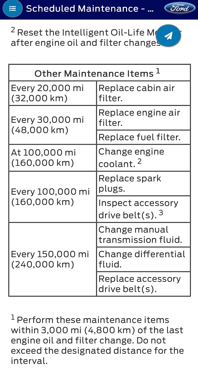

Well, maybe... So, while the 2016 Owner's Supplement is silent on the subject, the 2017 and 2018 Owner's Supplement says change at 30,000 miles and the 2019 and 2020 Owner's Supplements say change at 60,000 miles. I'd change it according to the 2019/20 Supplement instructions. The filter is the same PN for all model years, and it's not integral to the fuel pump like it is on most Mustangs, so changing it was made possible for a reason.

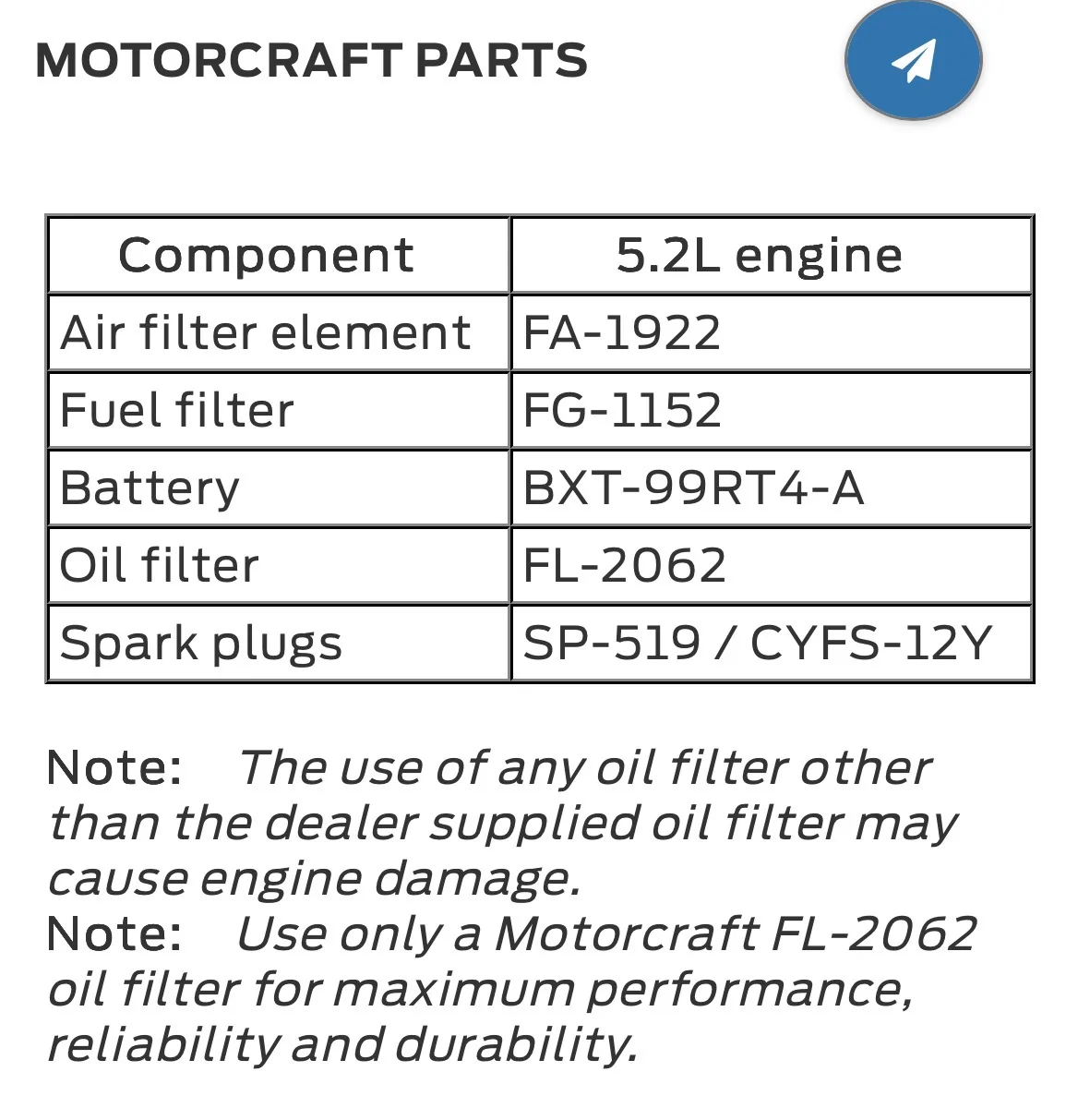

I am preparing to change my fuel filter on my 2019 GT 350 recently purchased. Has 35k miles. Parts Web sites and people even on this forum call out FG-1083 for the filter but the supplement manual calls out FG-1152. I got the 1083 but now ordered 1125. What has everyone else used? Curious for the change.
