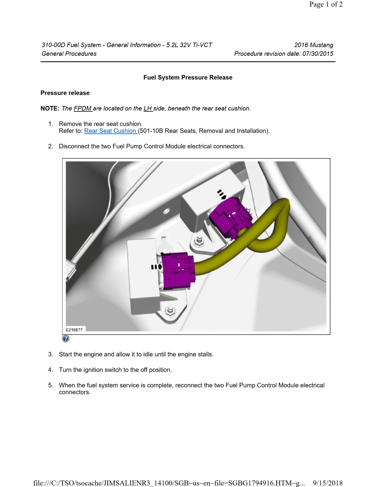

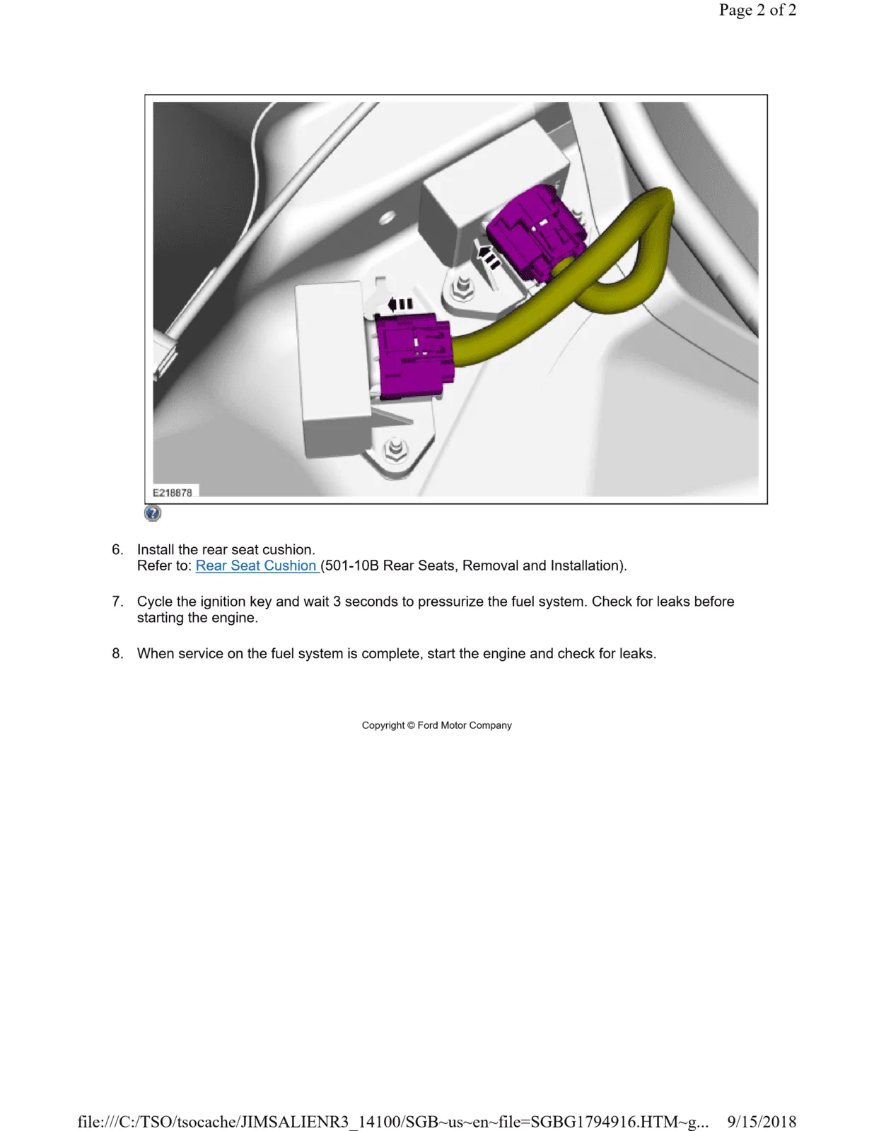

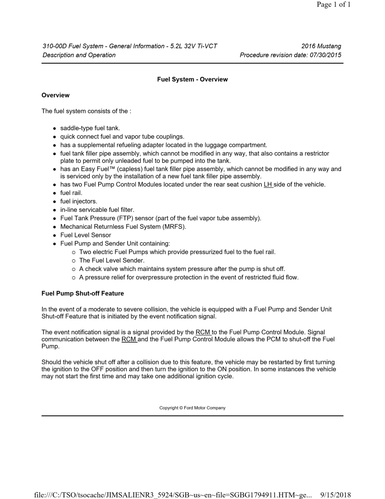

Is there anyway you or someone can post the procedure from Helm about releasing the fuel pressure?
Also does this mustang have intertia switch inside trunk to stop fuel from flowing OR a fuse that needs to be removed?

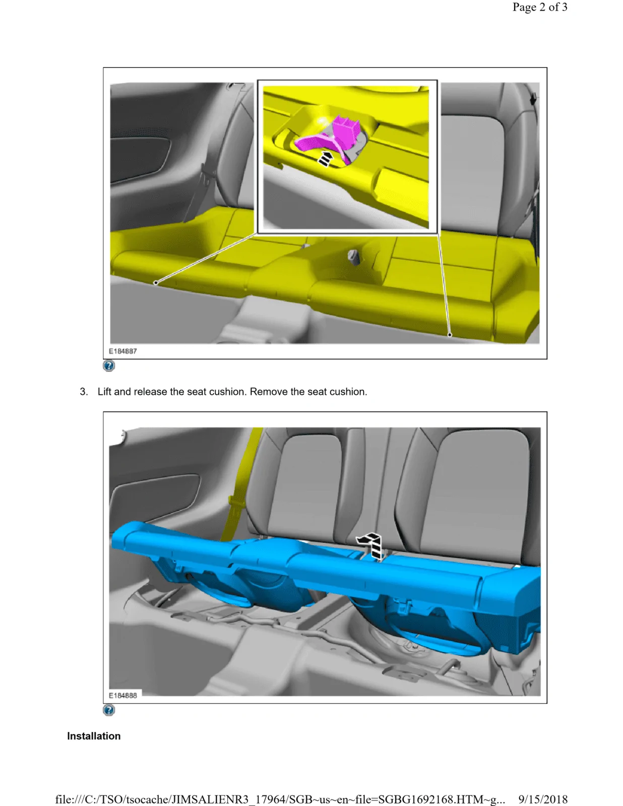

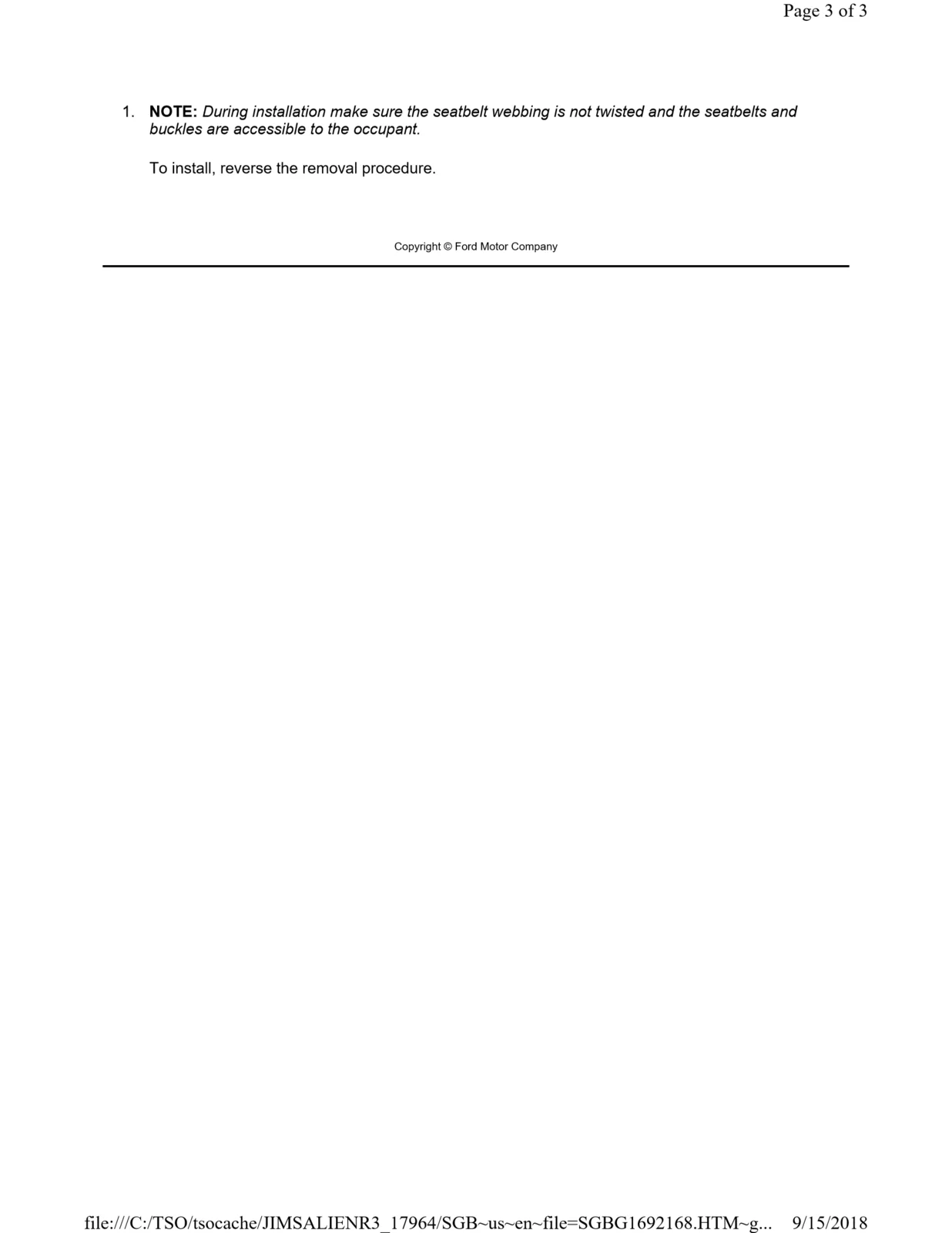

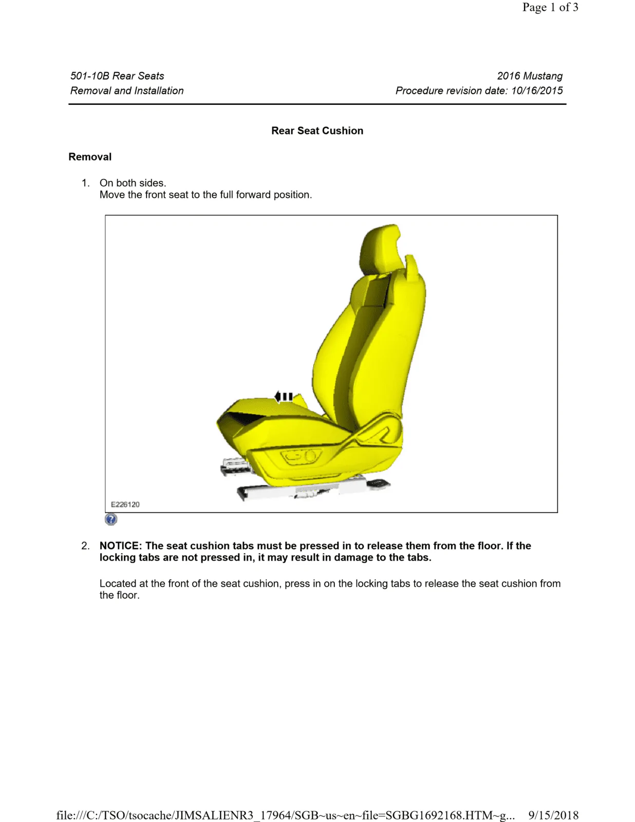

These are from the 2016 Helm.
The first page is the fuel system overview. The second batch batch is the fuel depressurization procedures, the third batch is rear seat removal because I highly suspected it would be a follow up question.....:sunglasses:

310-00C Fuel System - General Information - 5.0L 32V Ti-VCT/5.0L Ti-VCT V8 (308kW/418PS) 2016 Mustang
Description and Operation
Procedure revision date: 06/27/2014....
From the Fuel System Overview
  • Fuel Pump (FP) module containing:
    • The electric FP module which provides pressurized fuel to the high pressure Fuel Pump (FP) .
    • The Fuel Level Sender.
    • A check valve which maintains system pressure after the pump is shut off.
    • A pressure relief for overpressure protection in the event of restricted fluid flow.
    • A lifetime fuel filter providing filtration to protect the fuel injectors from foreign material.
