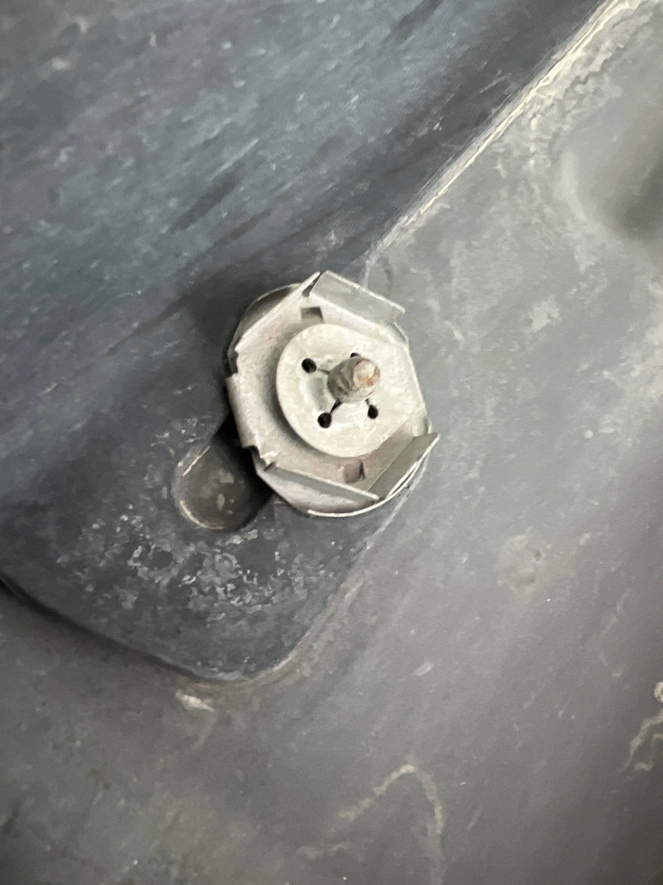

Was trying to change the fuel filter on my 2019 today. Ram into this fastener where I expected a 10 mm bolt. How do I get this off?
Edit: in case anyone else runs into this: grab the ridge with some pliers and twist it like a nut. Can hand loosen after a turn or two.
