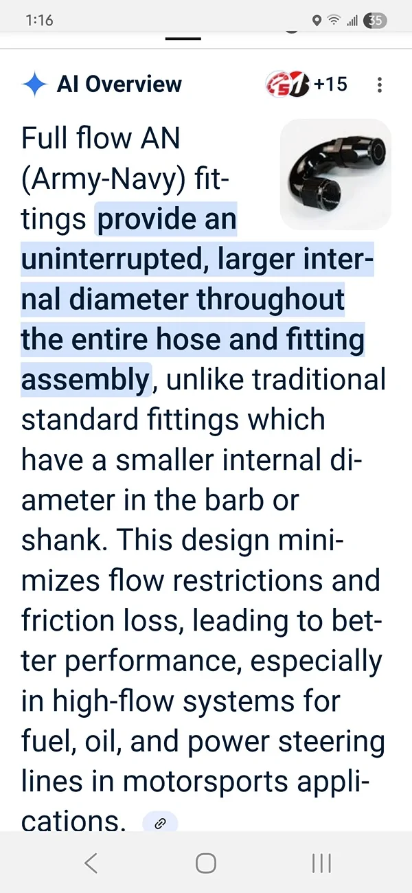

I would suggest using "Full Flow" AN fittings to reduce the loss of flow throug fittings.
