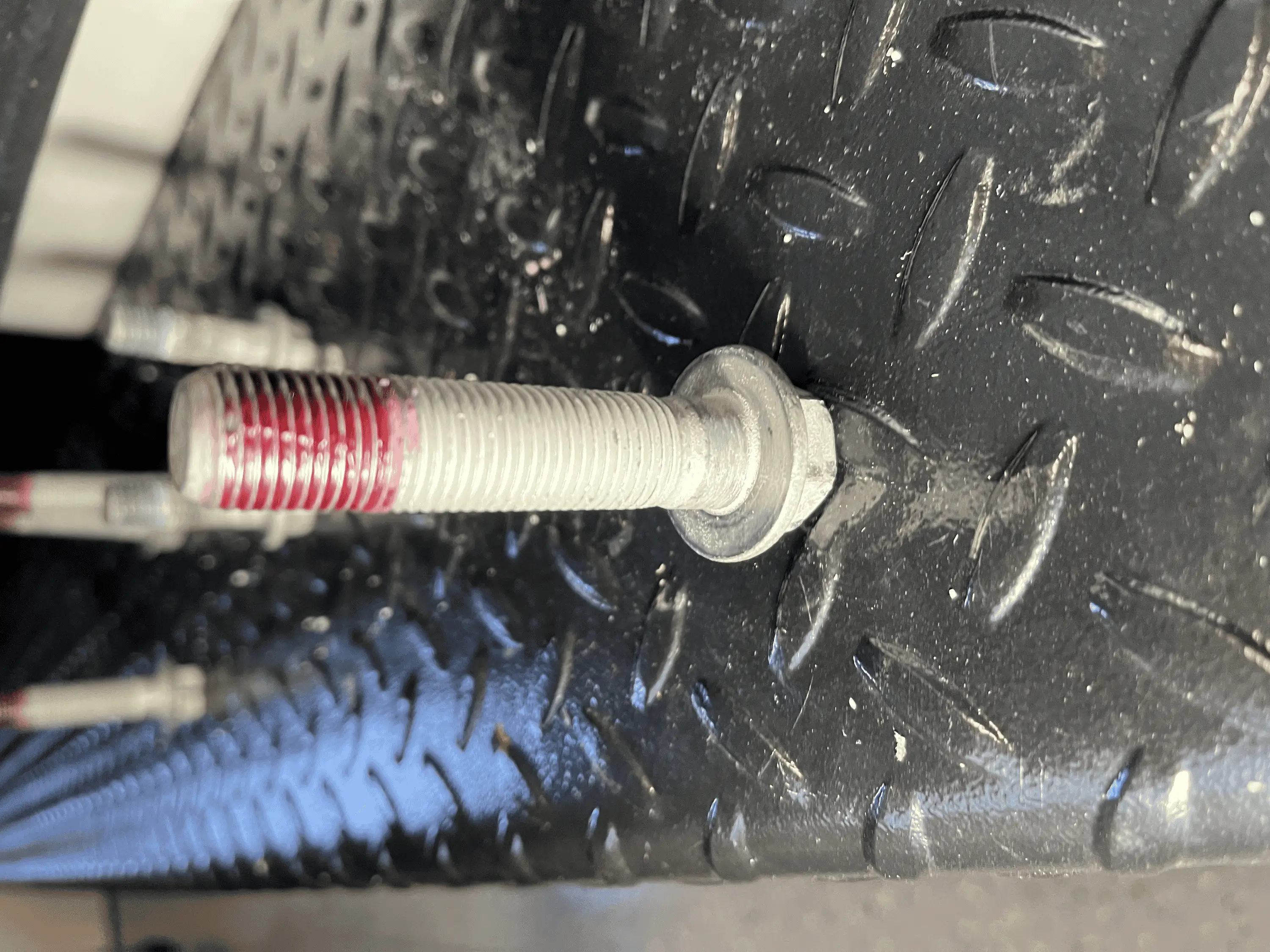

Remember.....those bolts are single use ! The tech at Ford showed me my old ones compared to new ones....they stretch!
