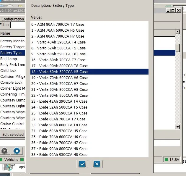

I have a 2017 gt and probably a good year or 2 ago now I installed a xs power d4700 agm battery trying to solve a constant drain I was having. During the install I change multiple forscan settings from change, state of charge (or something similar) and another one relating to max charge and maybe some more. It's been a long time and I had really no idea what I was doing but I had forscan open/running for various other things (sync 3 upgrade). Is anyone knowledgeable about forscan who might be able to help me? I've been fighting dead battery/system off message on the screen for YEARS now. I'm at a point again where I think this battery has died so much it's damaged as it dies almost every day or every other or it will start and I'll drive for a bit, park it and it's dead as can be and needs a jump. Please someone help because I have no clue what I'm doing and don't want to mess anything else up.

As I was saying here, the battery settings in the BCM are hit and miss. It's best not to touch them.
I was about to suggest the above website to get your original as-built file, but Glenn beat me to it. Enter your VIN, download the original file for your vehicle, and use ForScan to override all the BCM settings with those from the file.
Take note of any other changes that you may have made to the BCM besides the battery, so you can make them again afterwards, once you are satisfied that the charging system is fixed.

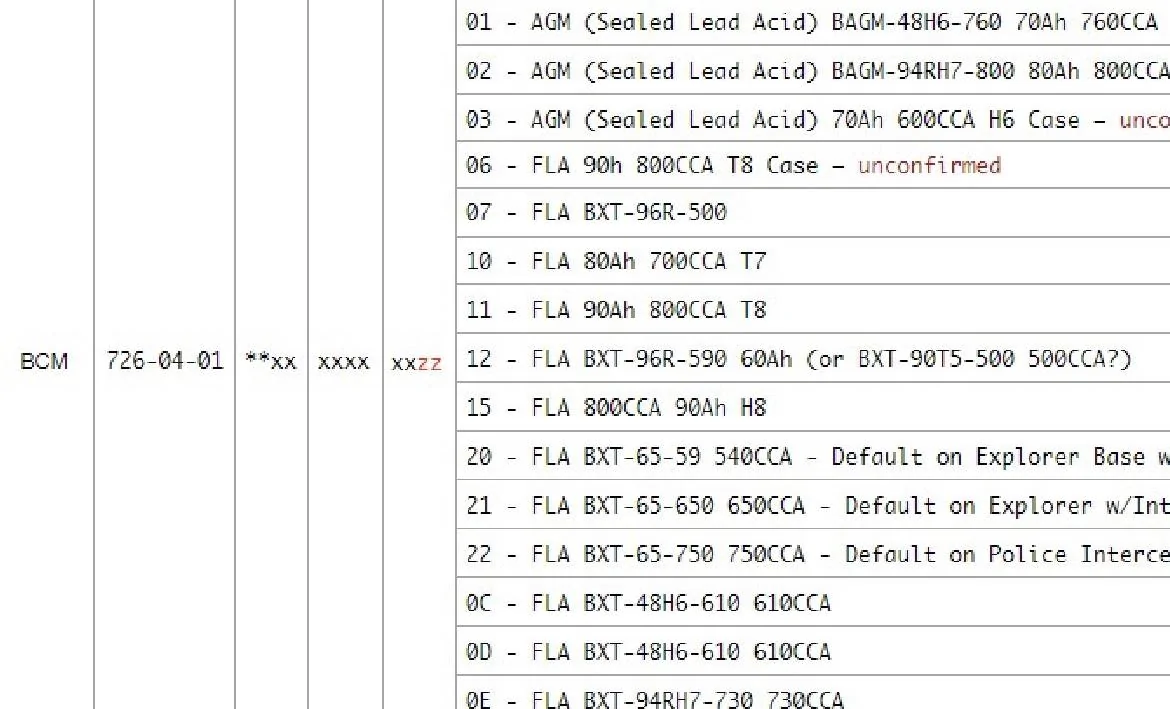

It reads as though the battery swap and FORScan changes occurred as part of or in concert with the Sync3 upgrade. I'm assuming the root problem was happening before the Sync upgrade.
It might simplify t-shooting these problems by reverting back to a traditional, Flooded Lead Acid (FLA) battery. I realize some of the FORScan settings might have been lost. Maybe we can help with that. Enclosed is some reference information I have.
There are three FORScan fields I'm aware of: Battery Technology, State of Charge and Case Size.
1. Battery Technology: Flooded Lead Acid or Absorbent Glass Mat (AGM).
2. State of Charge: the factory setting is 80%.
3. Case Size:
- If the factory battery, select, "BXT-96R-590"
- If an AGM, the closest comparable I can think of is, "AGM 70ah 600CCA H6 case". This is if an AGM was selected that most closely matches the factory battery. If you've installed something else, select the option which most closely matches that.
There is an additional setting, "Rate of Charge". Several references I found mention it's set at the factory, 80%.
https://www.mustang6g.com/forums/threads/battery-saver-message-on-a-new-battery.224209/
https://antigravitybatteries.com/he...FU_y0RvhbAvcWOjo9bdzx4DYkI5whYQ-2jDuLfecTTCQP
https://www.f150gen14.com/forum/thr...hanging-battery-charge-rate-in-forscan.21552/

There's the chance that, while you were and possibly continuing to deal with a parasitic loss, without knowing all the FORScan changes, the car might not be charging the system back to it's full potential. I'd at least confirm the batt settings I pointed out. Other Members might provide more still.
It would also help to confirm the state of the existing battery. A parts store can do a load test. IDK if they'd have a charging service, where you could drop it off for an overnight top-up.
