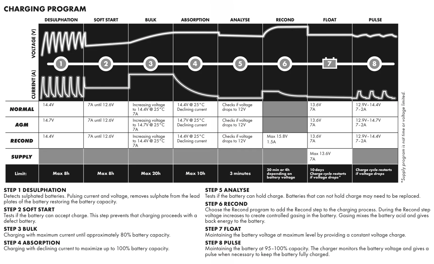

- I'm attaching a user manual on the CTEK. I have the same model. It has an AGM option. I've taken the unit will auto-sense, but if you'd like to switch it to "AGM" mode, that certainly wouldn't hurt
- You didn't mention how you drive. How often or for how long. Given all the above, the battery might need some topping up. It'll get there on the tender
- You've had the car for a while. If left in storage, tender or not, new battery or not, the car will eventually go into battery saver mode. About the two-week mark. The sleep mode works in two ways: 1) the battery actually is low and the car wants enough on-hand to start the car, 2) the car hasn't been driven in about two weeks. Since the vehicle doesn't know when the Owner will return, it goes to sleep automatically

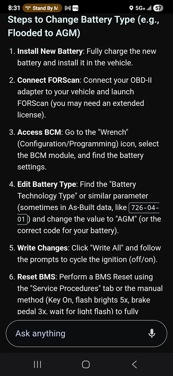

Did you use forscan and physically select AGM battery type in your BCM as build configuration?

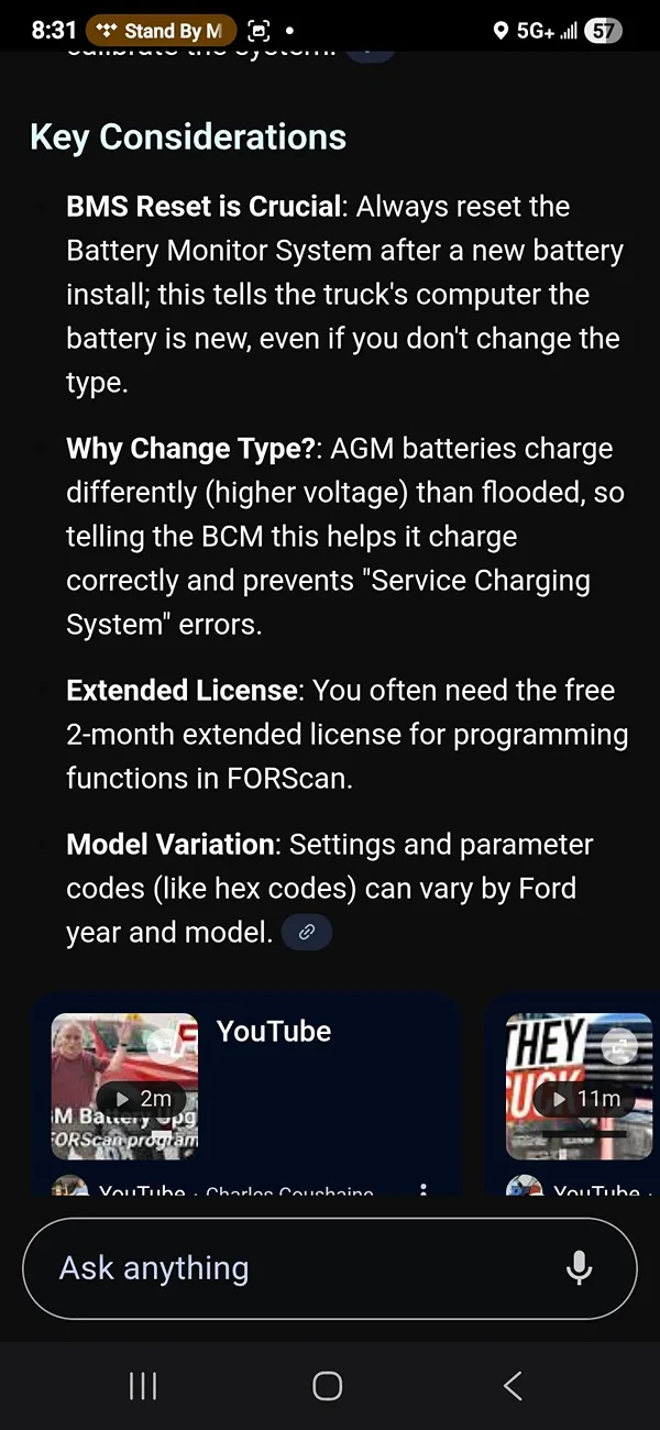

Forgot to mention, I did perform BMS reset after I installed the battery and did select AGM on the charger. Instructions did say the battery icon would flash 3 times after the process was completed, but I kept seeing 4 flashes. I tried the reset 3-4 times with same results.

I didnt realize that FORScan was necessary... My understanding was that doing BMS reset was sufficient. Ok, I will try FORScan process. Hopefully the battery is still good.

The battery should be fine. Your car just needs to be programmed for the higher charging voltage battery. ( AGM)
