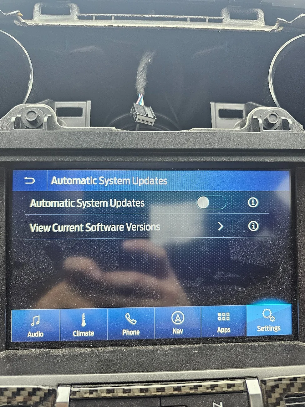

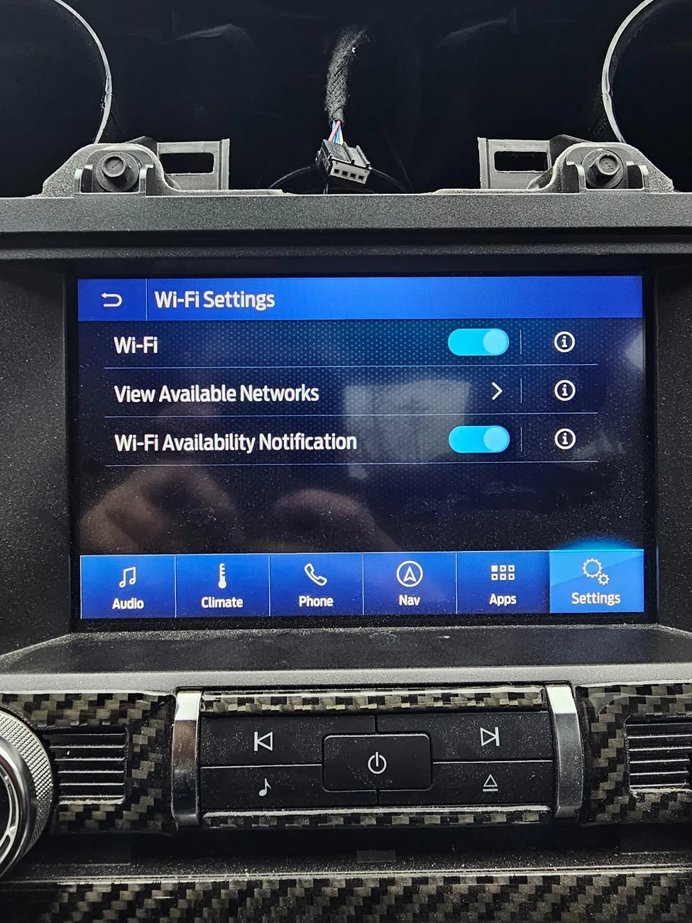

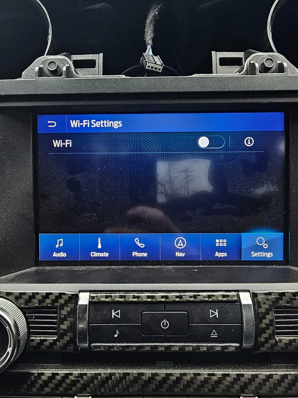

Not sure how to configure it, here's a pic of what it looks like and then I turned it off. I also turned off automatic updates in case that was also searching. I think I also found an issue leading to some of this, the xs power battery terminal for negative side is too small. Clamp maxed out (impossible to tighten any father I fully maxed it out) and I can force it to the side and then wiggle it off fully hlby hand no tools and with not much force. It's the clamp coming loose since the battery terminals are tight (hopefully not damaged right since they call out 8 ft lbs and I used a 3/8 torque wrench that's 20-150 husky brand but had a line for 10 ft lbs so I went to that but it's def tighter than 10 but it's holding).
Yes those are the WiFi screens. And yes battery terminal is a good find. That needs to be swapped out.
