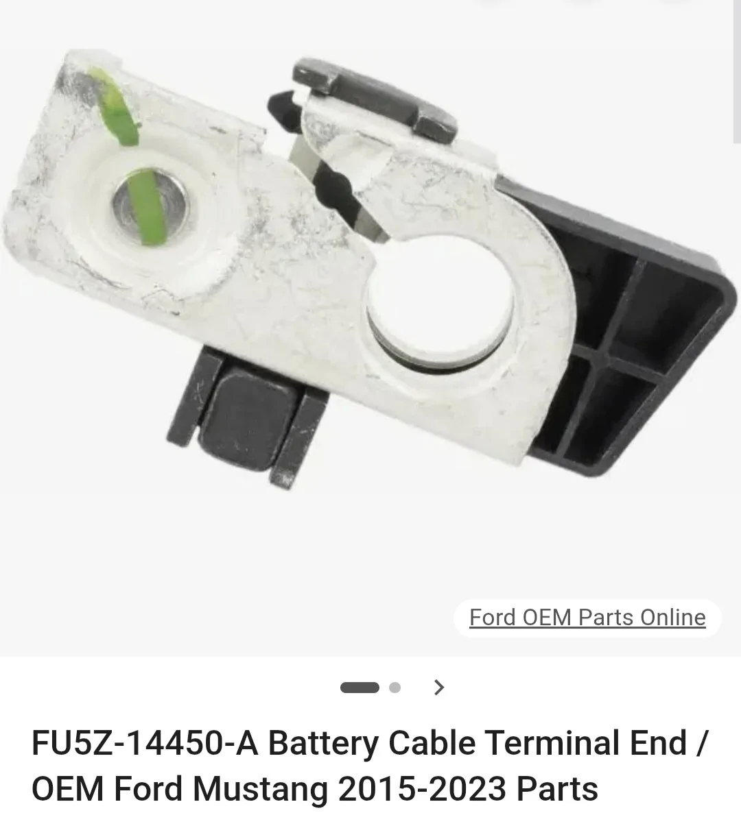

I would suggest that the oem would be best. Any local dealer, Ebay, several online parts stores will have them. Or contact one of our fourm sponsors that are Ford dealers. $20-$30 or so.
I mean for a screw in post. A new clamp itself won't do anything since the post on the battery is to small for it. I have my clamp 100% maxed out and I can slip it off with a twist.
I'd never recommend it but if I were desperate I might google search battery post shims.

You are assuming that the terminal is good and the battery post is too small. The post's diameter didn't shrink, unless messed with. The terminal on the other hand can become distorted. I suggest buying a new terminal and test fit it to the battery before permanent replacement. This will reveal which one is the issue.

Given once it's slightly loose it falls off almost I'm thinking the actual taper/ since it's wider at the base is wrong
These are what I'm running right now and compared to other brands and posts they def are a bit more narrow and have a more aggressive taper to them. I'll look into a new terminal but worse case I can just go buy a washer and unbolt the terminal and bolt the negative directly to the battery? I see no reason why it wouldn't work I'm just not sure there's enough slack in the line to bridge the gap. I could buy a rectangle of copper and just make a small spacer with 2 holes, 1 at each end.
