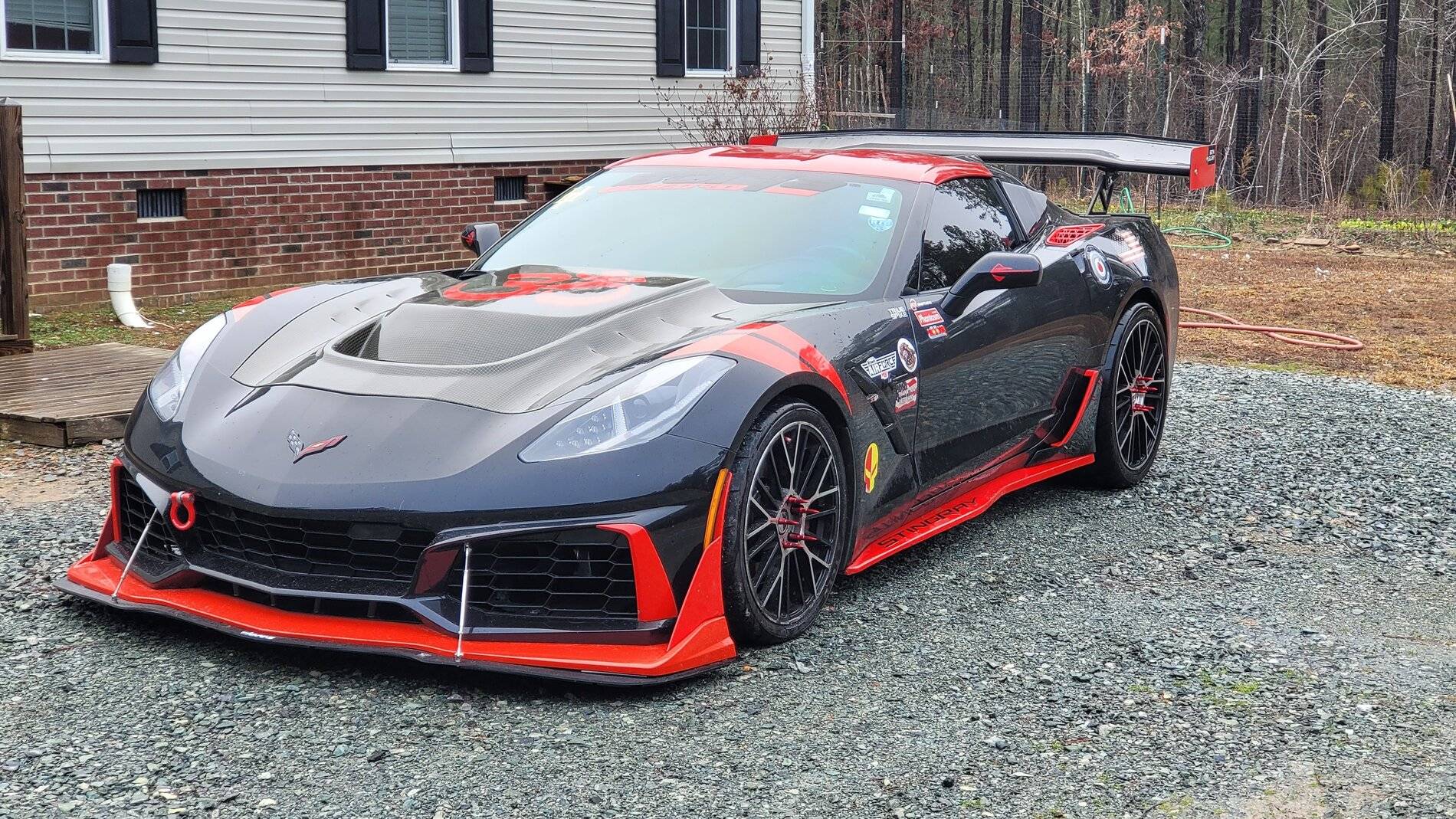

Thanks for the great info. I didn't have the Mag suspension on the Vette. I installed LG GT2 Coilovers which effectively planted my car like a pancake taking turns at 4 times posted limit.
A buddy of mine who's a race car driver said it will be night and day difference between the Mustang and the Vette.
I guess what I'm trying to accomplish is getting the car planted and not spinning tires thru 4th gear. I put together one package on Steeda which cost $1300 about a 2k and 14 hour install. The Performance Pack is about a $700 install and cost less.
I just want to make the right decision the first time.
I was on the Corvette for about 6 months and asked around 1000 questions before I began modding.
Here, I'm still learning that's why some of my questions may seem dumb.
Just sold my baby. Man, I miss her.
