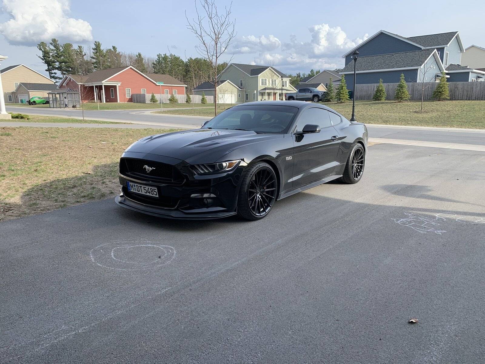

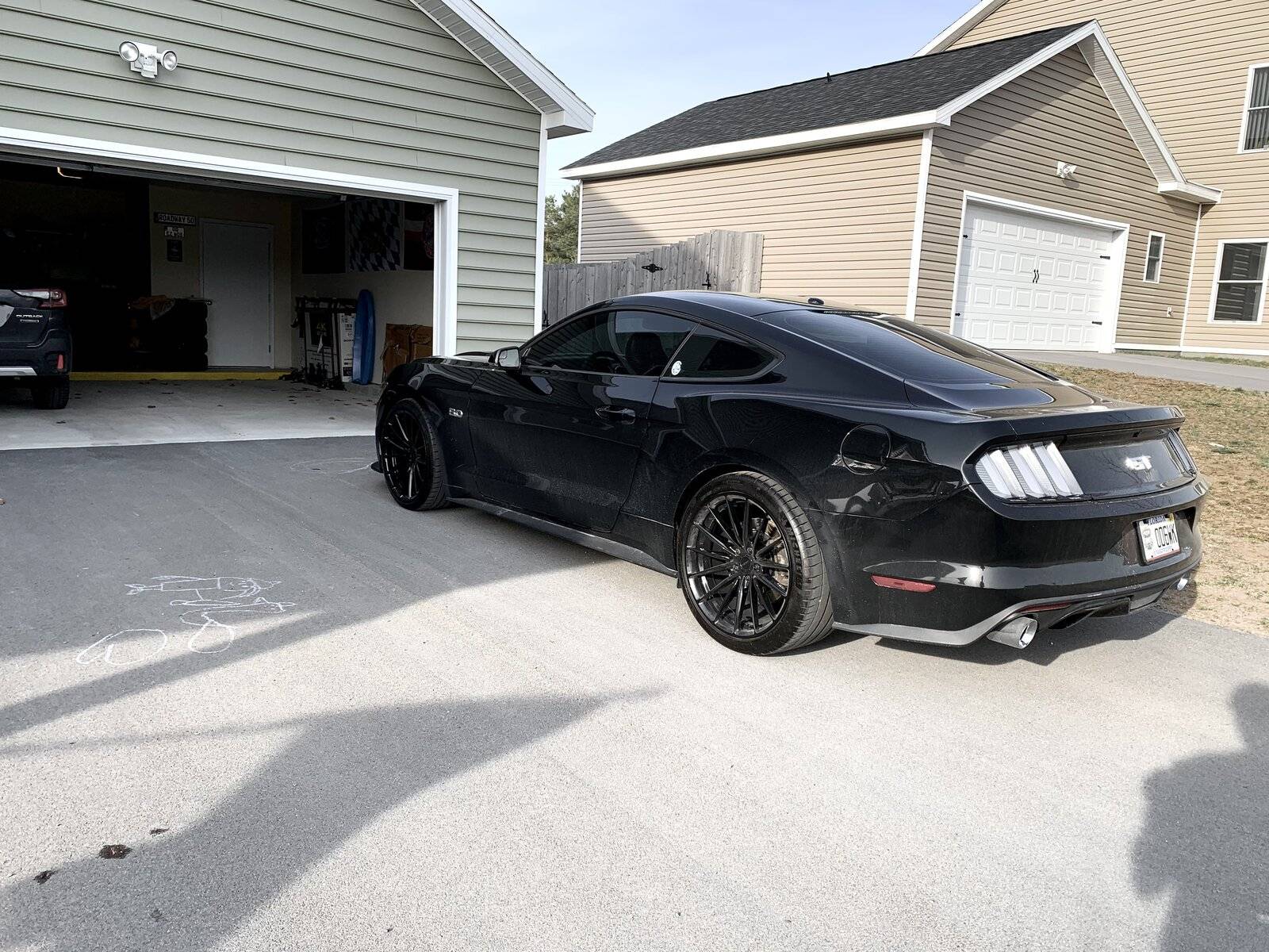

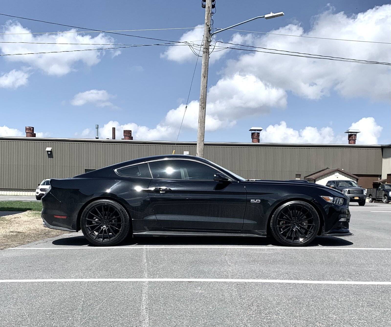

Here’s a few photos of the X springs on my car. This is 3 weeks after install — the rear of the car was laughable high for about a week, but has settled nicely:
The fenderwell gap from front to rear is nearly identical at 1.15” (front is 2mm less gap) with my staggered setup. I run 275/30/20 and 305/30/20 MPS4S. Very pleased overall — the ride is super good.

Yeah, I really like the ride on the X springs. I can barely fit 1 finger between front wheel and fender and I can fit two between rear wheel and fender. The front dropped almost 1.5” for me. I’m having my dealership look at tomorrow while it is in for other work.

Considering your large diamter tires, the front seems to be in line and correct — the rear with your 305/35/20s is about 0.5” too high. Let us know how it goes.

Rear did drop a little after the dealer made adjustments with full weight of car on the ground. Still not as far as I had hoped, but hoping it might settle a bit more in the next few weeks.
