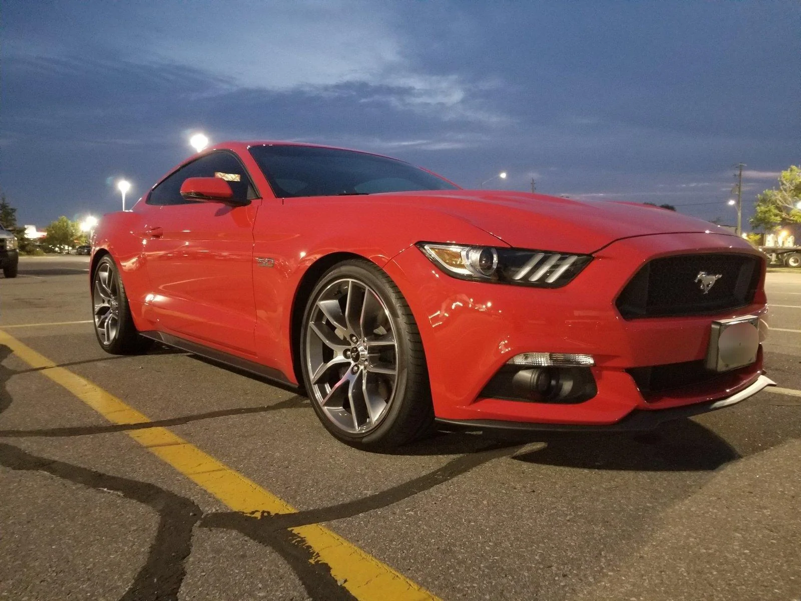

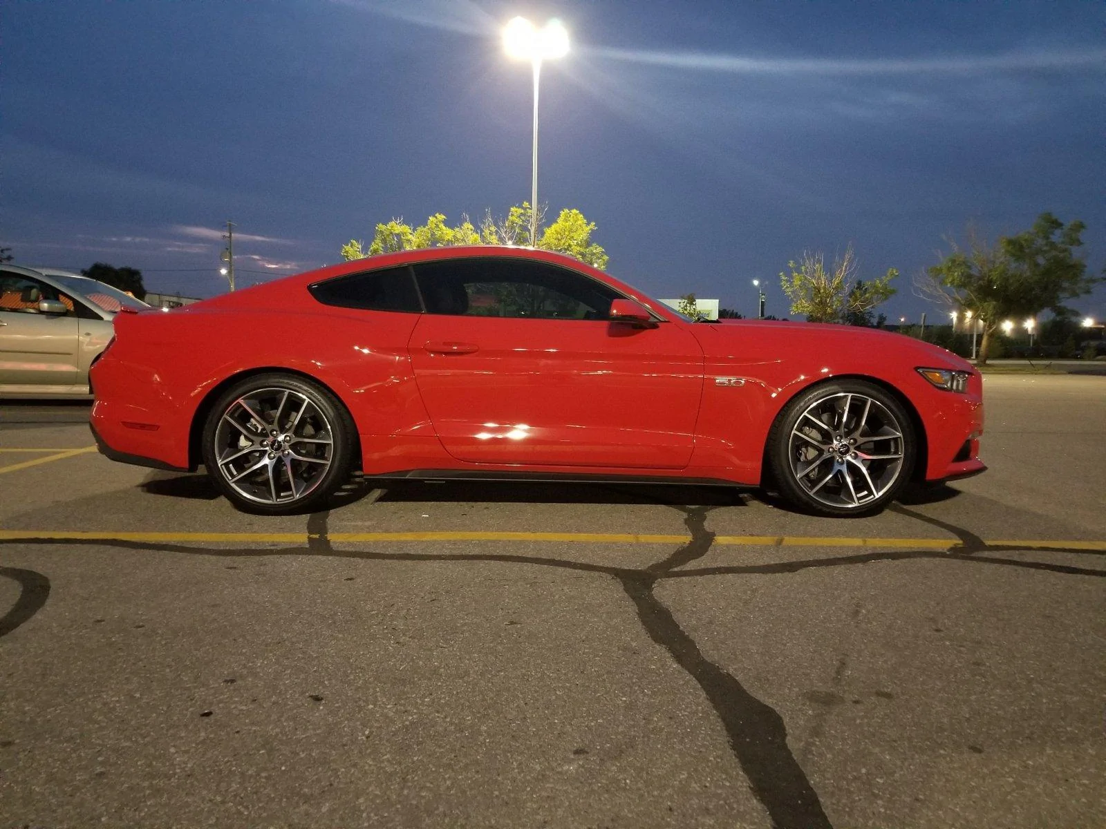

I've got the street handling pack as well as all the other stuff in my sig and the car handles awesome but soaks up shitty roads great too. It's very predictable and easy to steer with the throttle now should you choose to. The floatiness and porpoising of the base suspension doesn't exist anymore. All around the car handles how I believe it should and expect it to in all situations.
It's so much better than the base suspension in every way but doesn't lose much of the comfort aspect, if anything it's more comfortable over bumps as they are more absorbed and controlled now. It looks great too! View attachment 314948
