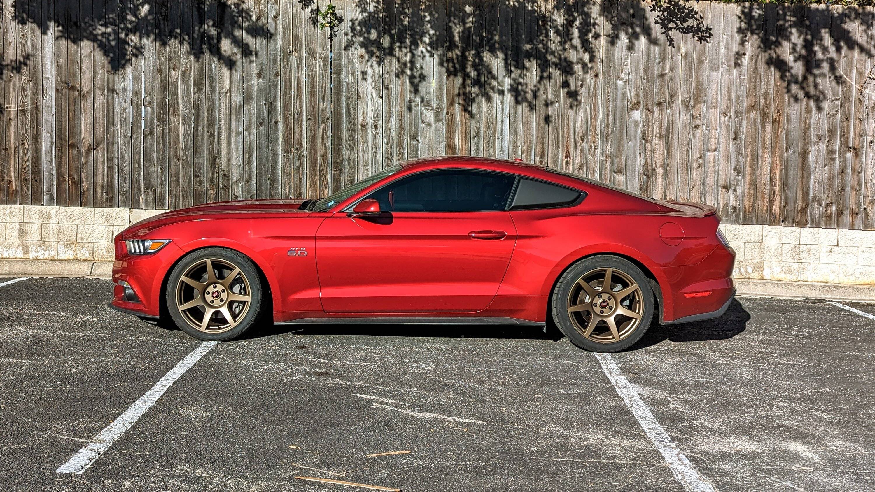

I went with the Track Kit from Ford Performance, its not harsh at all for everyday driving. It is still very compliant and to be frank I think this is the way the car should have came from the factory.

I really like the overall stance of the car. Did you get the kit directly from Ford or through a dealership, how much did it run if you don’t mind divulging. I don’t do much straight line racing anymore but I have a mountain that’s 54 miles up and down. I want to get a really solid suspension set up that I can drive on the road and do this 2 or 3 times a month.

I got it new/used from a forum member. He had it new, sold the Stang and never installed the kit. You can get it from an assortment of vendors here on this board. I obviously didn't pay full price, but I think they run about $1200 now. I chose the Ford Performance kit due to just that, it was a kit designed in conjunction with the other components. I also wanted to keep it all Ford as much as I can. You could have drove that rode with the stock setp, just wouldn't have been as much fun😆

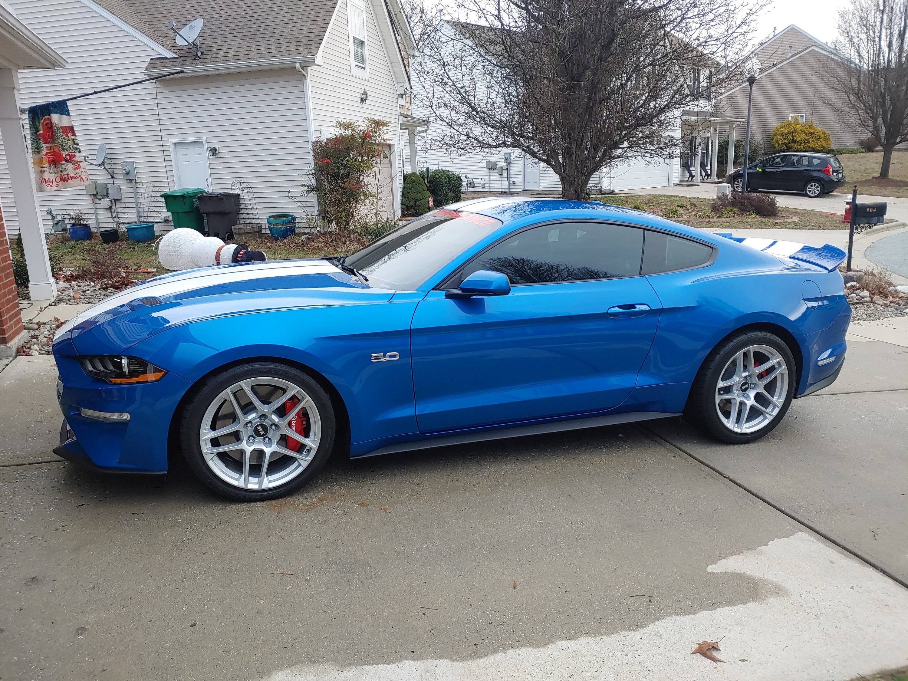

+1 on FP track kit. I purchased a base GT, knowing that I was going to switch everything out. The ride is not to harsh and even has the approval of the wifey! I upgraded the brakes as well with the FP Brembo kit from the Bullit. Another upgrade that transformed the car as well. Good luck with your choice and enjoy the twisties.

I like your taste in wheels!!!
