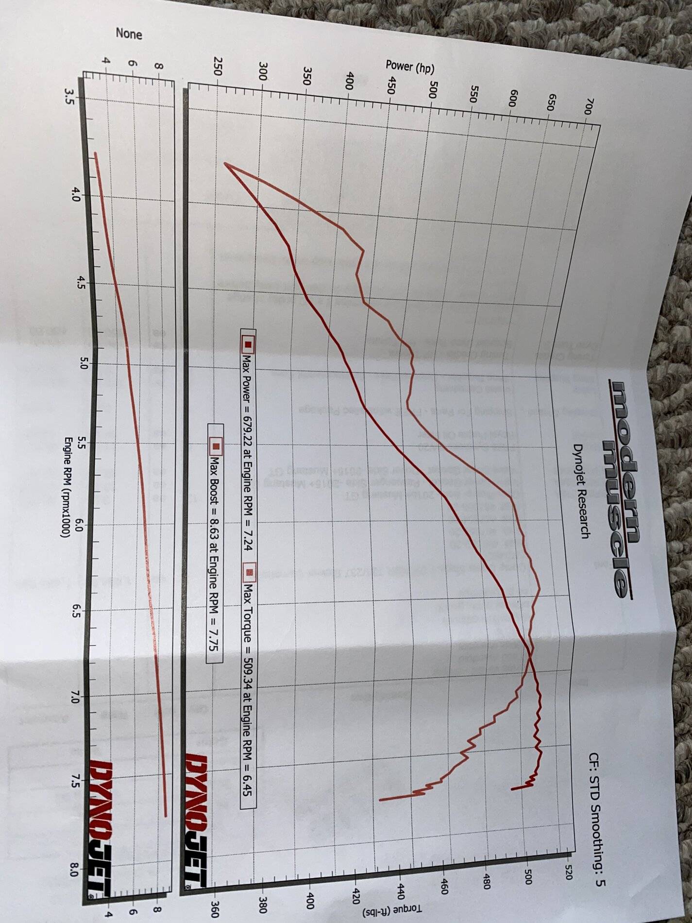

Any hp gains on the dyno from the Ford Performance cam job?
I recently had the Comp Cams put on my mustang and tuned. Was able to get about 40+ rwhp gain which I was impressed with

I can’t find any Ecoboost cams on comp’s website. Can you please share a link? Also would love to see the dyno graph.

Comp cams went on my 2017 Mustang GT 5.0, not an ecoboost.
Heres my dyno sheet if still interested.
-Vortech V3 si
- 1000 cc injectors
- headers
- cat back exhaust
- intake
- upgraded driveshaft
- upgraded oil pump gears
