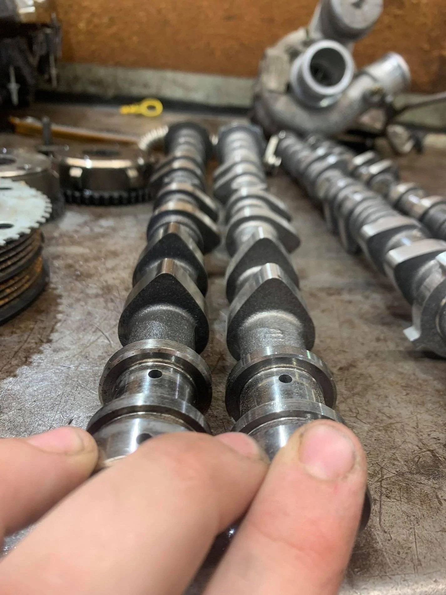

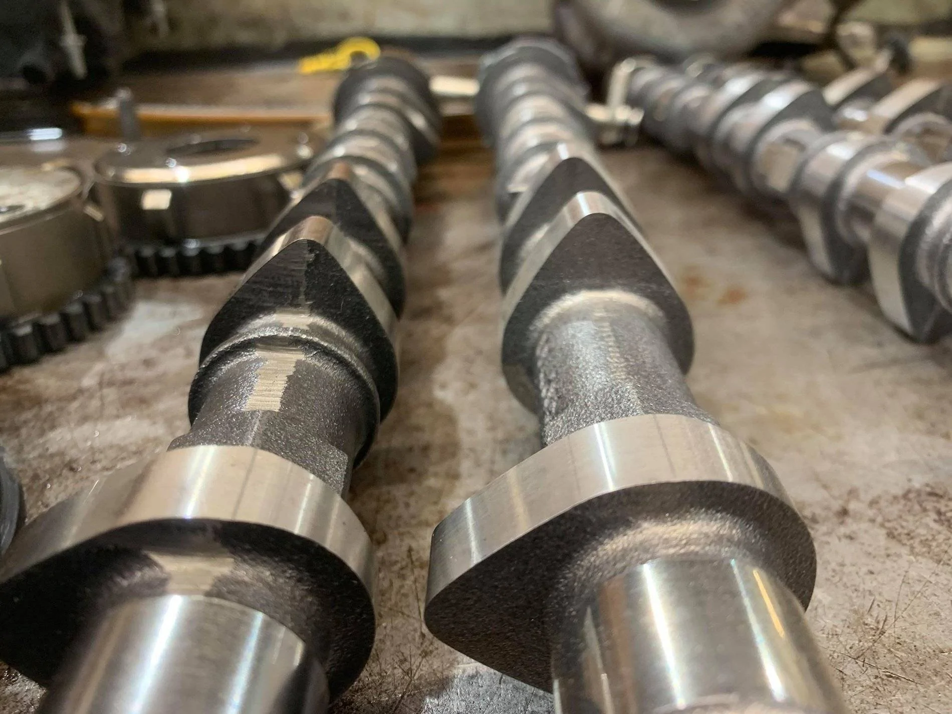

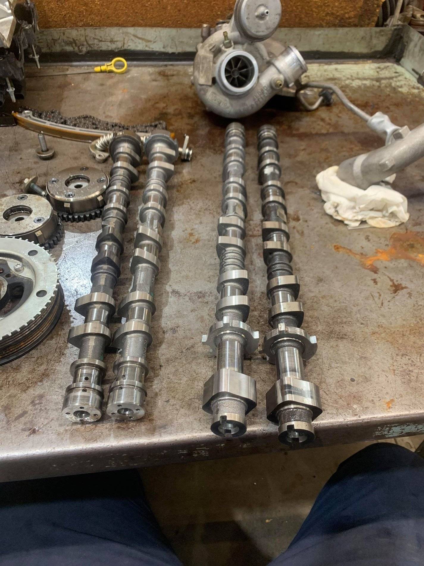

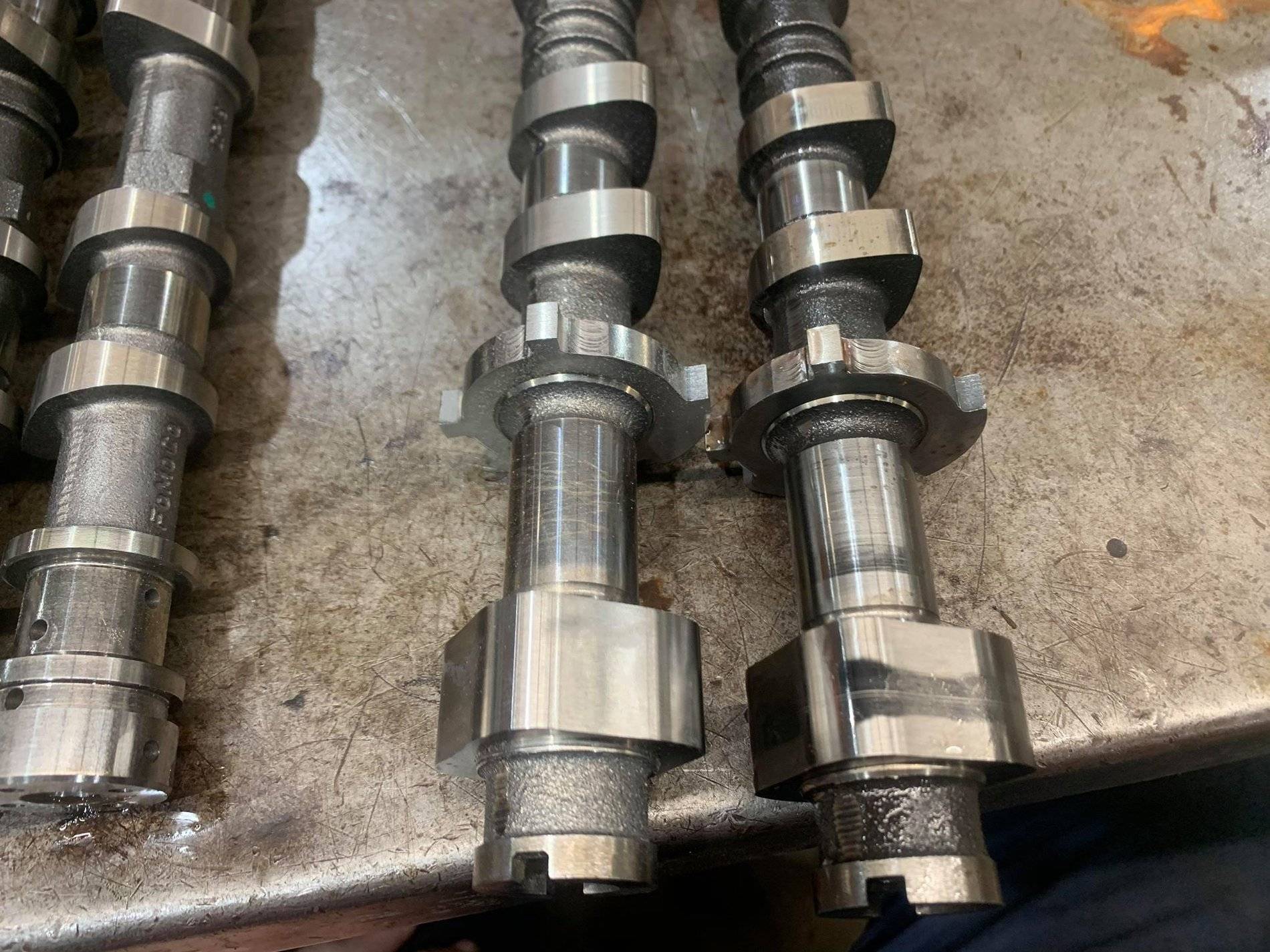

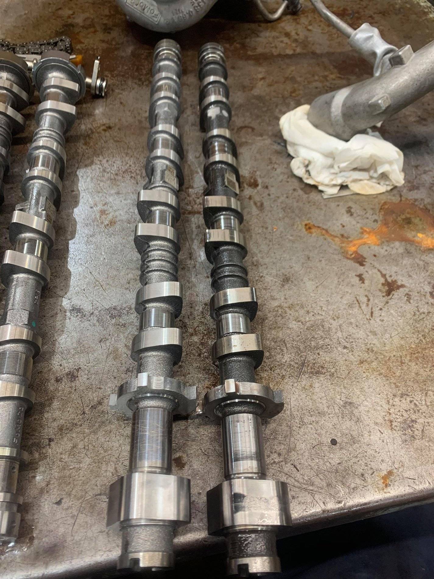

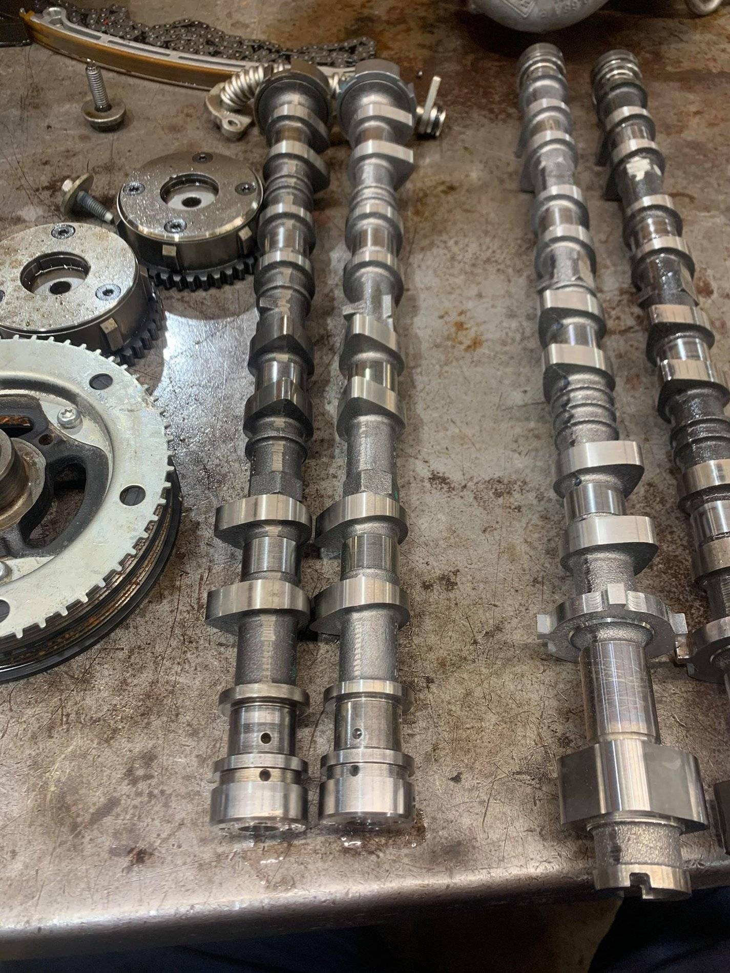

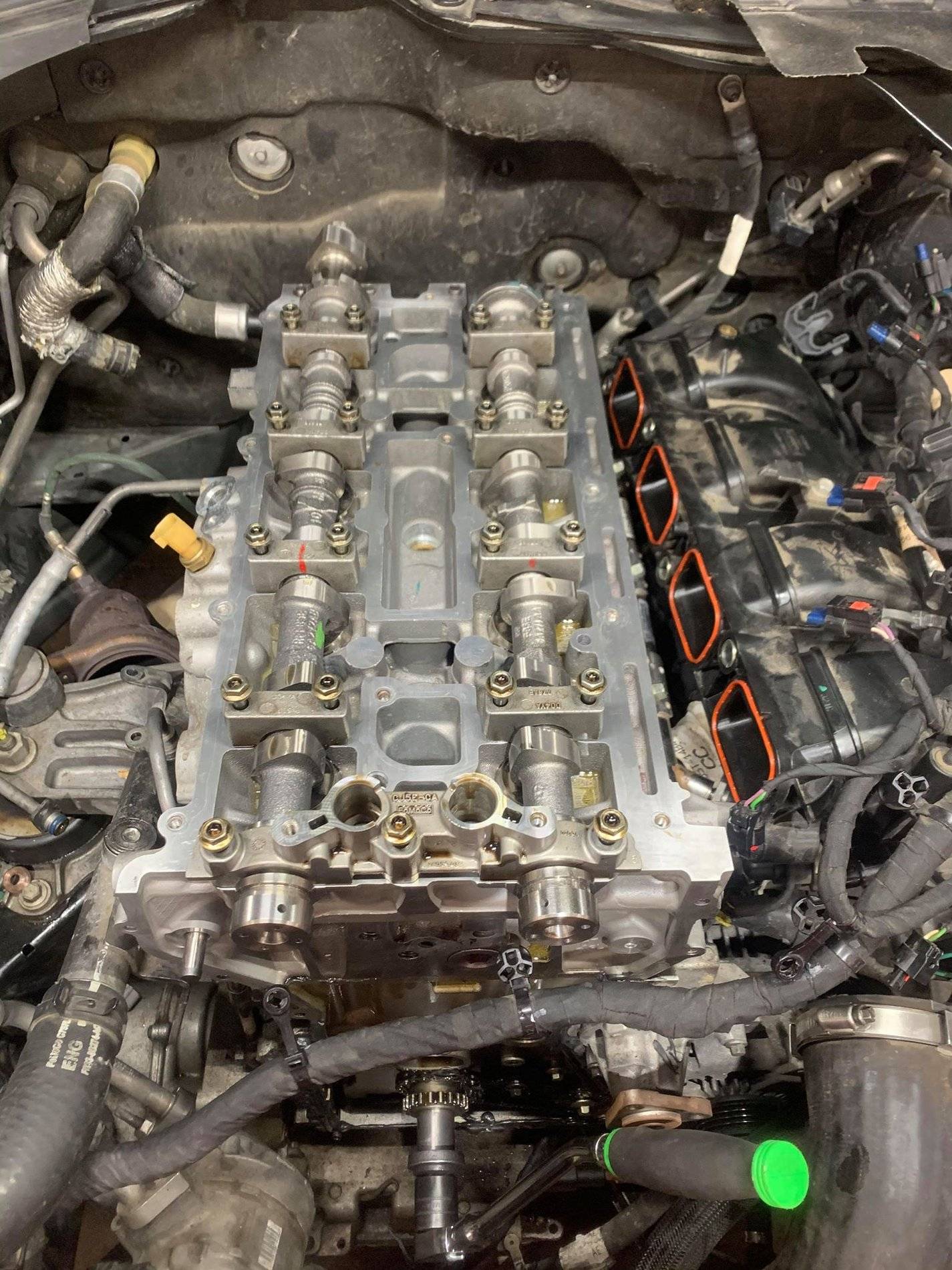

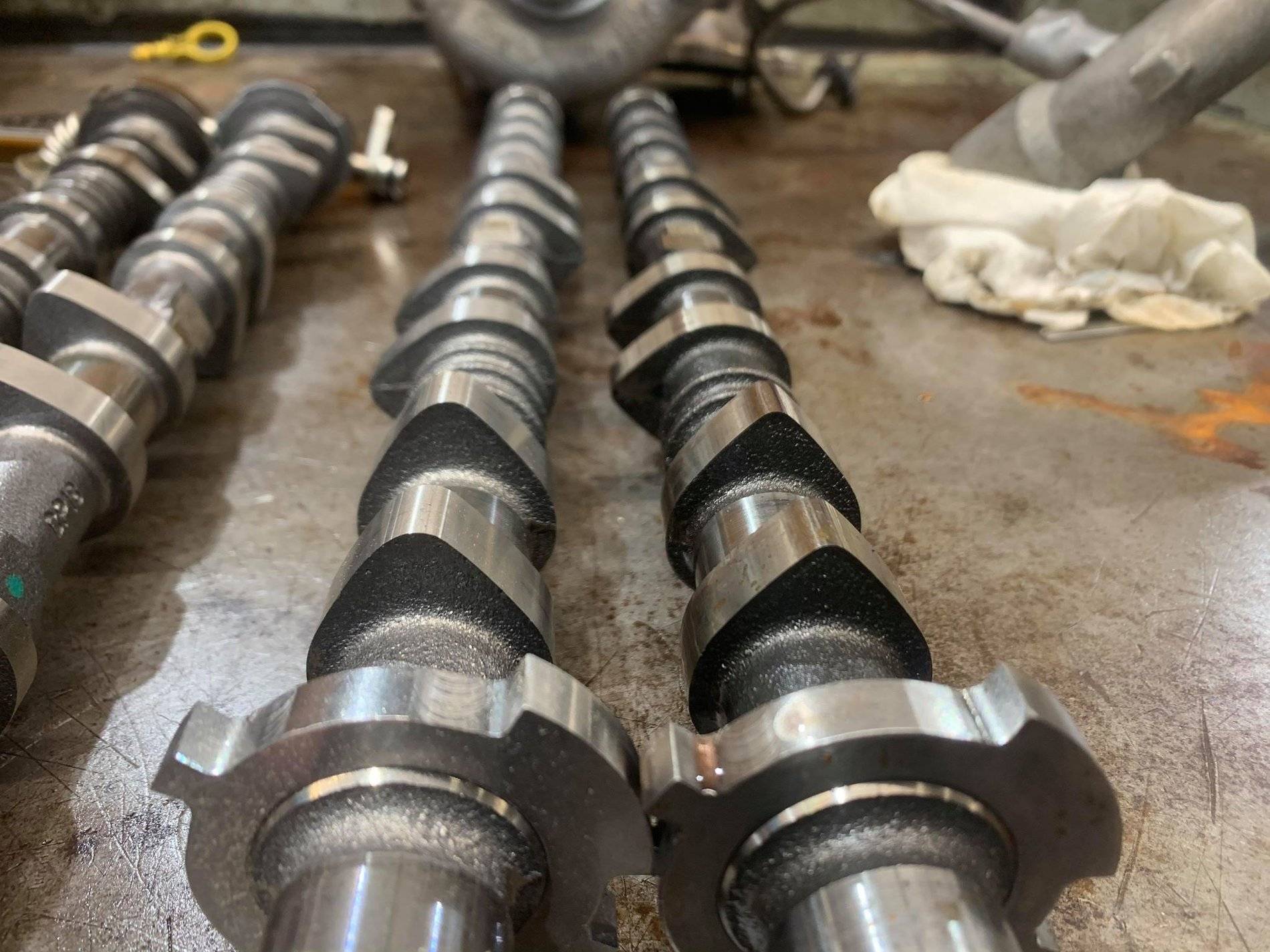

To be honest these are/were not performance cams.... I would say at best they are "Driveability" Cams.. I have yet to get to the dyno tuner to adjust the power band and get rid of some of the timing retard, but I would say the "BUTT" dyno seems to think maybe 5 to 10 peak at MAX, and 20 or 30 hp across the entire curve, shifting the power band right probably 1000 rpm. Car is calculating/estimating crank torque to be between 510-519 vs 515-522 before. No dead spot in power after 5500 anymore, dead spot seems to be right around 6500-6600 (It takes a little getting used to due to the fact I have short-shifted the car its entire life right around 5500-5800, due to the massive fall off of torque and power after. It really does pull and spool way better all the way through. It seems to completely remove the engine as a choke point for air/exhaust flow and throws it completely on the turbo/exhaust's doorstep I imagine the fatter the turbo you get the more you will benefit from cams bigger than this (these are very moderate difference from the stock cams), feels like the car should have came this way from Ford, especially with the stock turbo. I would say it felt like it did before, with my 6' 6" 340lb mechanic, son in his car seat, and about 70 pounds of stuff in the trunk during the first time it was beaten on after 500 miles breakin with the new cams. I will update, with some real data soon...Curious for your impressions. You can see the extra duration quite clearly in a few of those pics!
Refer to the post above... idle is a little varied and rough until the car learned to deal with it (about 30 mileish) No super huge lope, but its there.Hey guys, wanted to see if anyone had put these on their car and had a review as far as what to expect sound and performance wise.
They sound a little different at idle, but that might be the exhaust. Honestly, I think an HPP sounds like one of these at idle.I wonder if the new HPP mustang has these cams from the factory?

Thanks for your thorough review and the tech images! Does the car need any tuning after installing the Ford Performance cams - or are those designed as “plug-n-play”?
Curious, could this be done with the HPP?To be honest these are/were not performance cams.... I would say at best they are "Driveability" Cams.. I have yet to get to the dyno tuner to adjust the power band and get rid of some of the timing retard, but I would say the "BUTT" dyno seems to think maybe 5 to 10 peak at MAX, and 20 or 30 hp across the entire curve, shifting the power band right probably 1000 rpm. Car is calculating/estimating crank torque to be between 510-519 vs 515-522 before. No dead spot in power after 5500 anymore, dead spot seems to be right around 6500-6600 (It takes a little getting used to due to the fact I have short-shifted the car its entire life right around 5500-5800, due to the massive fall off of torque and power after. It really does pull and spool way better all the way through. It seems to completely remove the engine as a choke point for air/exhaust flow and throws it completely on the turbo/exhaust's doorstep I imagine the fatter the turbo you get the more you will benefit from cams bigger than this (these are very moderate difference from the stock cams), feels like the car should have came this way from Ford, especially with the stock turbo. I would say it felt like it did before, with my 6' 6" 340lb mechanic, son in his car seat, and about 70 pounds of stuff in the trunk during the first time it was beaten on after 500 miles breakin with the new cams. I will update, with some real data soon...
