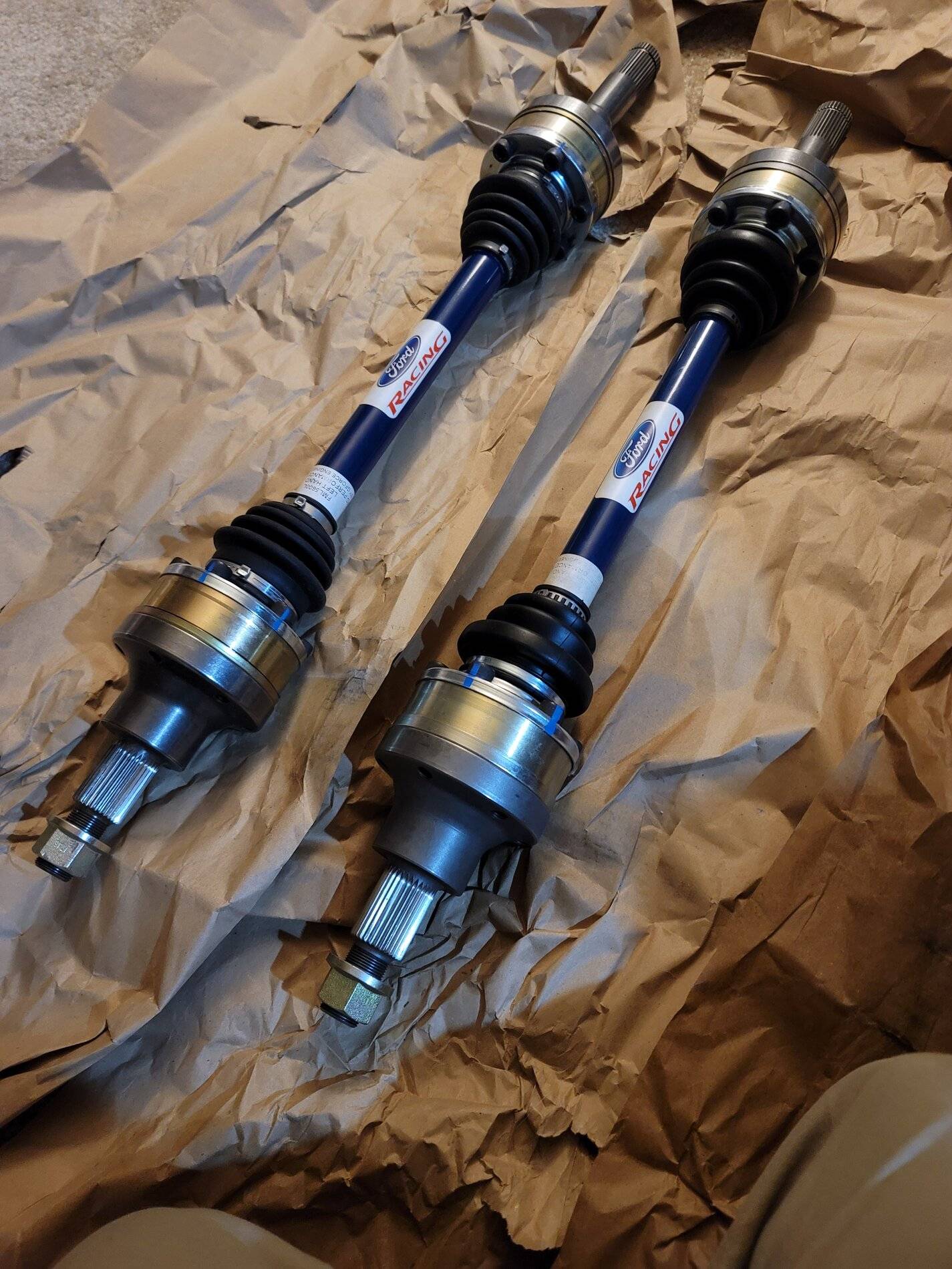

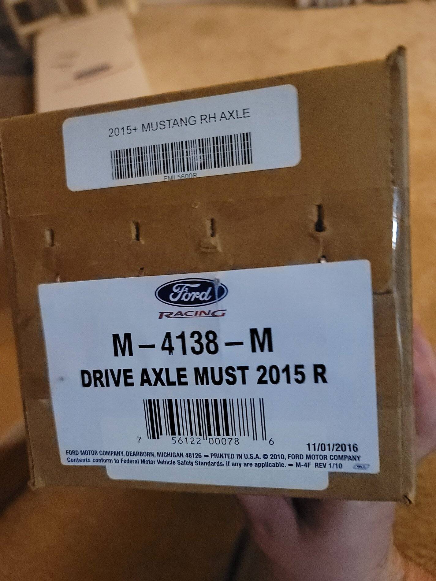

I ordered the $999 half shafts from the Ford Performance link I posted. They are indeed GForce Engineering parts labeled as "Ford Racing" and not "Ford Performance". The part numbers are the same as the more expensive versions just without the "A" at the end. Cheapest GForce half shafts I have found by far.
