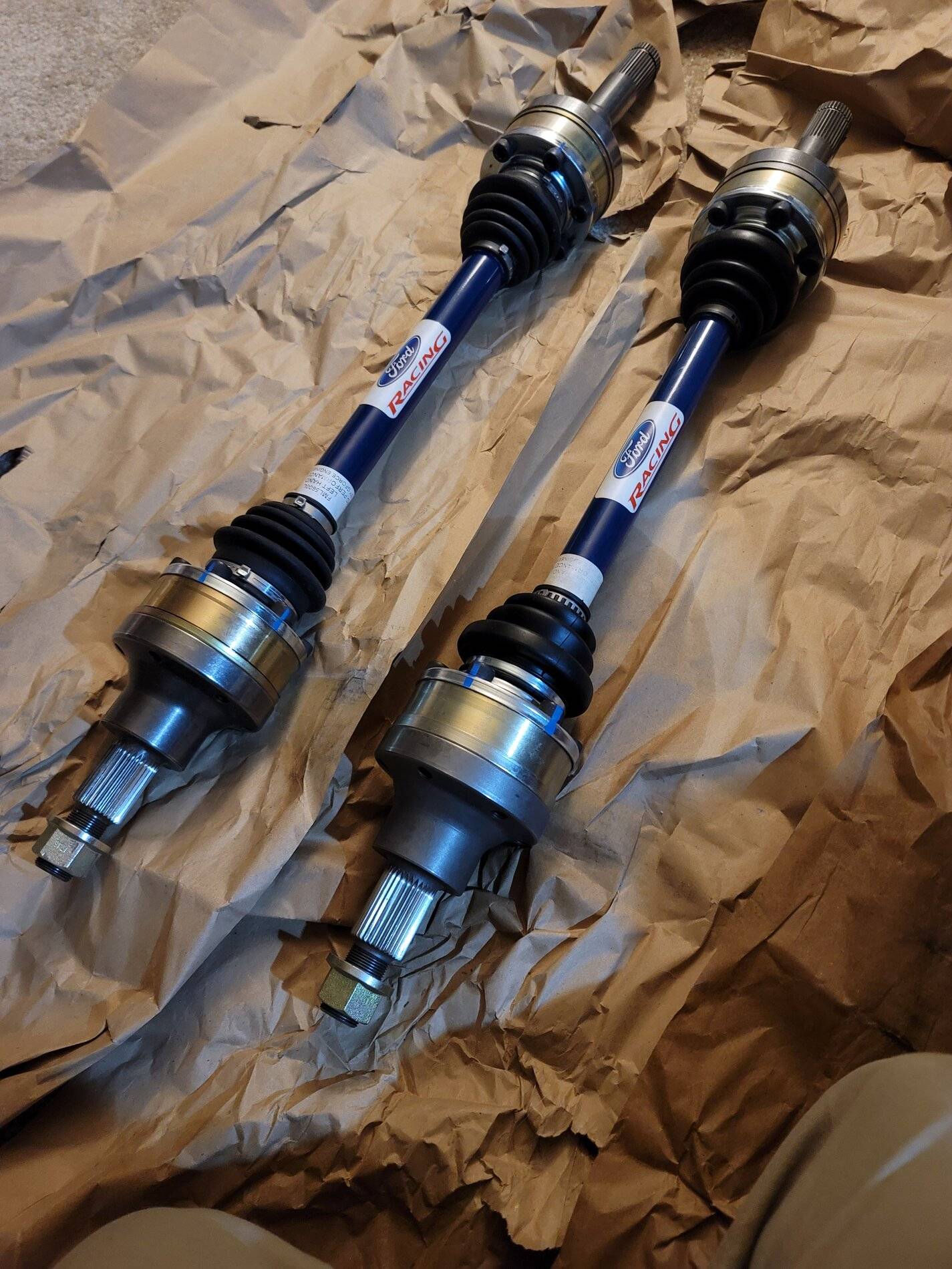

So basically what you’re saying is I was off by 50hp. The point of my original answer was the Ford performance ones aren’t rebadged renegades. They aren’t rebadged outlaws either. They have 34 spline cv joints while both renegade and outlaws have 31 splined joints which translates to less strong. They are better than both. This was intentional and it’s why Gforce upgraded their old versions. Lethal performance confirmed this too when checked. This answer takes very little research. The msrp and sale price through Gforce has the ford performance as $400 more than the outlaws. There’s a reason for that. Even though they can be had cheaper. The renegades while also an expensive half shaft are almost $1k less. Call Gforce you’ll get the answer yourself. They’re open until 5pm (316) 260-8433. There’s really no debate.Incorrect. Gforce discontinued those 850hp rated axles in 2019. See the press release here:
https://gforce1320.com/gforce-releases-all-new-line-up-with-the-renegade-axles/
The new Renegades are basically the old Outlaw axles as the Outlaws were given an upgrade as well.
Correct! Plenty strong for 99% of the setups.
