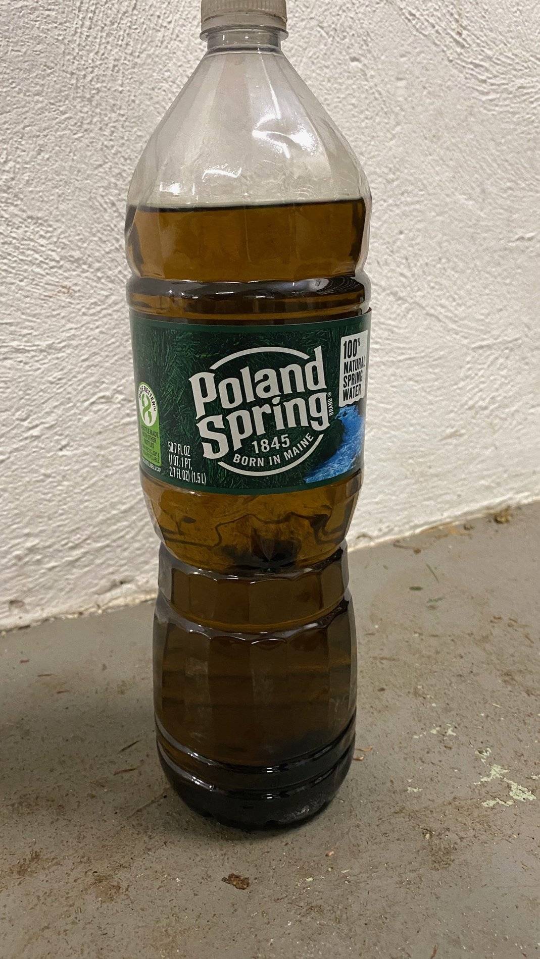

Attaching a picture of the brake fluid I got out. You can see I took out 1.5 liters (took 3 full bottles of new fluid and a tiny amount more from 4th bottle). JAJ's instructions on how many pedal strokes each side takes was extremely useful especially for first time doing this. I probably didnt need to do it to this extent (the rear ones were probably 6-7 strokes extra and fronts were 1-2 extra). You can see the amount of black dirt that came out, remember this was stock fluid as filled in the factory precisely 4 years ago (my car was 2nd week of september production in 2016).
