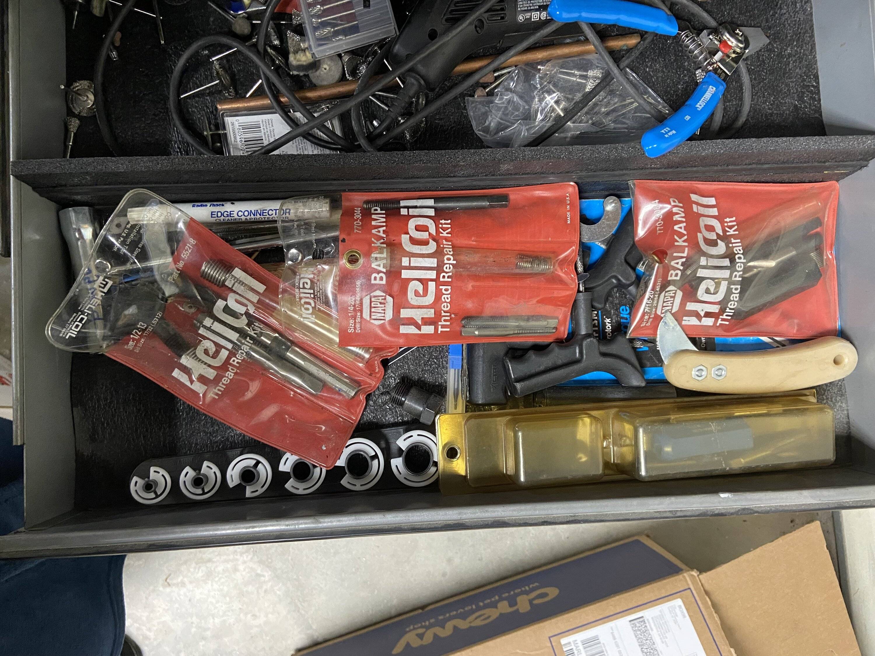

LOL. Smart phone they say.... I'm leaving it cause helicopter coils are way cooler than heli coils all day long.
Damn right they are! Ordering some tonight.

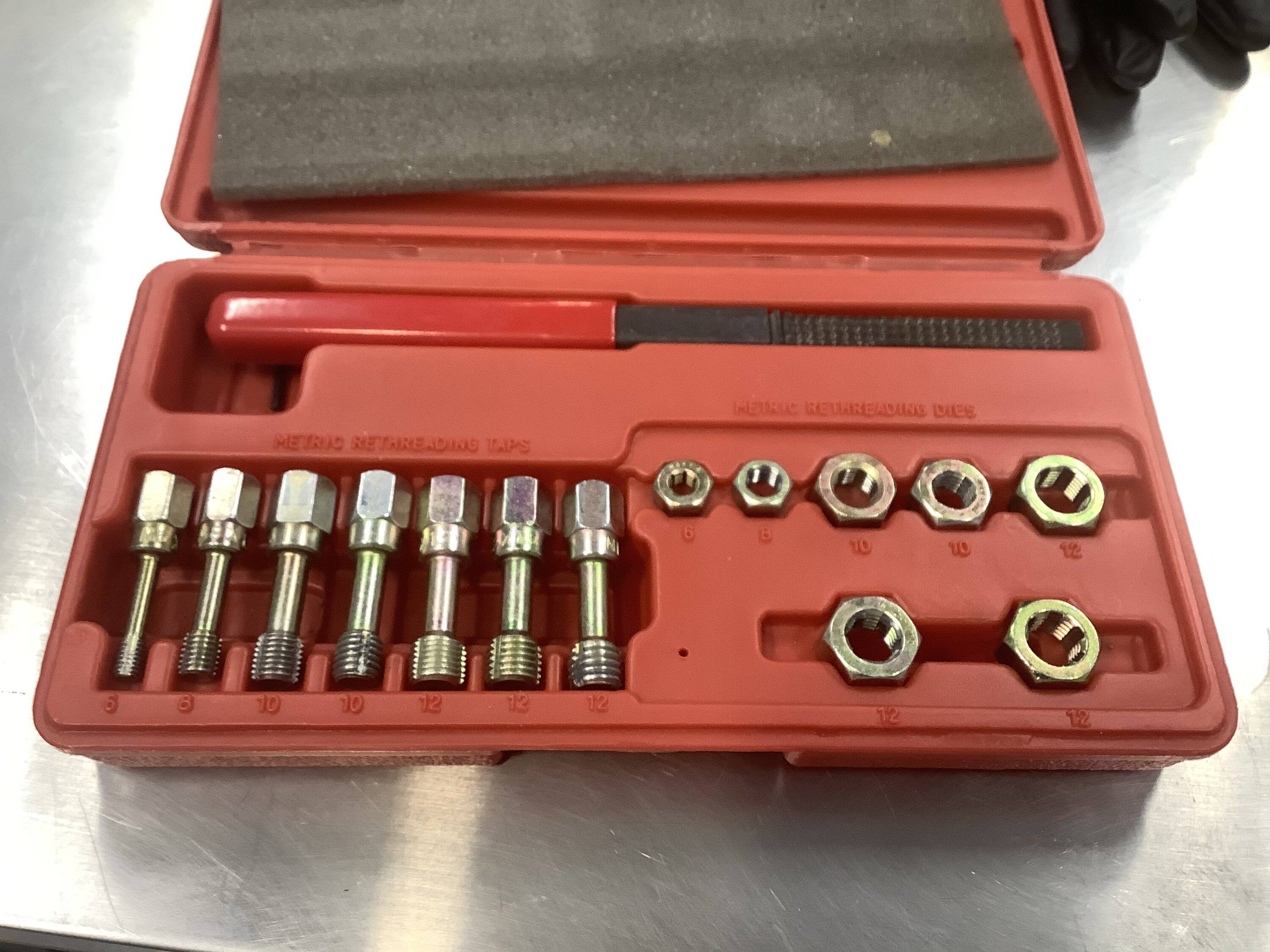

I used this thread chaser kit on my crank before installing new bolts for the flywheel. Just as Cobra Jet said, I could very easily screw the new bolts in by hand afterward.
I‘ve used this method for years on just about every threaded hole or bolt that I use in a project, especially if loctite was used on the bolt. It cleans out all of the residual loctite and makes sure the threads are ready to receive the hardware without issue.
