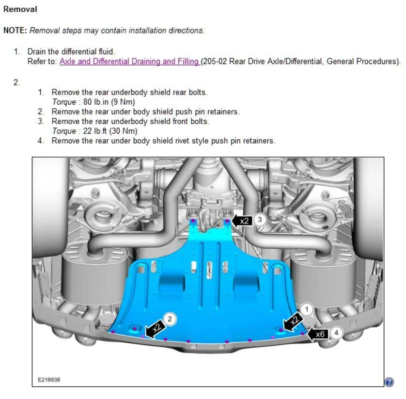

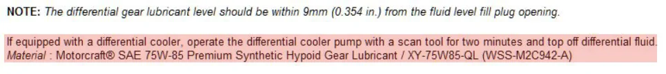

I like to disassemble things.
The dealership service department has said they needed to reach out to Ford Engineering for the proceedure as the shop manuals have nothing listed.
Direct from the factory service manual. Your dealer needs to read more carefully.
This is the flush procedure.
205-02 Rear Drive Axle/Differential
General Procedures
Thanks for this.... Can't believe a web forum has the answer. I need a new dealer to handle warranty issues.
General Procedures
In giving some thought to your reply ... I believe the flush instructions you posted are to make sure to get out all the old fluid for a general service and NOT a flush to make certain any metal contaminants are left deposited in the cooler.
This brings me back to my concern -- metal remaining in the old cooler. I may or may not have mentioned the BMW factory instructions if a differential has been toasted on one of their cars is mandatory replacement of the cooler as well. They will allow a flushing of the lines, but that's it.
