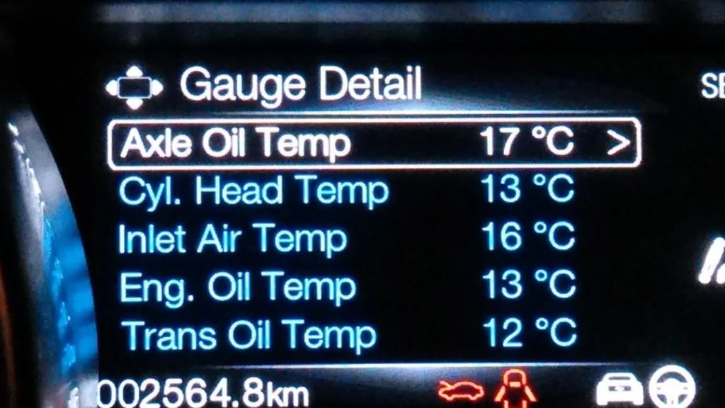

I have the differential sensor monitoring the temp...I have not threaded it into the diff yet, so as you can see the temp is the ambient temp of my garage.
Excellent [MENTION=23475]KevDog[/MENTION]! Wish my garage was 17 C :lol:
You need to live in a warmer climate :)

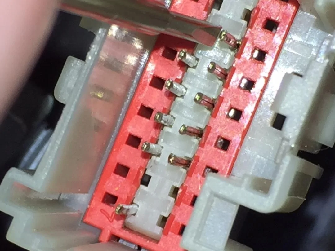

For any of you who have done the wiring for the diff temp gauge only and made the mistake of removing the small red pin alignment piece while adding the two wires in the 264 connector, got any hints on getting it back in ? Getting all of those tiny pins lined up with those tiny holes is a real pain ! if you plan to do this, taking the precaution of not moving that piece past the existing pins (there is an intermediate lock but it still will move easily) will save you a lot of grief !!! Once I get through this, I will add info to this thread for noobs like me on getting this done.
Look more closely at the female side... the pins don't go through the holes in the lock they go into the divots on the sides of the red lock.

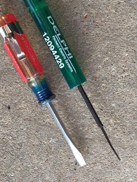

Did it a few times. It is a pita. With some patience it's workable.
Start by making sure all the pins are in their sockets and not too far into the connector. The lock prevents them from backing out. However, without the red piece in, there is nothing to prevent them from going further in.
Install the red piece gently as far as it will go until it just touches one pin. The pins will be at varying positions because nothing is holding them in place. Use something like the pin removal tool to gently pull the pin that's touching toward the center of the connector to clear the red piece while gently pushing the red piece a little further in. Try to get as many of the pins to clear at a time as you can; doesn't have to be one at a time.
Keep working this process until all the pins are clear of the red piece and it slides the rest of the way in. It is very tedious and frustrating. You may have to restart a few times. Like you said, keeping it at the intermediate position is recommended.

OMG, I have been trying to get them through the holes !!! No wonder I have been so stymied. I am sure it is still not going to be easy but it would have to be easier than putting them in the wrong place !!! Many thanks to both of you !
I know the feeling... trust me... lol. After the practice you've had trying to line them up to slip through the holes it'll go together easy now.
