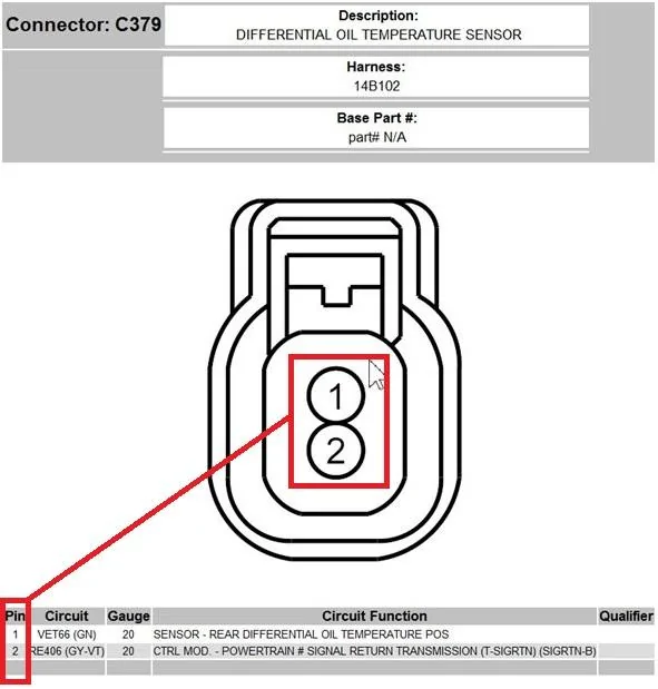

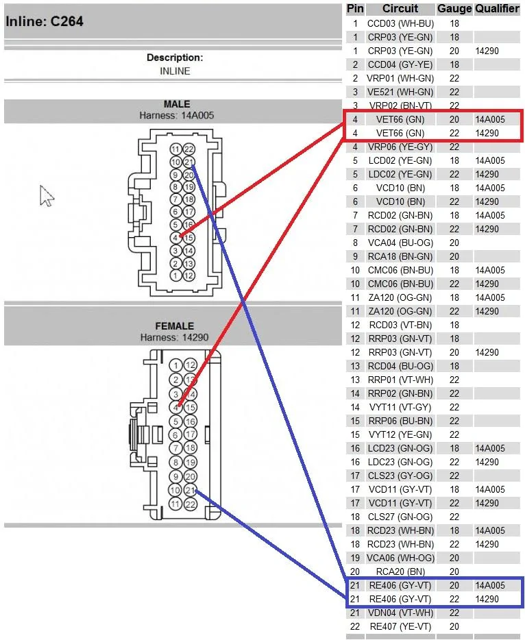

Well, finally got back to this and, yes, getting it back together was much easier than trying to line up 20 small pins with 20 exceedingly small holes, lol. But now that the plug is al back together and I am pretty much ready to do a test, I noticed a discrepancy in the pics I would love to have someone clarify. Maybe I am looking at it incorrectly but the picture that KevDog posted on page 12 has the wires connected opposite of the diagram cking posted on page 10. Is that right ? If so, which is correct ? Since Kev had to “color” the wire white, and the plug looks upside down (top green wire on the plug should go to the green wire on C264 in the cking diagram), I am thinking the picture is not correct. After all this, I do not want to screw this up !

rb92gt’s drawing on page 12 looks like it agrees with diagram on pg 10.
KevDog
Apr 22, 2016
35
30
British Columbia
2016 Shelby GT350, 2004 F150 FX4
I wouldn't rely on my diagram, it was intended as a quick visual (the plug could be upside down) See rb92gt drawn diagram (Page 12) to match the pins with wires. 1 into 4 and 2 into 21.
