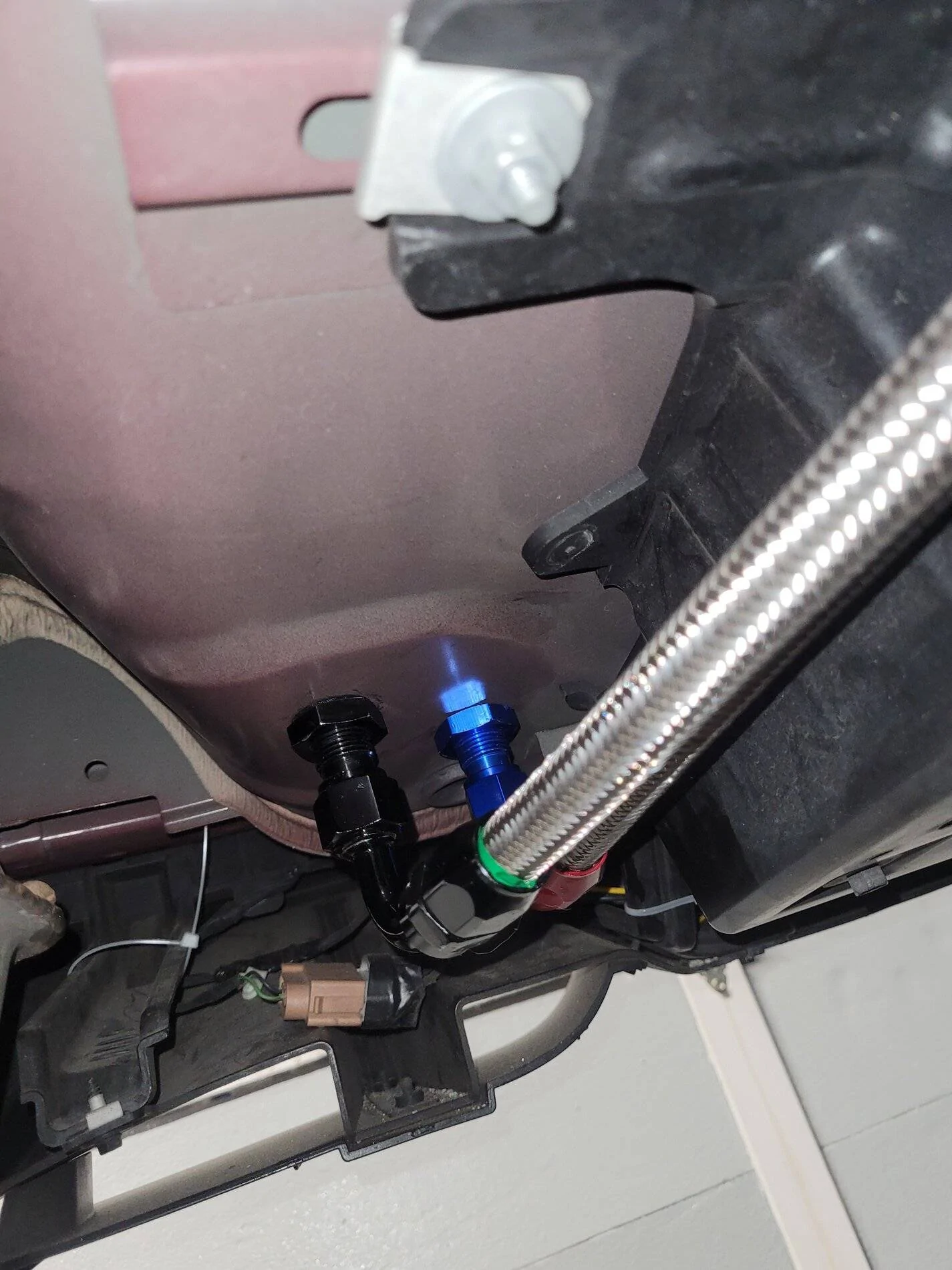

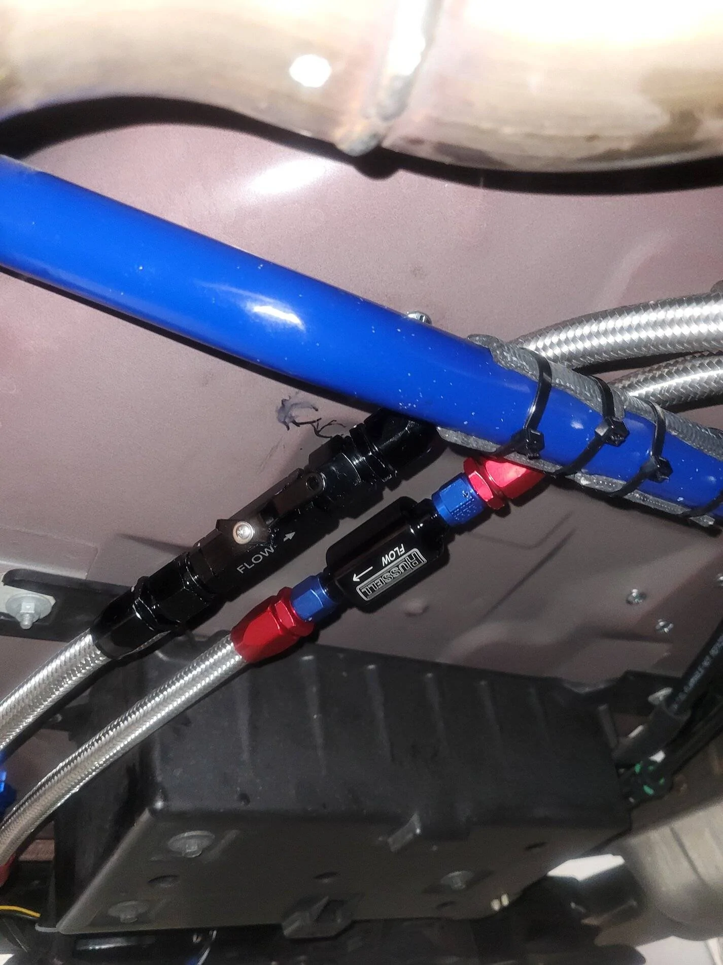

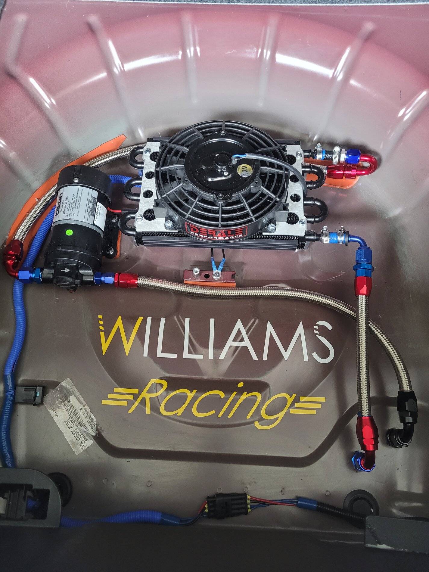

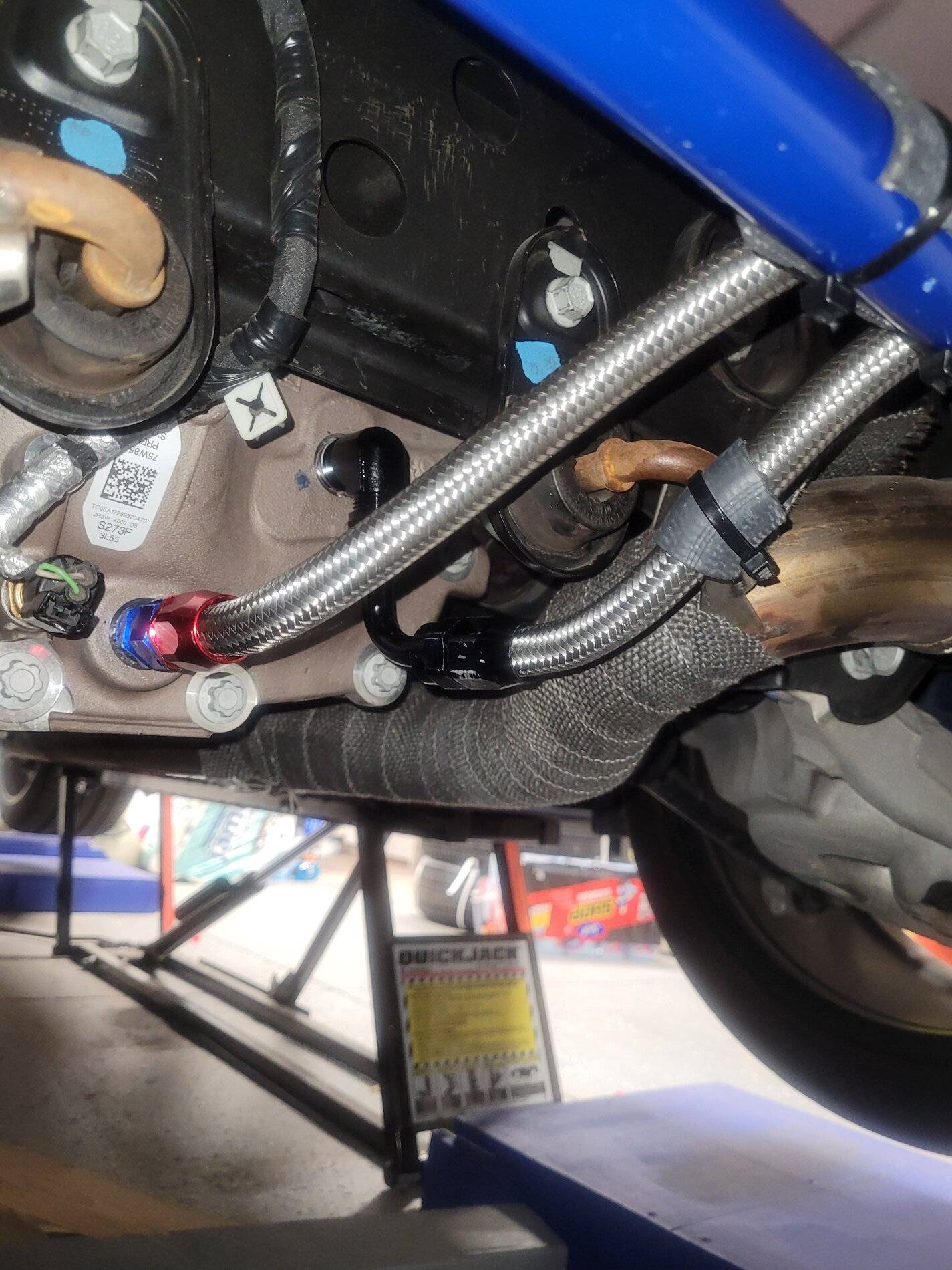

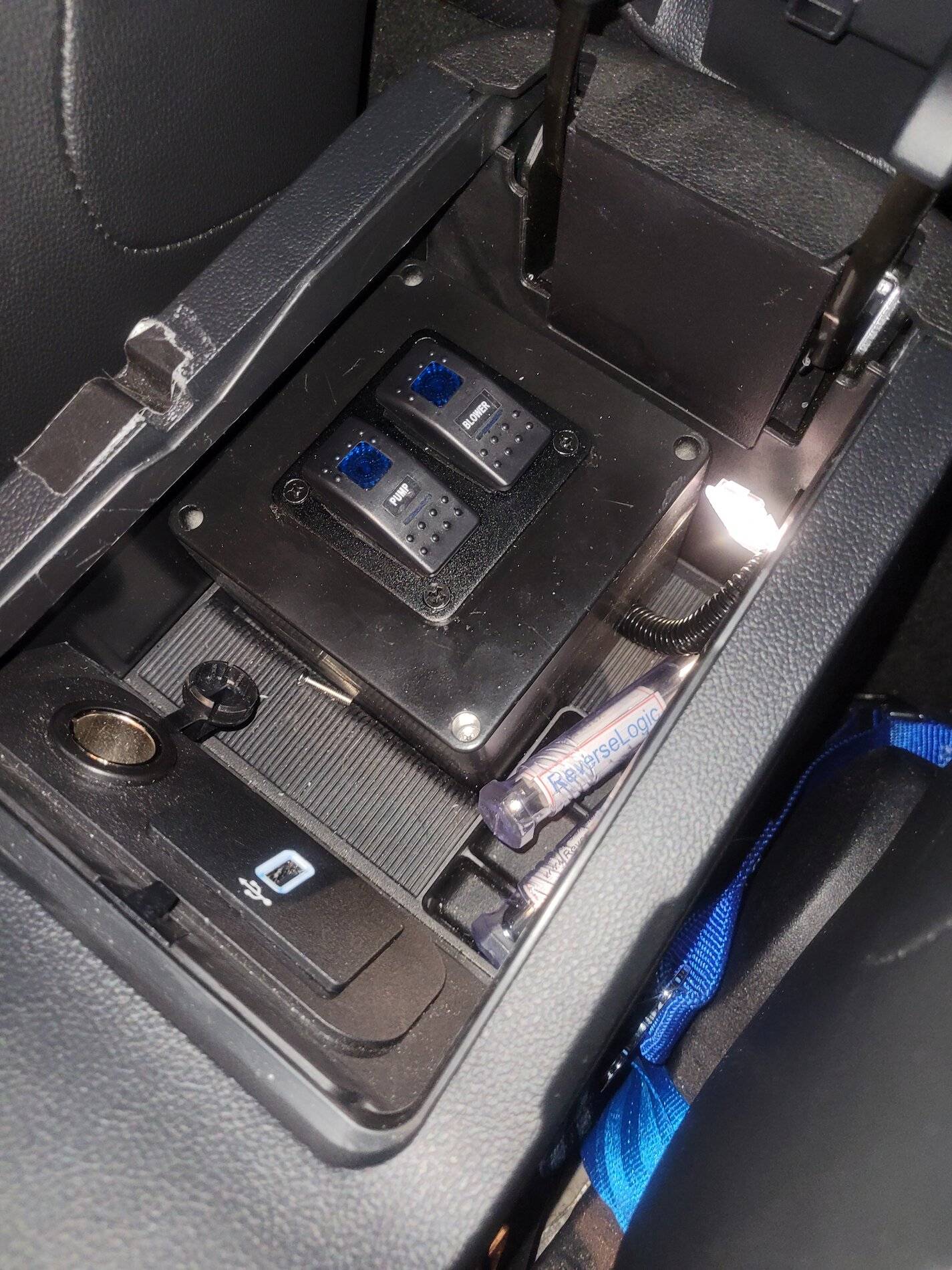

I have this posted in a DIY but figured I would post here in this section because it is kind of a aftermarket diff cooler I guess.
