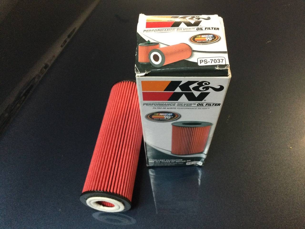

I only use the K&N filter:
Works fine.

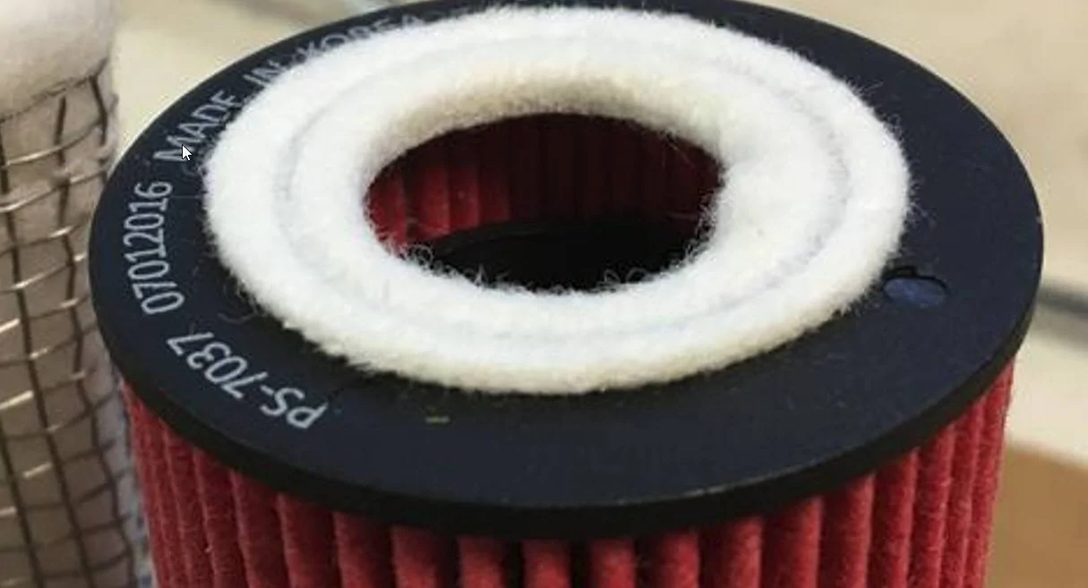

Does the K&N oil filter PS-7037 have a medal sleeve inside like the FL-2087 oil filter?
If you search K&N’s website they don’t list any oil filters for the GT500. If I had to guess it’s because they don’t have the metal sleeve.

looks like it might have some plastic reinforcement inside like the AMsoil, hard to tell from that picture
I'm thinking Ford did metal for a reason, and I would't bet my engine on it.
It has a plastic liner. But the filter itself is some kind of hard material, not paper. Probably doesn’t need a liner.
This is the only filter I have used in my GT500 and it seems to work fine.
Just changed again Saturday and the filter looks straight and firm.
