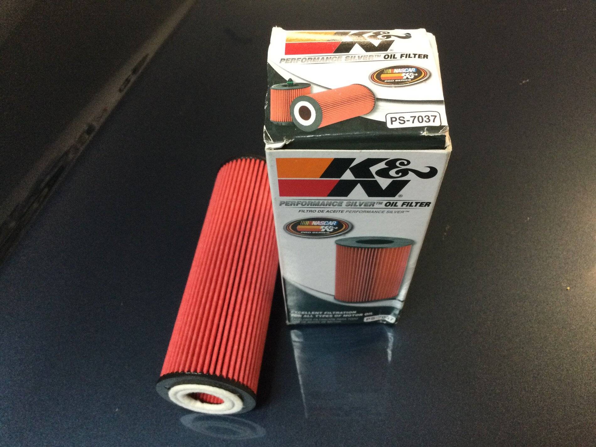

good morning. for a recent gt500, the fl-2087 must be used. because it is metallically reinforced inside. the oil pressure is such that otherwise the filter is crushed. I have little information but that I understood.
That’s one of those rumors that won’t die.
I use the K&N filter with zero issues.
Cedric
Apr 28, 2022
France
Franco
Shelby gt500 year 2020
on a recent gt500? the filter does not crush? or deformation?
