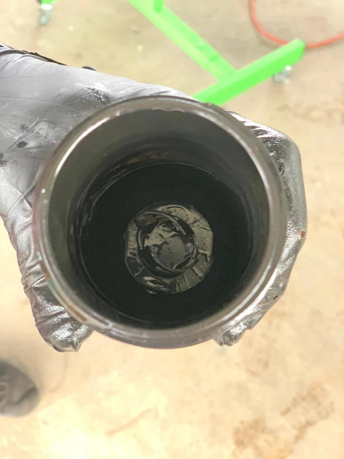

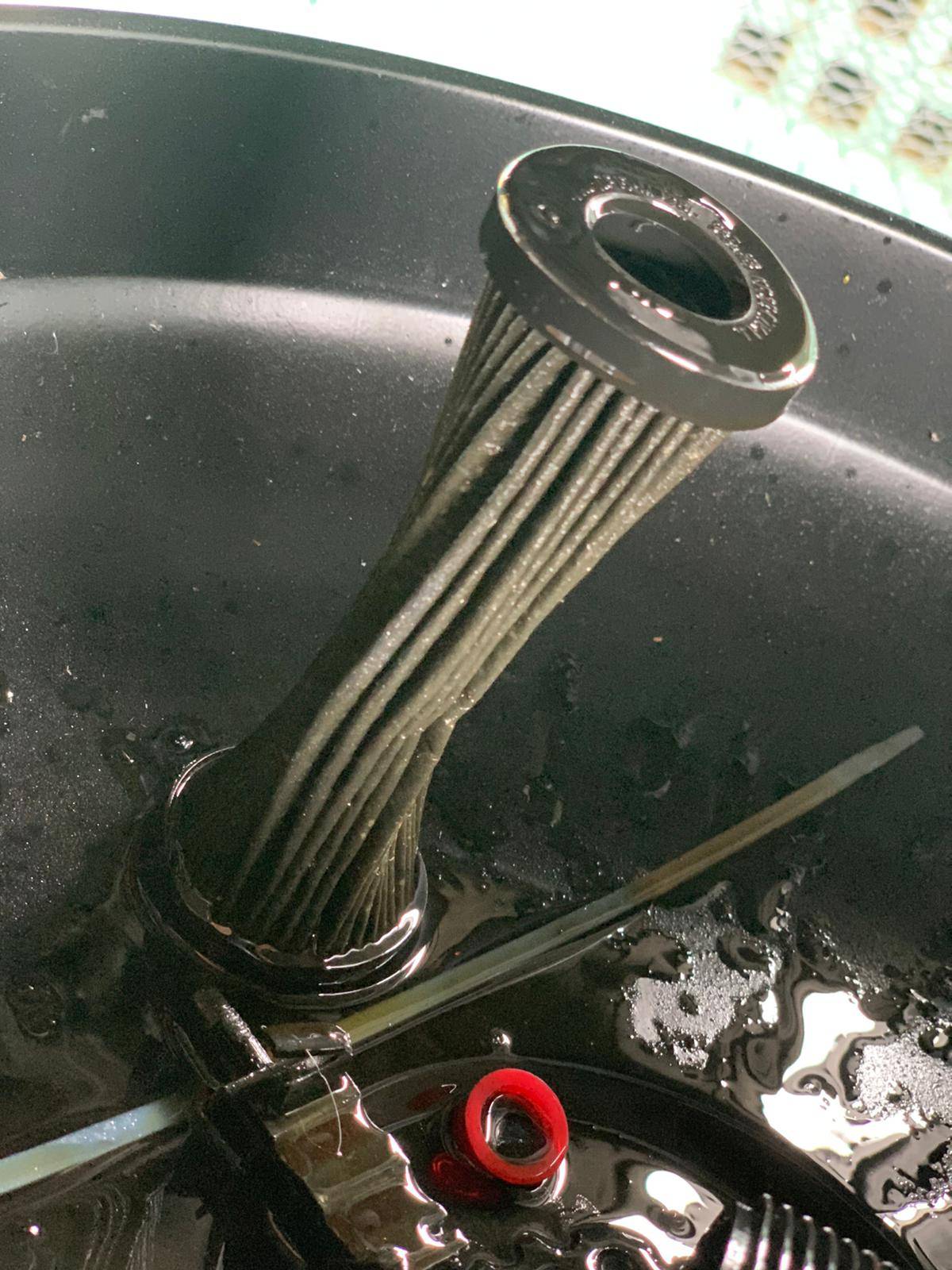

This is the pix making the rounds, and it was twisted and crunched as it was installed incorrectly, not collapsed:
You can see the internal mounting was crunched where the filter was to go:

Photos were in posts in this forum (GT500). I tried a search but came up empty. I recall filters shaped like an hour glass - clearly did not have the metal support inside.

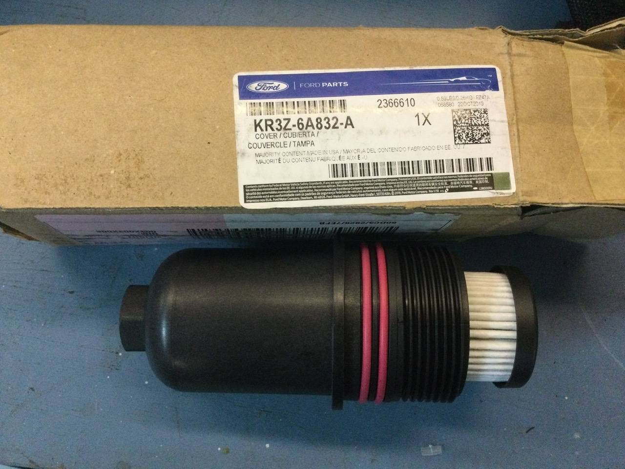

Another option to consider: Engine Oil Filter Cover - KR3Z-6A832-A.
When some found that their filter had been installed improperly and damaged the housing, many of us ordered this part to have a spare housing on hand. Happens to come with a filter:
Looks like ~$60 on the internet.

Picked up a couple spares for when I’m able to order my 2022.
