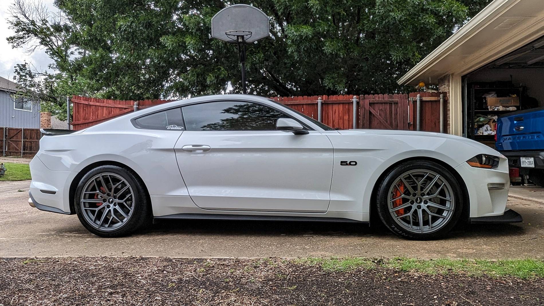

Yes. I run 275/40 all around on 19x9.5 +33 and the fit is fine.
I’m looking at this same setup, but learning now maybe 275/35 is not enough sidewall… how are the 275 in the back for traction? You ever wish you would’ve went with a wheel that properly fits more rubber? Or anything else in hindsight you would’ve done different?
And the car looks nice btw

Enough sidewall for looks… I still need to compare with 285/35 and 275/40, all on 9.5. So far 275/35 doesn’t look bad but I want to look at all the options. Knowing it did well on track helps, thanks.

You're not running any spacers on here right?
No. The wheel offset of +33 was a good fit without them. That's an old pic, lol. I now run 19x10 +37 with 285/35 all around.
