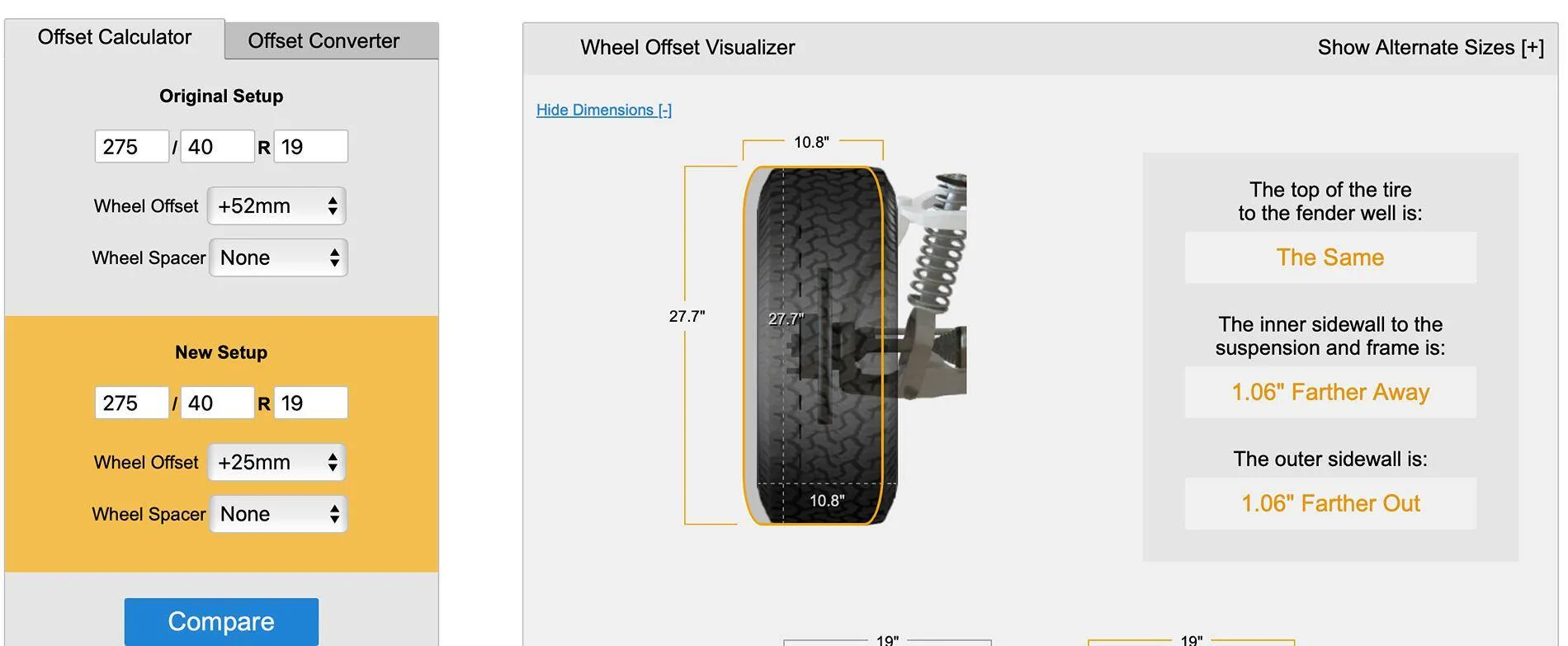

275/40/19 on 9.5 +25 offset

Will this work with a square set up? Currently stock base GT suspension and wheels, but do want to lower it.

It will poke out... a lot. Stock PP rear wheel has a +52.5 mm offset so that's over a 1" difference.

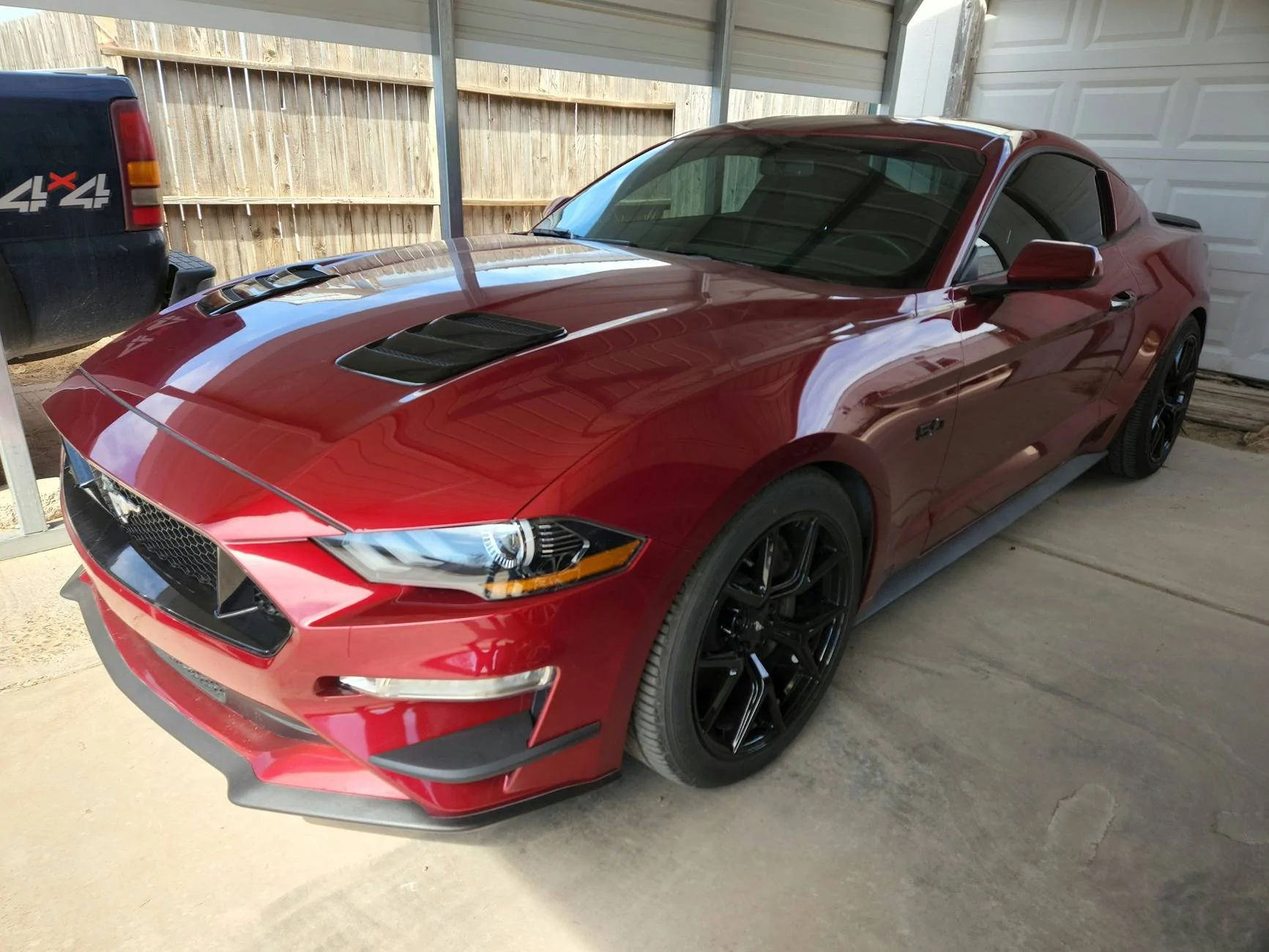

The lmr pp2 wheels I have are +35 offset as you can see in the Pic below they barely tuck. At +25 they will poke 1 in more than mine.

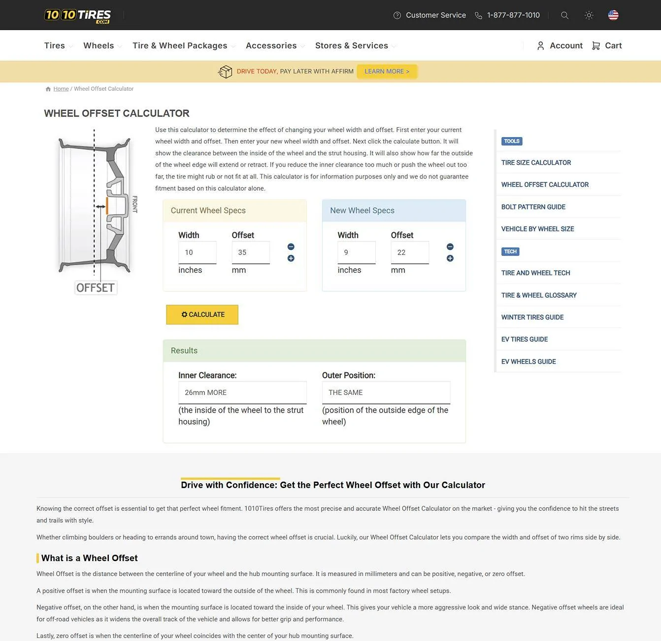

That's not how it works, offset is based on the mounting surface of the wheel in relation to it's center line so width does not come into play.
I understand how it works. But if you care to use some of the online offset calculators you'll see that the width of the rim does affect the fitment. You can compare them yourself. on a 10" wheel with +35 offset will sit further out than a 9" wheel with the offset of +35. And the reason for it, is that the centerline of a 10" wheel to the face of the wheel is 5" and respectively for the 9" wheel is 4.5" distance centerline to the face of the wheel. So in order to get the 9" wheel to sit exactly where 10" wide wheel with an offset of +35 sit, You'll need a +22mm offset on the 9" wide wheel.
Long story short, we are saying the same thing, which is, OP's specs will definitely poke out in the rear. For the front, from my own experience you have 5mm extra offset than the rear to sit flush without rubbing or even using camber plates or bolts.
Width absolutely does factor in when considering where the wheel face and inside edge will end up.
I concur with both of you its about 4mm of poke on the rear, but should be fine for most people on the front.

The outer face of the wheel will stick out further on a wider wheel but the outside of the tire mounted to it (if size is kept exactly the same) will sit in the exact same location was the point I was making. That's what will rub, not the wheel.
Point taken. But… the tread width doesnt change (much) but the tire bead and sidewall are mounted to that wider width wheel so the cross section of the tire at it’s widest point grows with the wider wheel almost 1-1, and often thats what rubs first.
