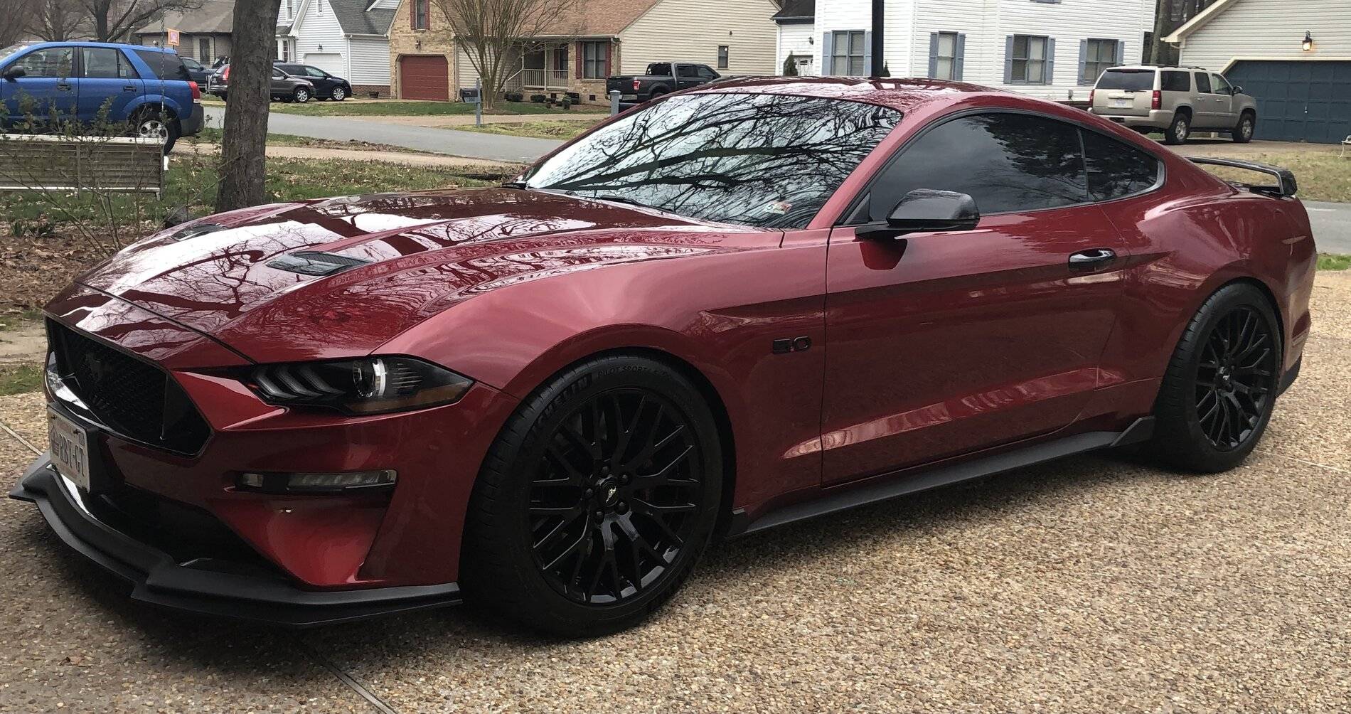

PP1 rears 25mm spacers 275-40s on all 4 corners with BMR minimum drop springs. I like the PP1 wheels so that’s why I didn’t buy aftermarket wheels

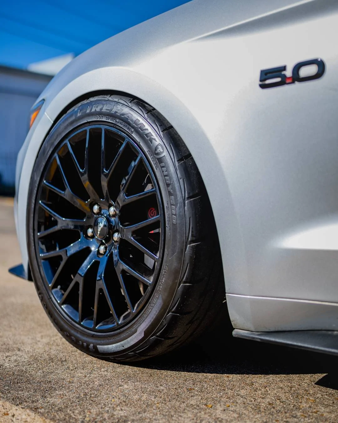

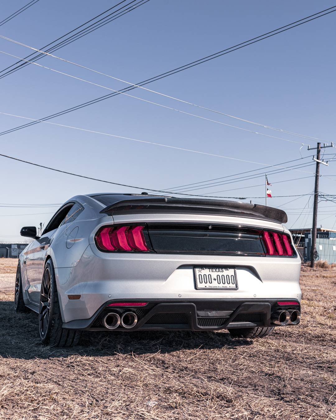

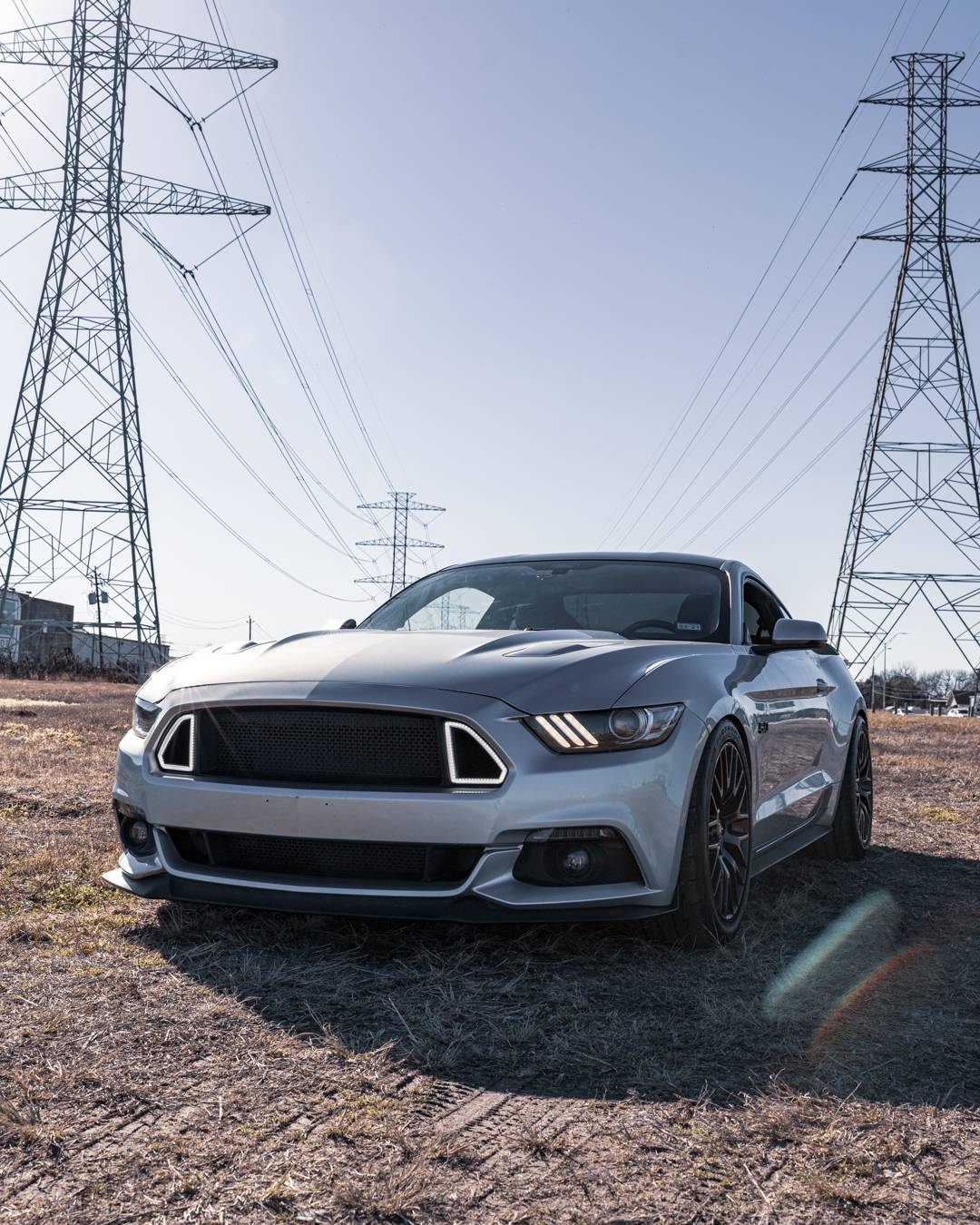

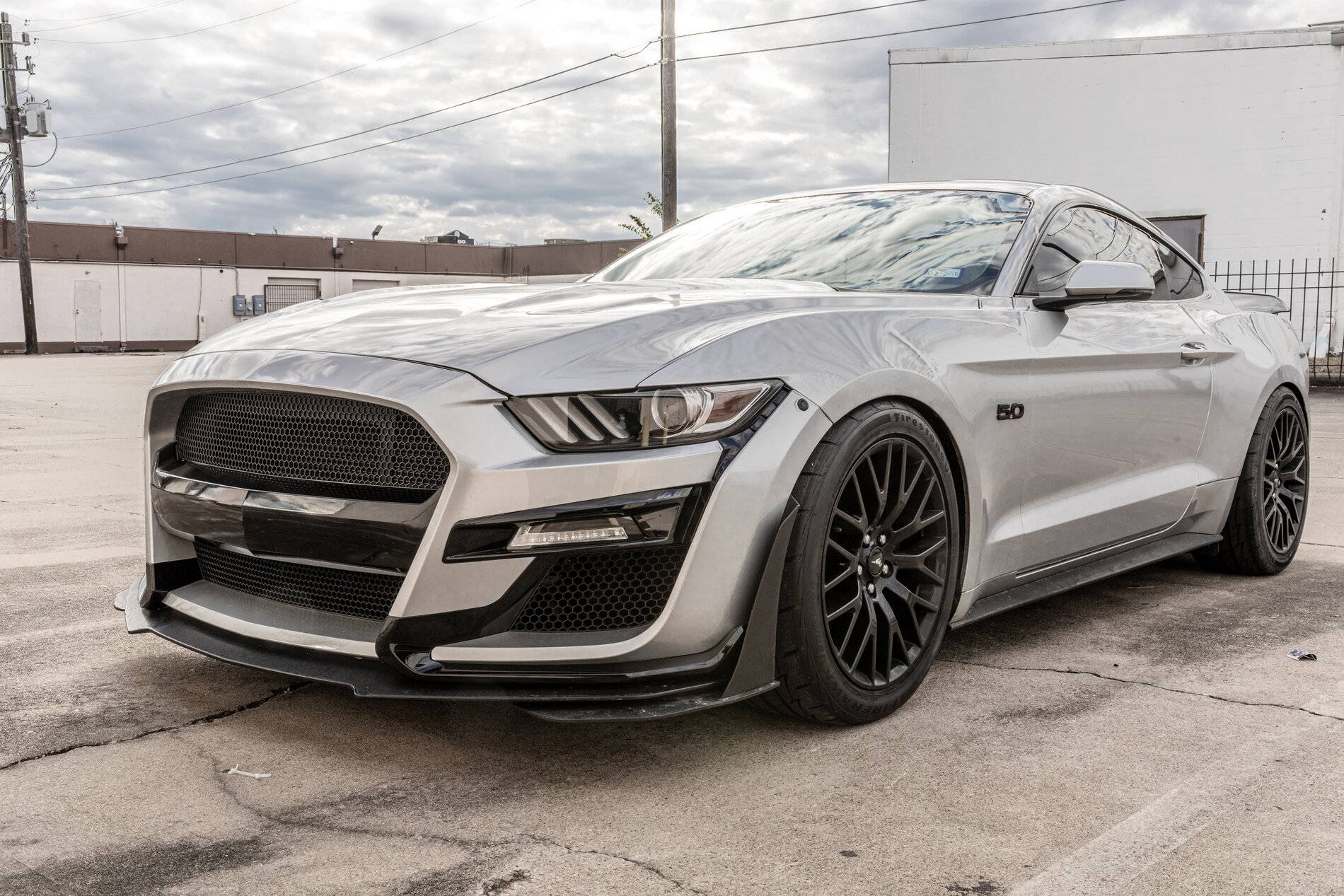

I run this exact setup on my car. Just got someone’s rear pp wheels and sold him my fronts so I run a squared rear pp setup with a 5 mm spacer in front

Depends on the wheels. if you are using rear pp wheels then yes. They would hit the strut I believe without them. But just a 5 mm spacer gives enough room and can still use stock studs

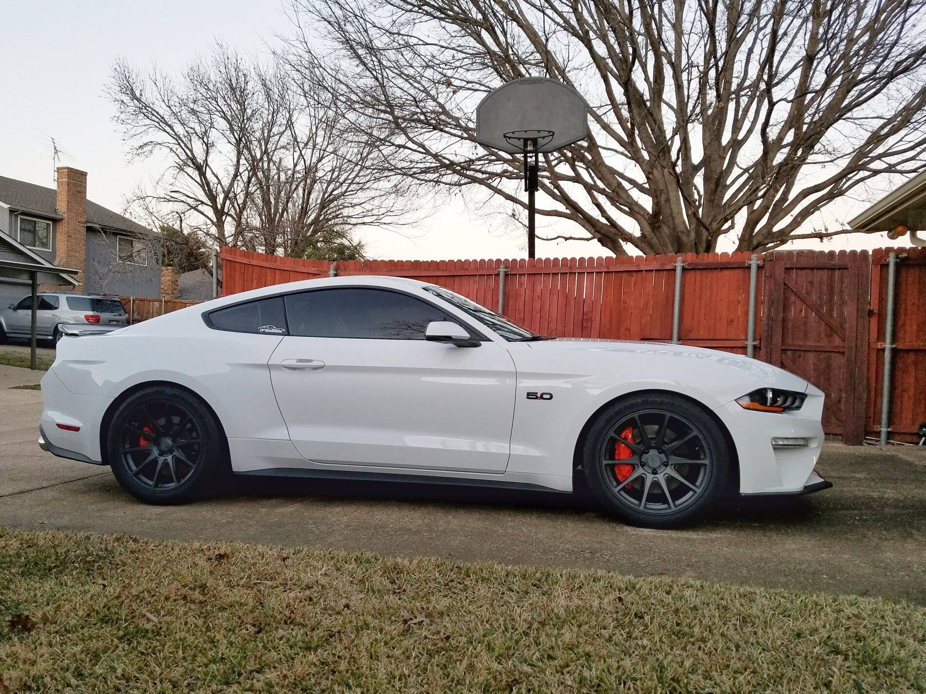

Yes. I run 275/40 all around on 19x9.5 +33 and the fit is fine.
