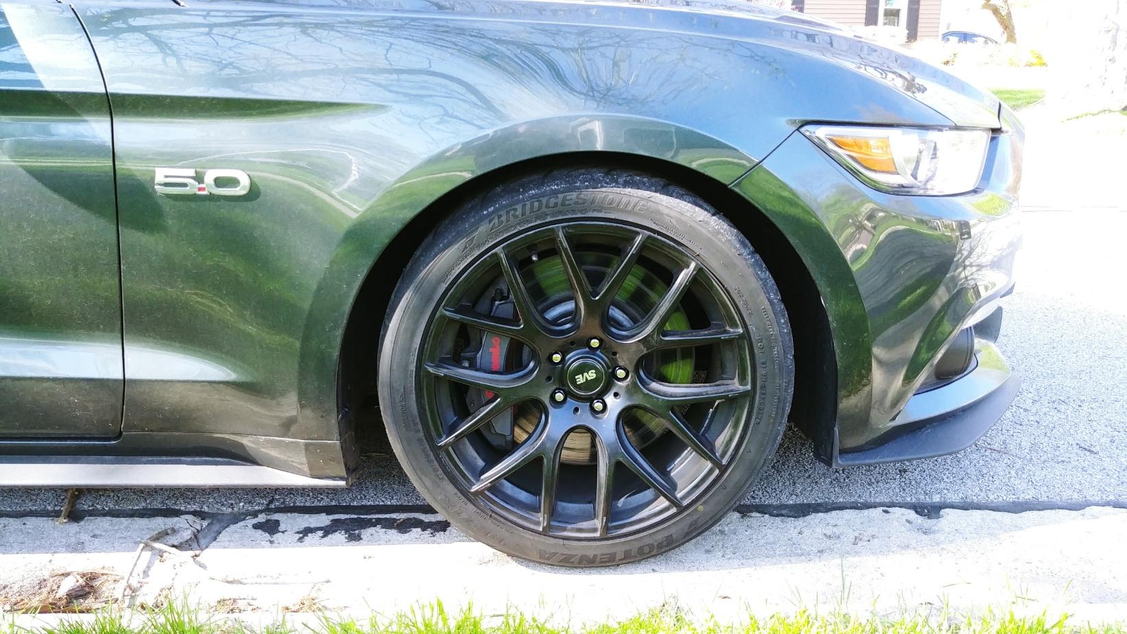

275/35R19 is fine if you're lowered and does not look 4x4 at all. Both my sets of wheels (DD and track) have this size tire. The front of my car is lowered less than 0.7".
