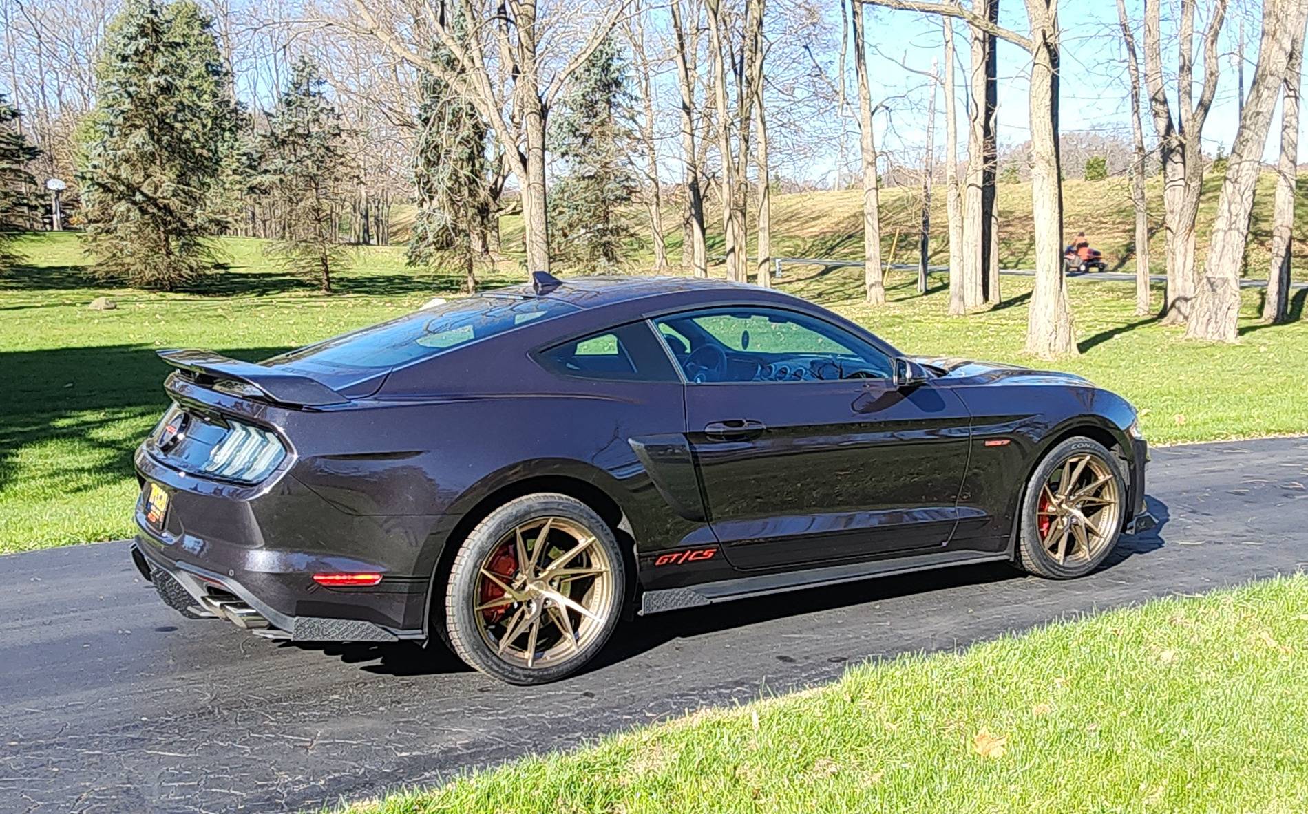

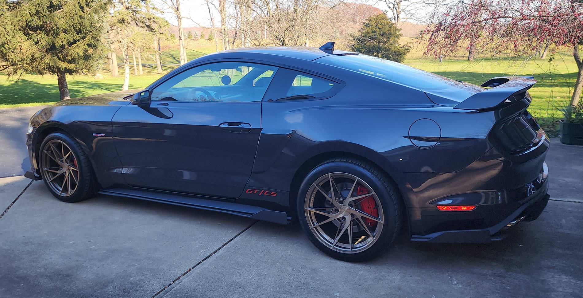

I definitely am, but I’m just terrified of buying everything and then having things go badly. My buddy didn’t do enough research and it turned into a bit of a mess.
275/35 (+30) square with Conti DWS06 on stock suspension.
aarongold2004
Feb 5, 2024
Tennessee
Aaron
2017 Mustang GT Premium PP1
Ok awesome. I appreciate it man. Would love to see a sharper angle to get a better sense of how flush the wheels are sitting with the fender if you have a moment to do that at some point
