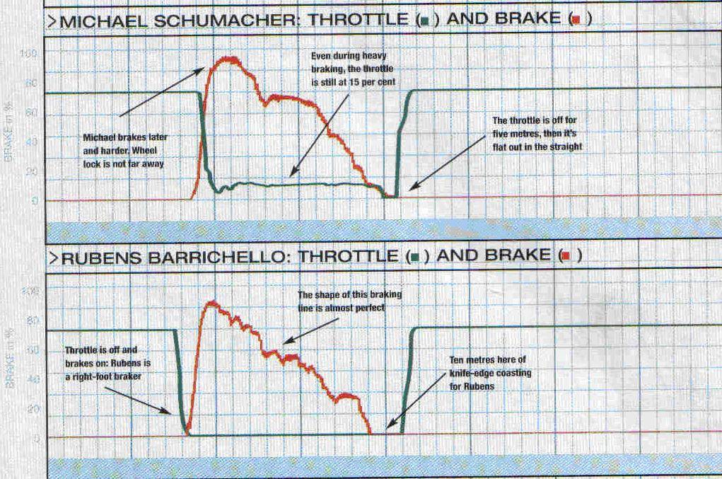

Here is the brake and throttle trace for a couple decent drivers (Schumacher is a left-foot braker; your throttle will be at 0 while on the brakes). Note these guys brake all the way to the apex; you will not be doing that (get the braking done in a straight line before turn-in, for the most part). Also note the throttle application is smooth but fast - don't want to slam the gas down while rear tires are still working for corner grip.

Good god, that Schumacher graph is beautiful. that's some serious smooth brake application for left foot, manual brakes....and all done in 1-2 seconds. Crazy!
I've tried similar things with "family-fun"-level go-karts (for others: because it takes so long for them to get into the RPM power-band again, that it's faster to keep on the gas while braking, rather than release the gas, brake, then push on the gas and wait a long time for the RPM to build up again), but in Schumacher's graph, he completely lets go of the throttle for a split second at the end, so he has to accelerate from no throttle in the end anyway.
What is the benefit of keeping his right foot on the gas in this case? Looks like his right foot keeps pressing the gas a little bit the whole way while breaking, then completely lets go of the gas for a split second before flooring it.

I've tried similar things with "family-fun" go-karts (for others: because it takes so long for them to get into the RPM power-band again, that it's faster to keep on the gas while braking, rather than release the gas, brake, then push on the gas and wait a long time for the RPM to build up again), but in Schumacher's graph, he completely lets go of the throttle for a split second at the end, so he has to accelerate from no throttle in the end anyway.
What is the benefit of keeping his right foot on the gas in this case? Looks like his right foot keeps pressing the gas a little bit the whole way while breaking, then completely lets it go of the gas for a split second before flooring it.
Well, youd have to ask Michael but, you can steer with the throttle as well as accelerate. Unloading and loading weight on the front or rear of the vehicle
My guess is to keep the car settled under braking (could be a slight turn vs. straight line braking since it is an F1 car) and then lets off for a split second to get a bit more rotation mid corner.
