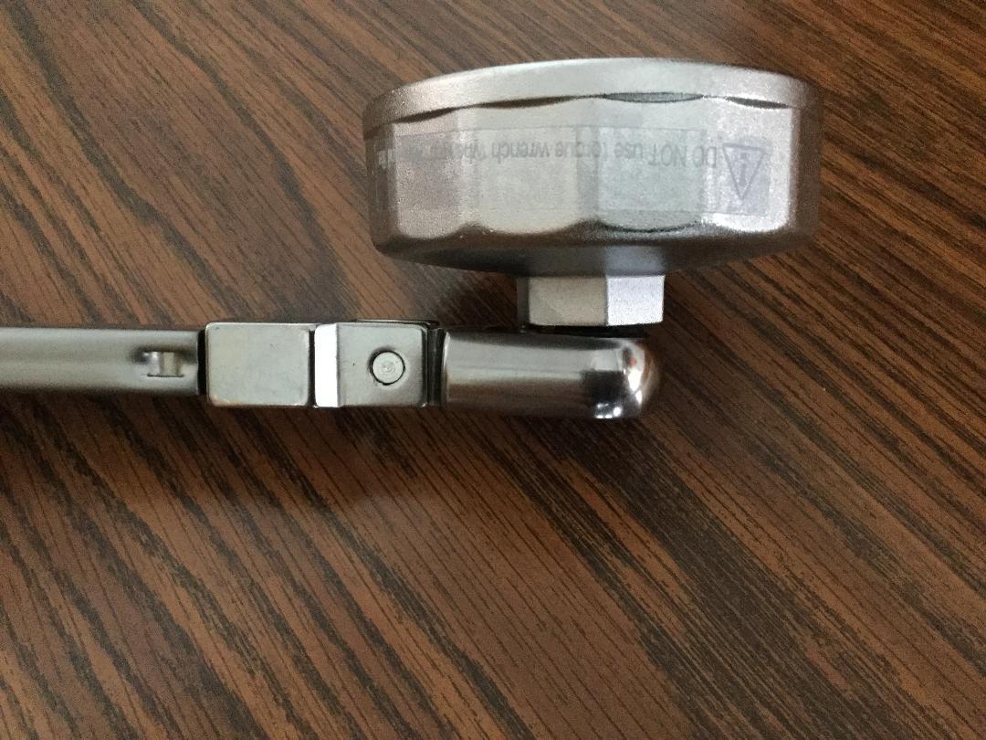

I don't know what drive hole you're talking about in the filter wrench. Is this not the same wrench you received in your Ford Supplement?
My god what was Ford thinking about in designing this filter wrench?:rant: Whats the point of the hex on it anyway when you can just put a square hole for a torque wrench in it??? Much better off using the one talked about in another thread on here. I got it and it worked fine...think it might be for a BMW :thumbsup: Just another piece to be sold with the car whenever that happens.
This is probably what they were thinking about:
My AST M0219 from 2006 has a 3/8" drive and my AST M0219 from Ford in 2017 doesn't.

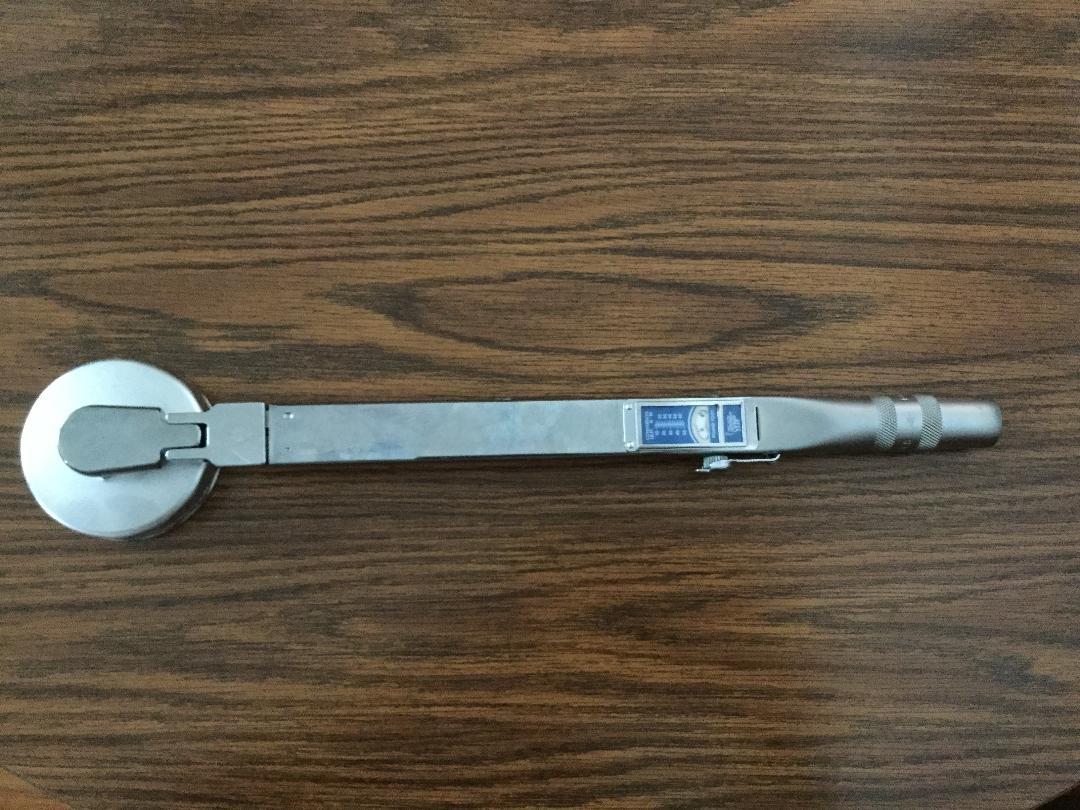

Got under there and checked the oil filter torque this afternoon with the Amazon filter socket and 3/8 inch torque wrench. Plenty of room with a 3/8 inch wrench and the after market socket with a 3/8 inch drive in it. The torque wrench clicked over at 18 ft-lbs and then I felt the filter slightly move right after - so I must have managed to get it real close with my box end wrench on the Ford socket. So, good to go.

I'm an engineer too and been changing my own oil since the 60s, rebuilt/restored a couple of old muscle cars including all body work and paint, most mechanical work, R&R and rebuilt a Torqueflite and Muncie transmissions just this year - never pay anyone to do anything I can do myself. So this isn't exactly a new rodeo for me.
Maybe I didn't articulate my rant to well in my original post but when I received this nice oil filter socket in a fancy box from Ford along with instructions to use it tighten the filter to 16-18 lbs-ft torque - I actually expected there was some way to do that with the nice pretty, cobra engraved filter socket.
I would be curious if a single owner can tell me they managed to change their filter with that Ford supplied filter socket and a torque wrench without removing the entire front belly pan? Anyone? And if so - how? I would really have appreciated it.
My new Amazon filter socket and a 3/8 inch torque wrench (never had a need for a 3/8 inch one before) are due too arrive tomorrow although I've tightened and torqued enough fasteners to feel it's on there pretty close to spec.
I had no problem with the factory supplied oil filter adapter and my torque wrench, did it on a lift, no belly pan removal. I might have gone in from under the fender though not the trap door, I honestly forget. But if it had been a PITA, I'm sure I'd remember how I did it.
Edit: It's coming back to me, I think I put the Ford thing on from under the fender, then put my torque wrench with the correct size socket on it through the trap door. See attached for why I'm not too concerned about the correct torque anymore, even though I did do it "right". And, is being an engineer a pre requisite for owning this car? lol.
Well, that's no 1 for the Ford socket.
No, being an engineer isn't a pre-requisite for owning the car - I guess we just tended to agree the Ford socket is sort of a crappy design if they are so serious about achieving a precise torque figure. :)
I wonder if any Ford mechanics actually use the thing?
