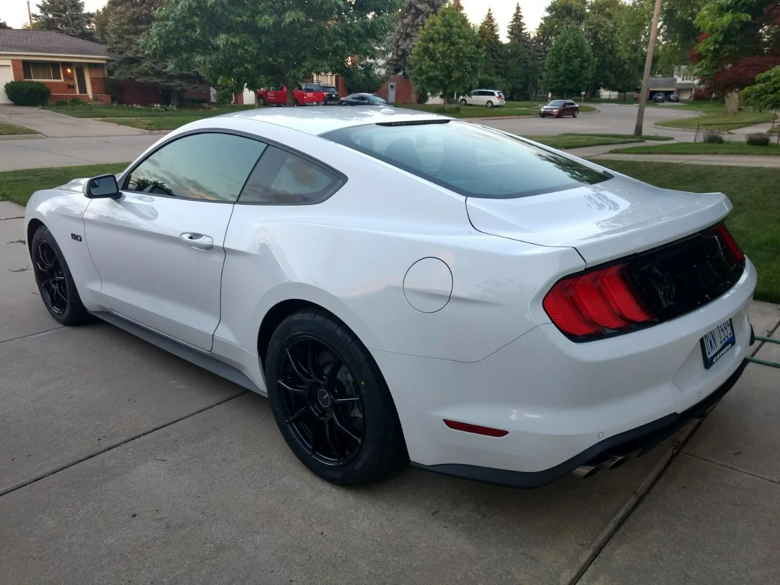

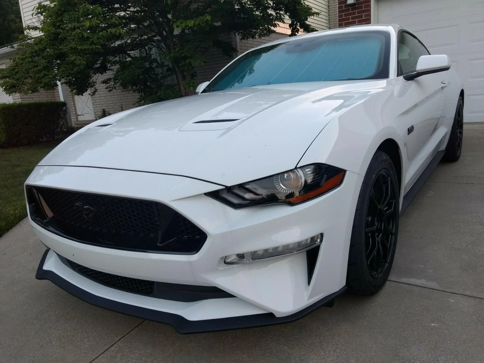

Today I mounted my new, lightweight, Enkei TS-9's and Firehawk Indy 500's on my car - I like these a lot - especially for the $$.
Because I'm building my car up as a touring/street car and because of the crappy metro-Detroit area roadways, I decided that I didn't want a 40 or lower series tire. (I've bent rims on 50's around here before.) So I went with a squared 255/45x18.
Wheels are 18x8.5. Also because of the crappy roads, I decided more spokes would be less susceptible to bending so these Enkei's have 9-spokes.
Wheels and tires came mounted and balanced with TPMS sensors from Tire Rack because they had everything in stock.
I knew I was going to shave some weight off and I'm pretty pleased with the results. My stock 18x8 Foundry's with 235/50x18 P-Zero Nero's weighed in at 57.6 lbs each and the Enkei's/Firestone's are 51.2 each. That's a nearly 6 1/2 pound savings per corner.

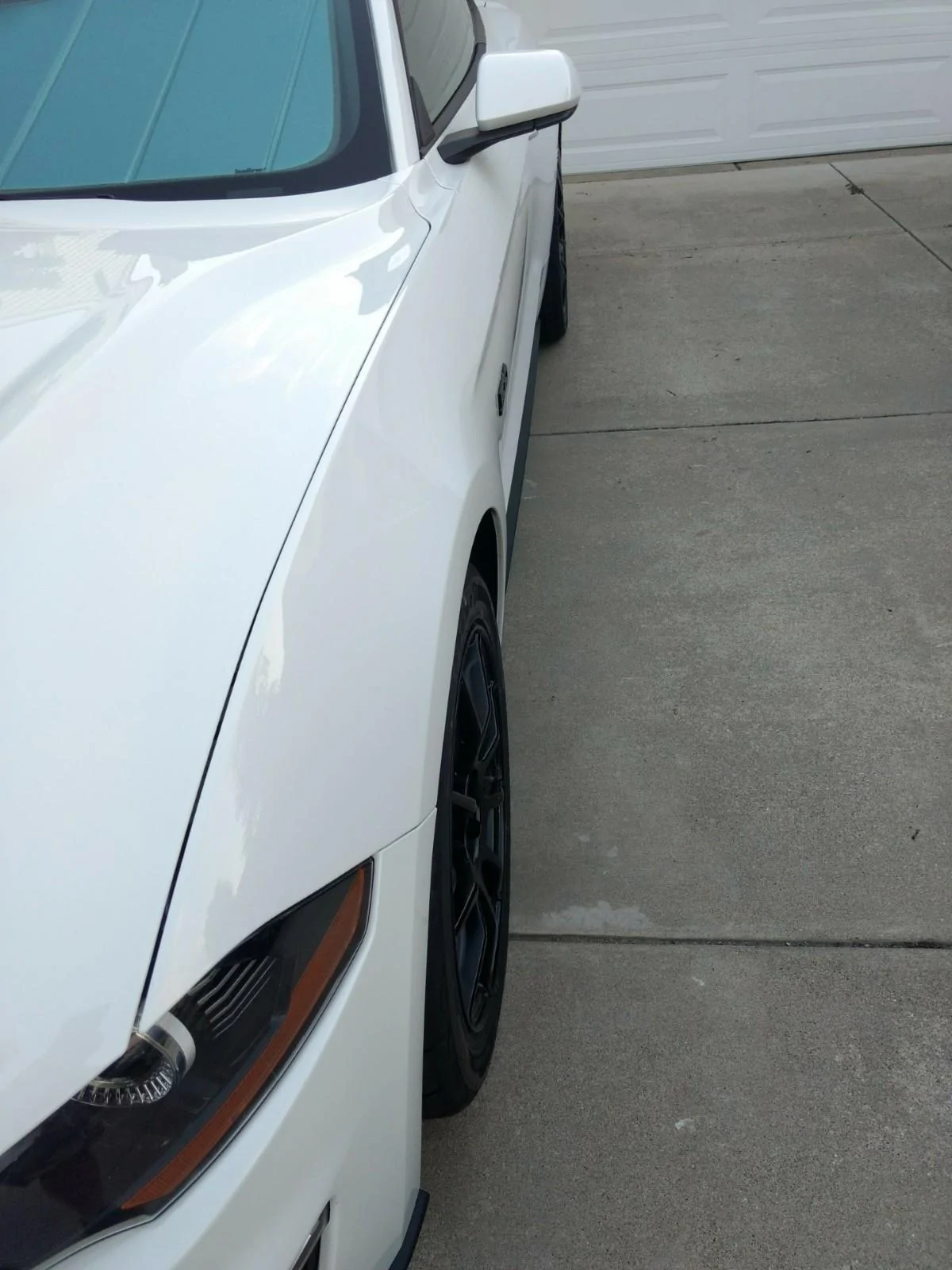

My only concern with these is that there is no tire shoulder bulge to help protect the rims and the spokes on these do stick out maybe 1/4" to 3/8" more than the rim barrel so any curb touches will definitely damage the rims. Fortunately, I don't need to parallel park very often.
I put about 10 miles on them tonight and they're quiet! And another bonus, although at this point I'm not sure why, is that the bump steer I was experiencing with the stockers seems to have vanished. I'll pay more attention to this tomorrow in case I'm imagining it.
