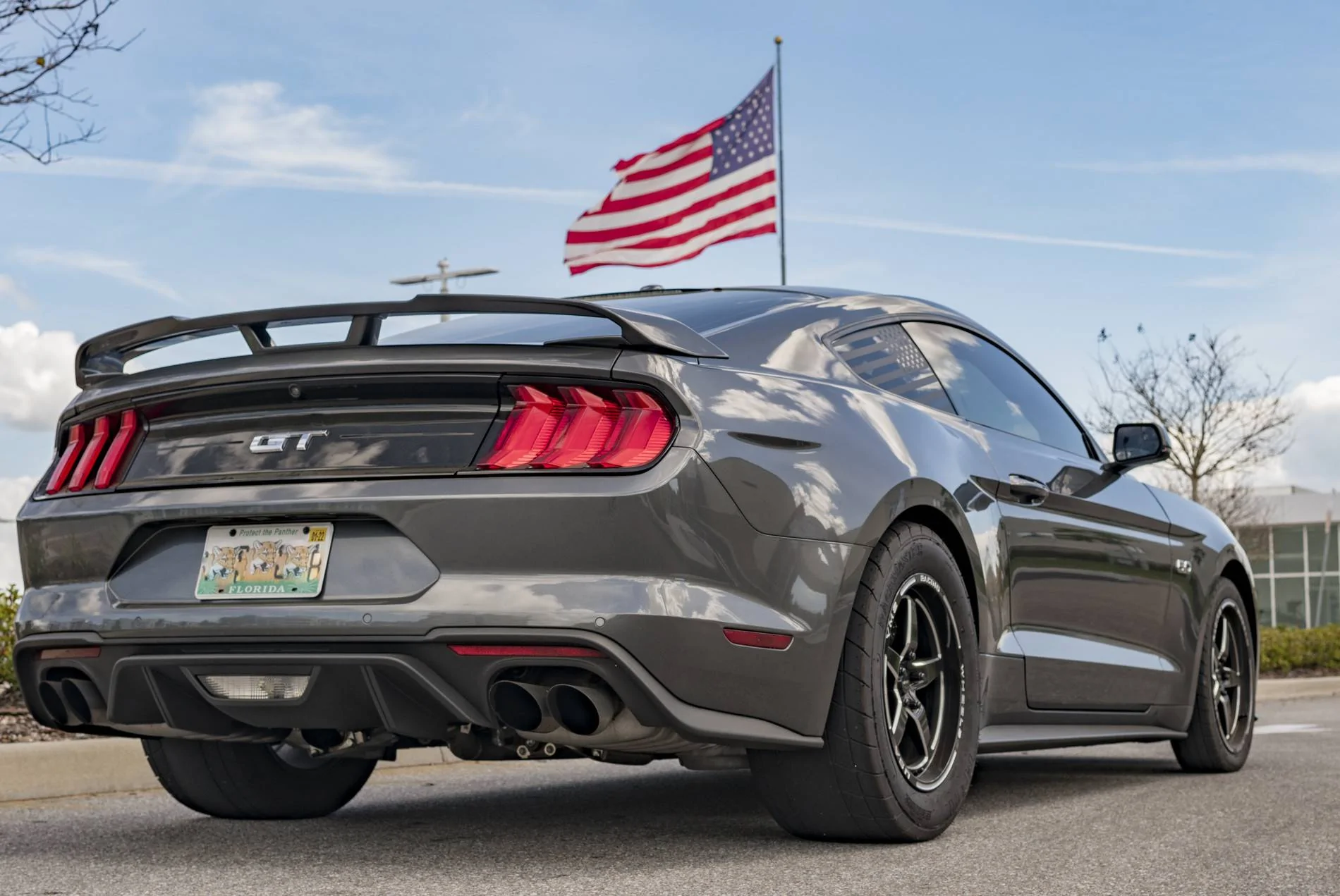

I ran 285/35R19 with the Indys on a 9.5" wheel. That's the most I would do, even on 10" wheel. Putting a 305 or 325 on a 10" wheel is outside of what I'd call acceptable, even if the Indys run a little on the small side. 325 on an 11" wheel would be okay, 315 maybe perfect if Firestone made one. Personally I put safety and performance ahead of what the tire looks like. But if you can have the right look and the right fit then I guess it's a win-win.
Edit: And actually my new tires - BFGoodrich Sport Comp 2 AS I got 255/40R19 for that same 9.5" wheel. It not only looks great, but feels great too. Sure, I could have gone wider but this seems pretty perfect for a DD.
