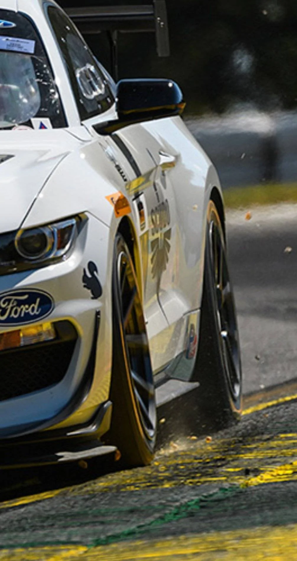

Holy man No, it's not. Go look at a GT4 Mustang one of these days. Same amount. Guess there's wrong too?
Come again? I have seen them up close and personal in Kohr's shop. They have to use a spec tire and wheel size, so bad example. You're just not correct. A low profile tire should be supported by a properly wide rim. The Michelins on the GT350 and R have rim protection, which makes them look a lot wider than the actual sidewall is.

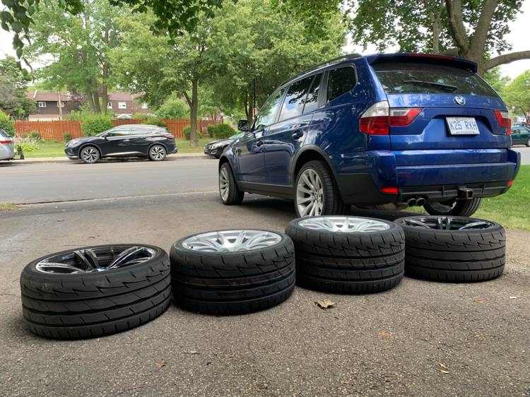

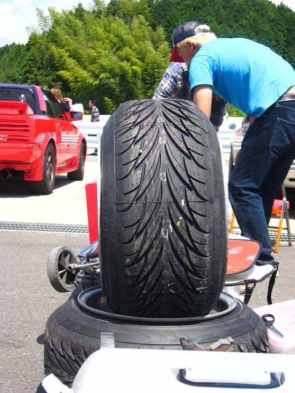

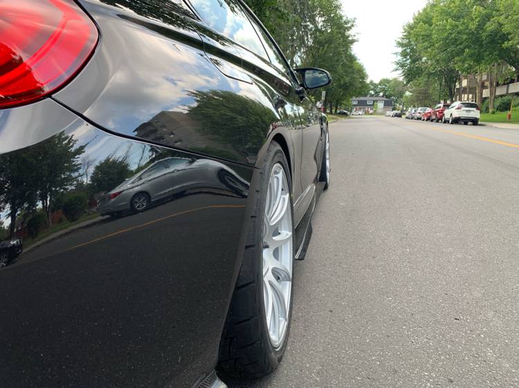

Here are some pics of an indy 500 on an 11" rim. Beside the 325 are indy 500 285s on a 10"
