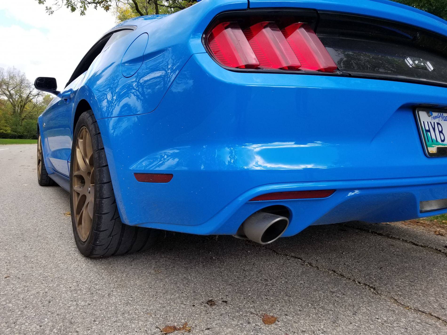

325 indy 500 tire on a 19x11 would be good fit?
Well here's my 325/30R19 on a 19x10. Very little sidewall bulge. But I like it.. saves on the curb rash haha. Anyways zeros complaints from me!

hard to believe. I figured it would look a LOT worse than that - like my pickup tires.
Believe it. Those are just 19x10 AMR rims.
Not at all true, but if you like it, that's all that matters.
Yes sir. For me, a 275/60 on a 15x8 has a lot of bulge (like I had on my old 71 roadrunner). This has very little. around a 1/2 " per side. I don't subscribe to the lets suck the tread to within the rim width philosophy, As I track the car maybe once a year, and our roads are not race track smooth. Speaking of street, these things are like they're on rails! Thank you Firestone!
You may not subscribe to it, but it is faster and handles better (and prolongs tire life). Bulging the sidewall isn't going to make it ride better. More sidewall height does that :wink:.
