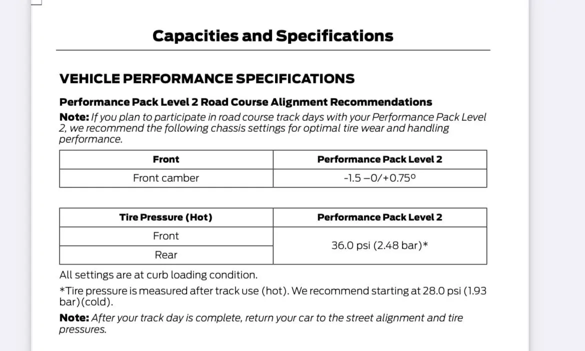

Hey guys, who has the factory alignment specs for the PP2? I’m lowering my car and want to get it as close as possible. Are the PP2 and PP1 alignment specs the same? I can’t find the spec’s anywhere.
The only thing I can find is the track setup alignment specs in the manual that comes with the car.

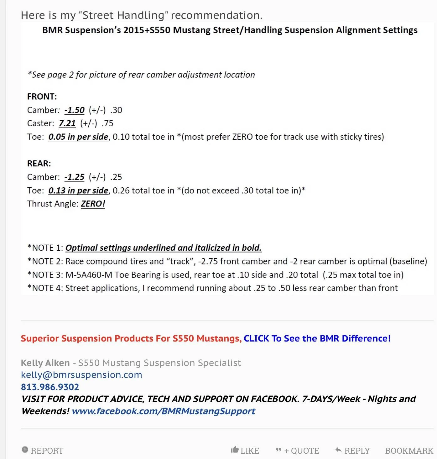

This should be good, but aim for 0.1 to 0.15 total toe.
BMR suggested settings for street use:

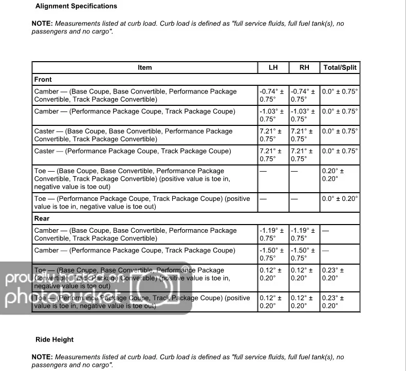

As sourced from my 2020 Mustang Factory CD Service Manual......
you sir are a saint! Thank you so so much. Confirmed my suspicions that the PP2 is a bit different. Thank you again!
