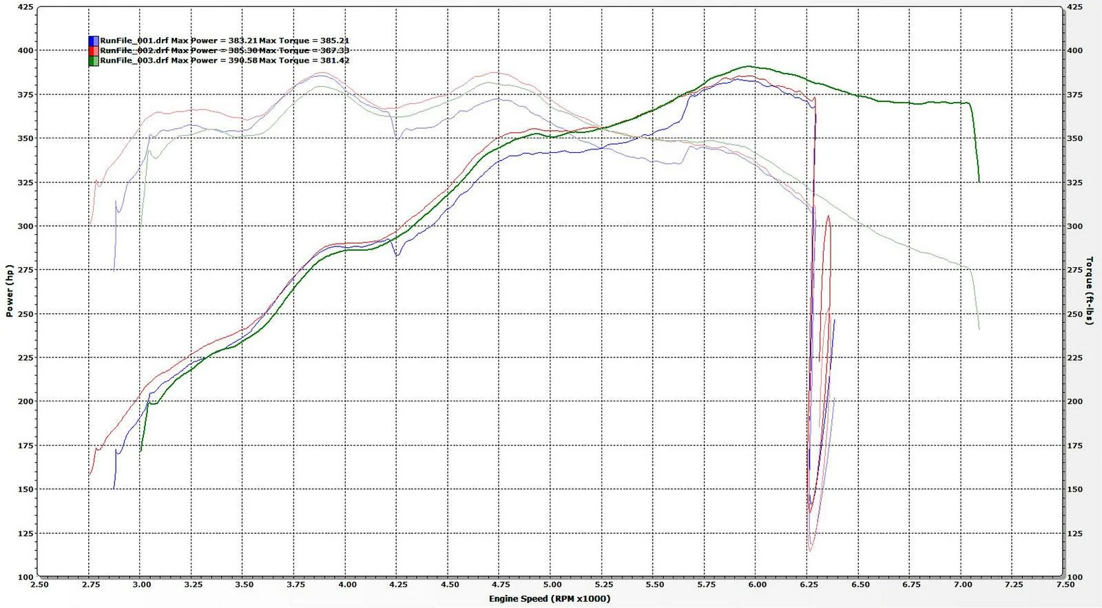

Yeah, it only made 390 HP, but it made a surprising 387 FT-LB. I'll post the dyno graphs in a bit.

The first two pulls were done in 5th gear, one of which had some issues. The dyno started flaking out at 180MPH on both pulls. The final pull was in 4th, but it didn't make much difference in HP or TQ. It looks like the truck manifold still makes descent power out to 7K though.

So about a 17 hp loss after 6 k. That 3500 rpm TQ kick is what I sense as well. Wonder if a tune could flatten out that 4250 TQ valley.
Not sure, but I suspect it's a characteristic of the manifold. All the dyno graphs I've seen of the truck manifold show the same dip.
