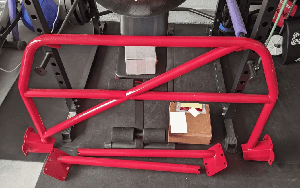

Who's Trent/Crick? Is that CMS? That's the only other roll bar for our cars that I know of.
Very Cool, I have the same one. I'm sure you know what your doing. here's a vid of my install if yu want some reference.
Trent and Crick are a fabricator/race mechanic team that are very well known in the mustang world. Their shops are next to each other at Sonoma Raceway and people bring their cars (Not just mustangs) from all over the place to have them serviced there. They've been making some cool roll cage options lately with custom colors, etc.
Trent used to be a race mechanic at AV8, Crick was a drift car builder before they both went independent.
I found a video by LMR. Seems pretty straight forward but nothing is ever as simple as it seems so I appreciate your video link! I will definitely use yours as well.
The install should be fine but I really don't want to deal with putting the interior back in but I want to stay in street class for one last event with SuperGT Cup. After that, it's full gutted interior for NASA TT3

Nice Eric. Drilling the holes is serious business, make sure you have a spare drill bit or two, and an extra dash of patience in your morning coffee. Worth the work though!
