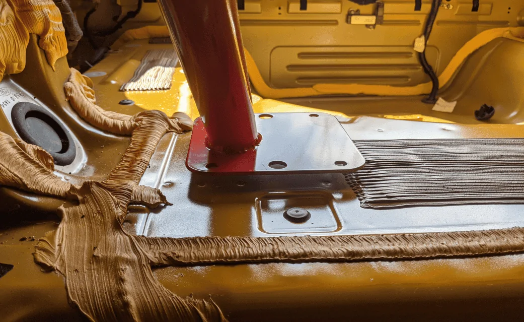

So the roll bar install is very straightforward until you have to line up the trunk legs. I reached out for help to the community and it seems everyone had the same problem. One leg is up off the floor about a quarter inch or so and the other leg is too far forward. Oh and the main hoop sits too high as it doesn't quite fit over the B-pillar brace.

Mine is from CMS so the down-tubes land in a different place than the Watson. If you need to could you clearance the main hoop mounting holes so you can cant the hoop back a couple degrees?

Yep, the main hoop was the issue. I took the bolts out of the main hoop and adjusted the placement of the whole thing and it sits much nicer now. All front bolts thread fine and the legs sit flush on the trunk floor. Can finally wrap this up now. Between work and potty training our new puppy, I don't get much time to spend on the car

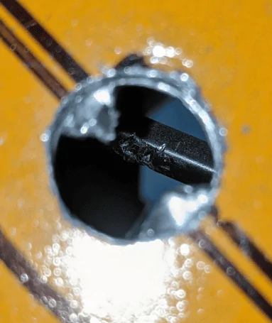

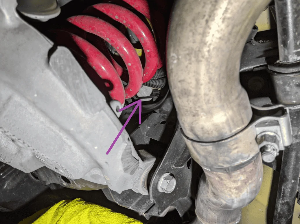

So my worst fear came true....while drilling one of the last holes for the roll bar, the bit grabbed and pulled my drill in and knicked a hard brake line.
Everyone tells me brake lines are an easy fix. After looking into this, replacing the actual line does look easy BUT actually reaching the line is the tedious part.
The purple arrow is pointing at the brake line. Looks like I'd have to take apart the entire rear end to get to the line. :facepalm:
I think I'll let the dealer guys handle this one. First time it'll be back at a dealer since I drove it home the first day

Can't be any worse then dropping the subframe a bit to do a stop the hop kit or alignment bushings?
It's so hard to reach in there and I can't even see the whole thing. I'm imagining lots of disassembling in the process.

Ah that sucks dude! Sorry to hear. I was just looking at replacing an evap line that runs across the chassis in the same area and it requires dropping the whole subframe. Wouldn’t be surprised if this does too. It will prob be a good bit of labor from the dealer. But not difficult if you can get a friend or two over to help lower the subframe. Might save a good bit of money if you bite the bullet and do it yourself.

Yeah I'm sure I could get it done with some friends but I only have two weekends left before my next event and already have family plans. Running short on time.
I met a Ford dealer owner at an event once and got his contact info. I called him last night and he said he'd get me a deal. I'm curious what the quote will be

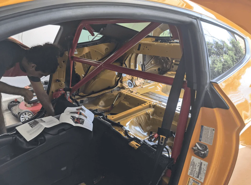

Alright, roll bar finally done and car all buttoned up.
After calling numerous dealers, I found out that factory brake lines are on national backorder, just like everything else. Only four dealers in the nation had one in stock and luckily a dealer in Arizona was able to ship me one. Should be here tomorrow.
I'm liking this gutted interior look and feel. Much easier to access everything without having to first remove paneling. I may just remove all the carpeting once a race seat, HANS, and harness is in the budget.
